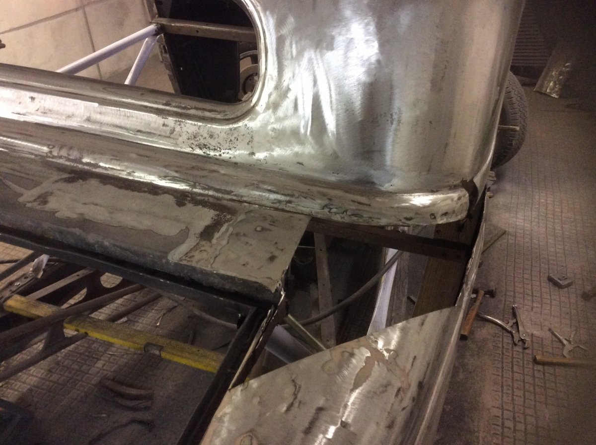

    image.jpg image.jpg image.jpg image.jpg image.jpg image.jpg Made a start on the repairs, starting to look a little better. Decided to chop it too, I took 3" out of the front and 2,1/2 out the rear.

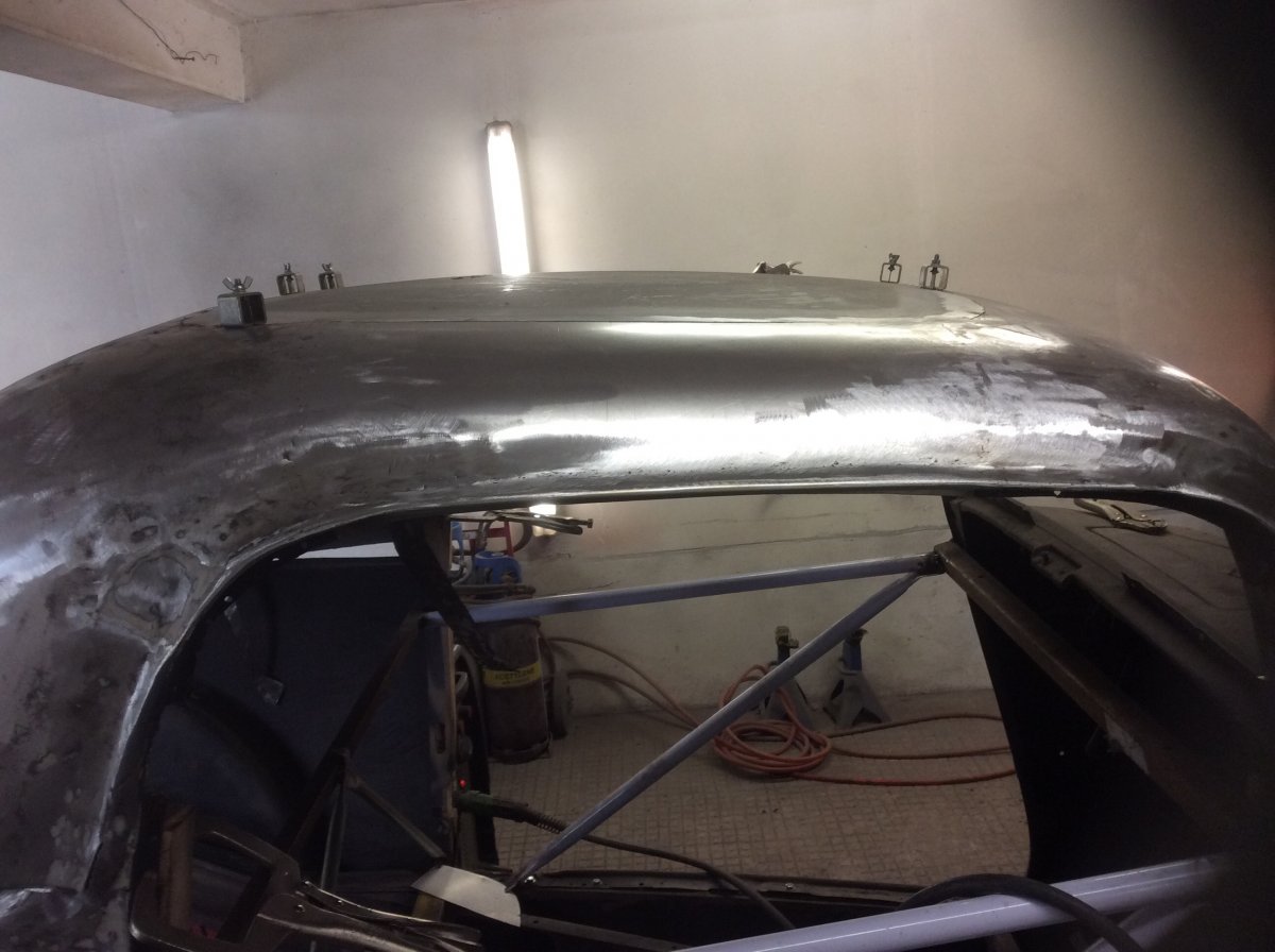

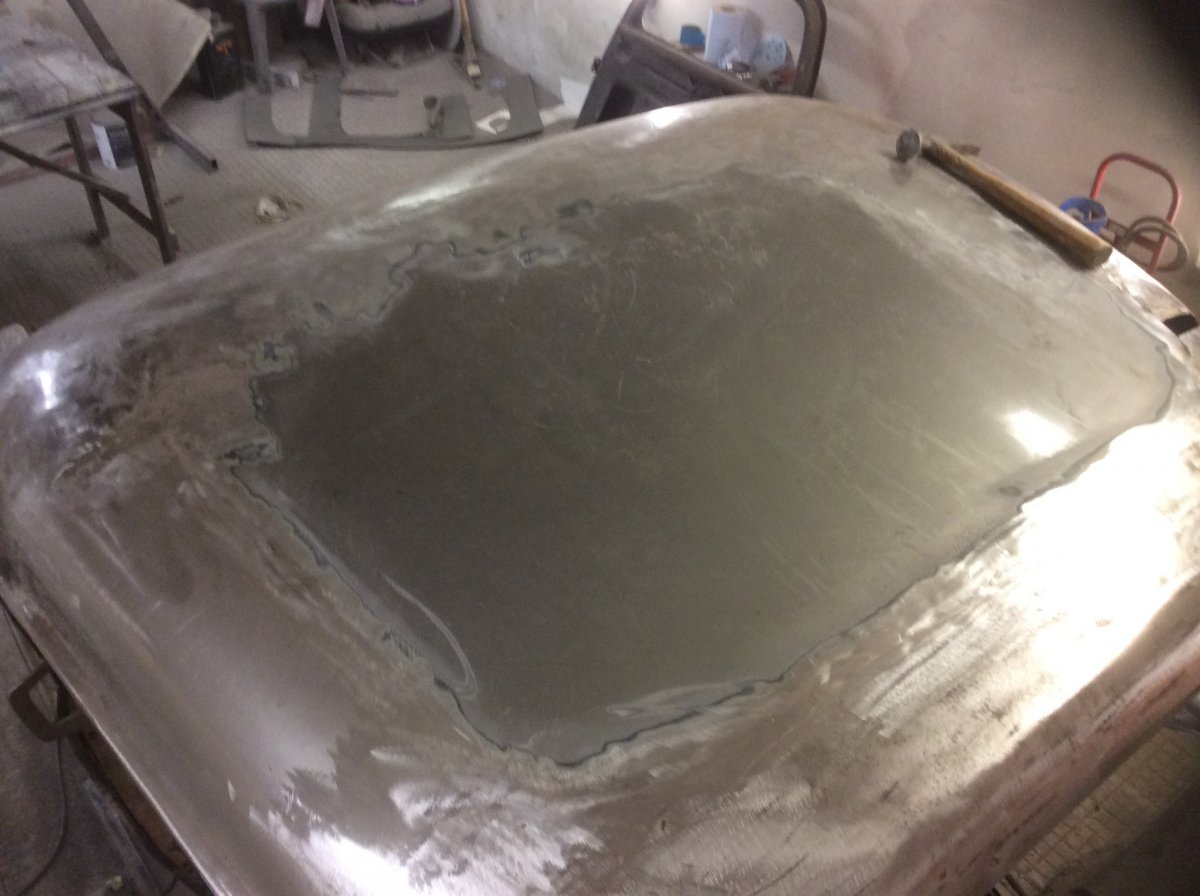

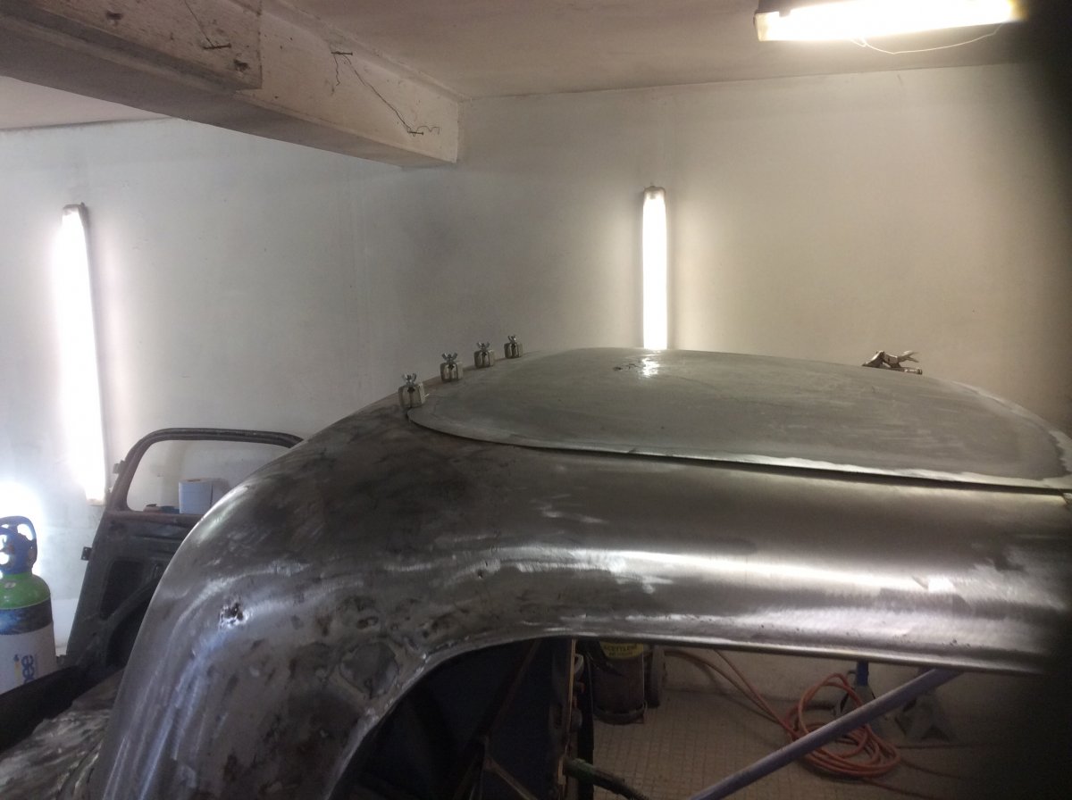

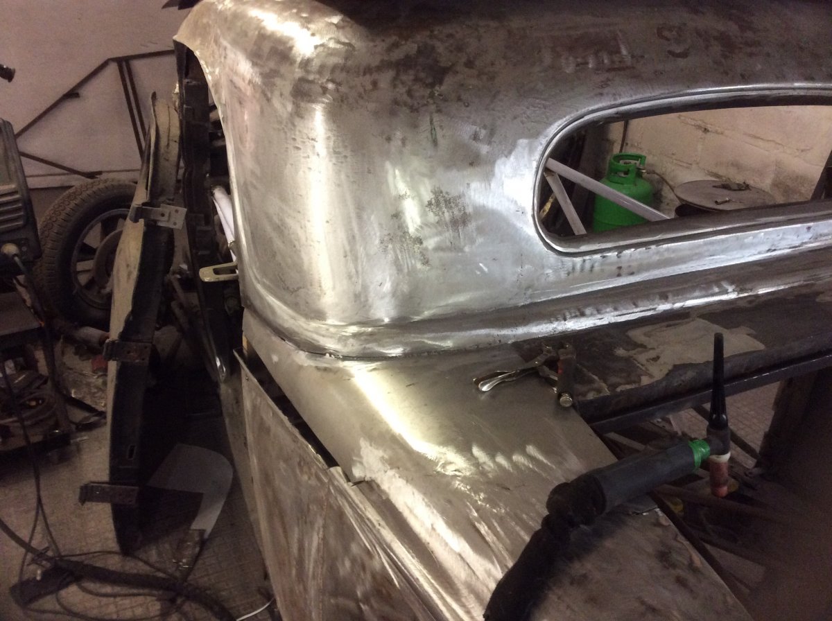

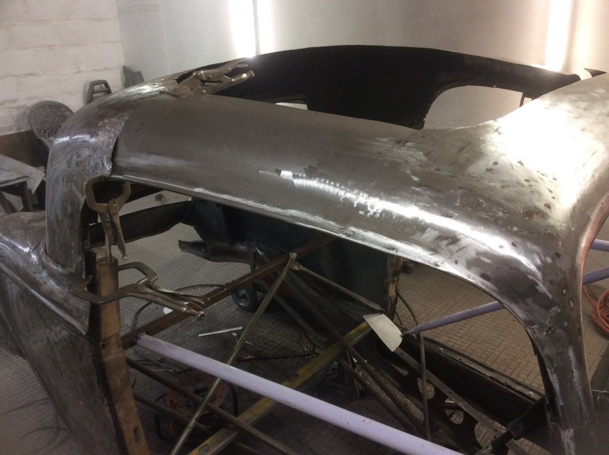

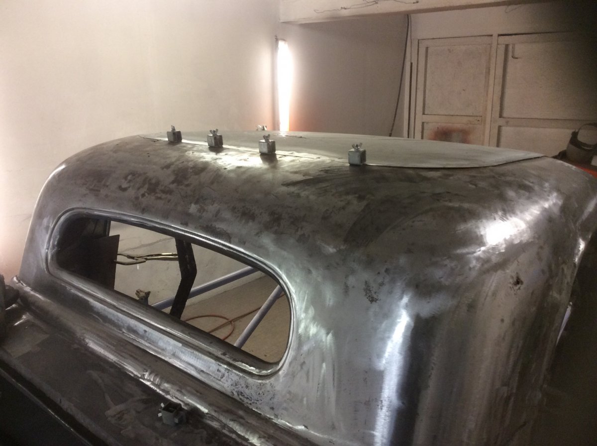

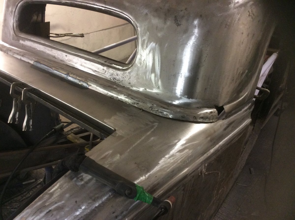

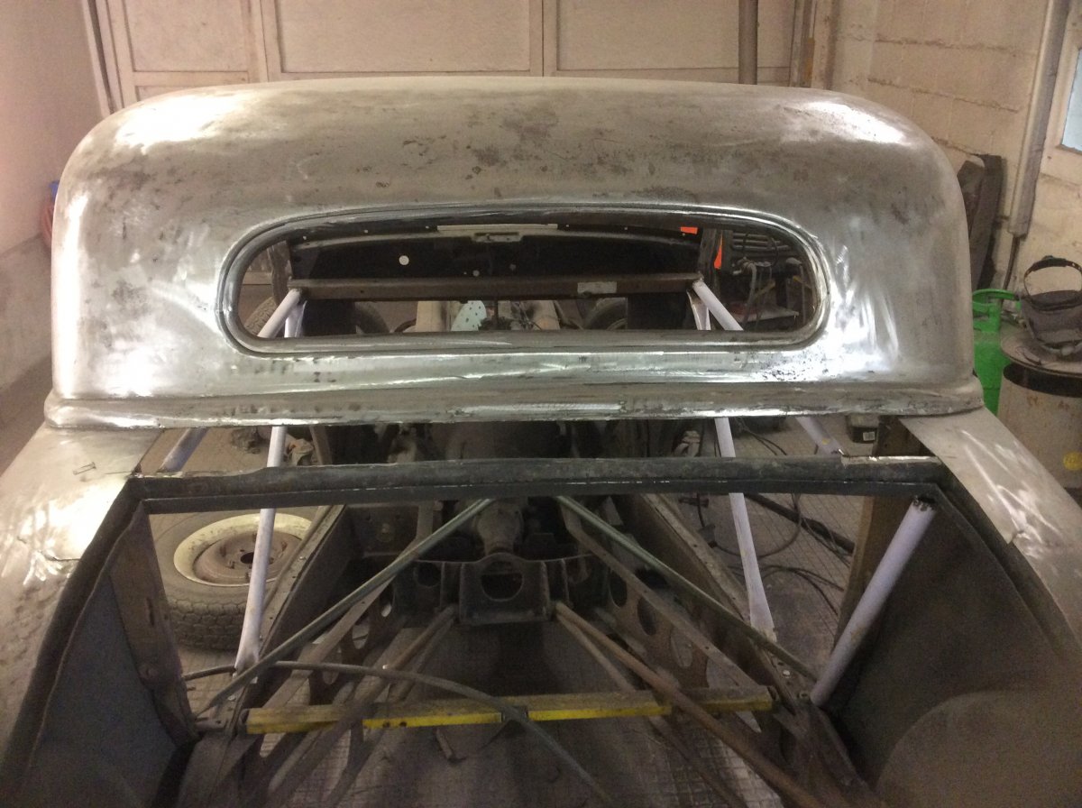

    image.jpg image.jpg image.jpg image.jpg image.jpg image.jpg Cut a section of roof out of a Saab 93 that I had sitting around work out perfect to fill the roof, slow job welding it in, little more work and be good to go.

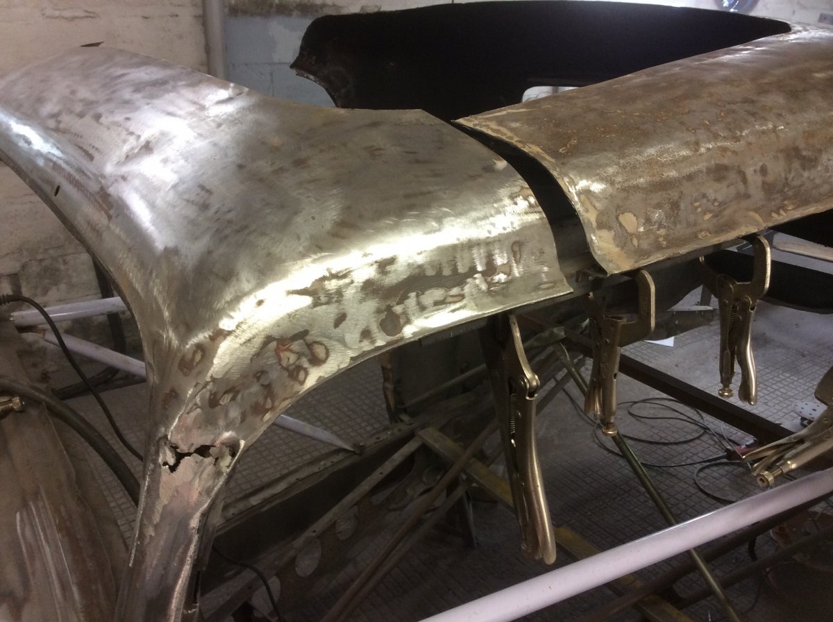

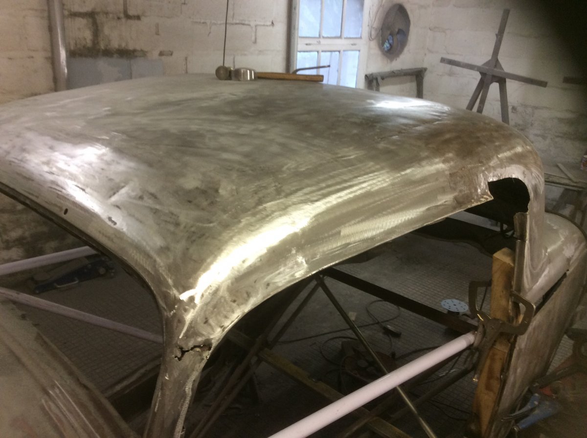

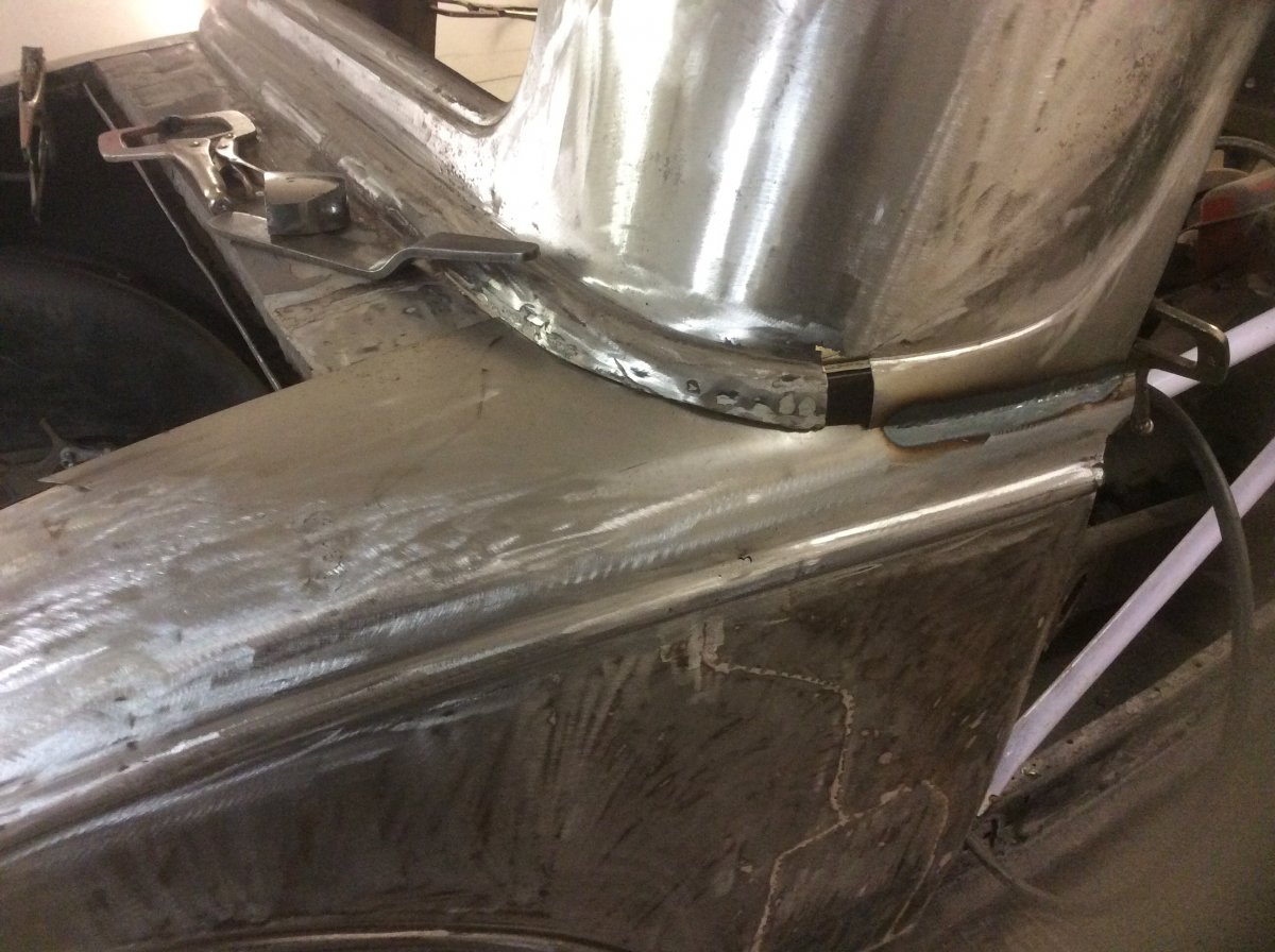

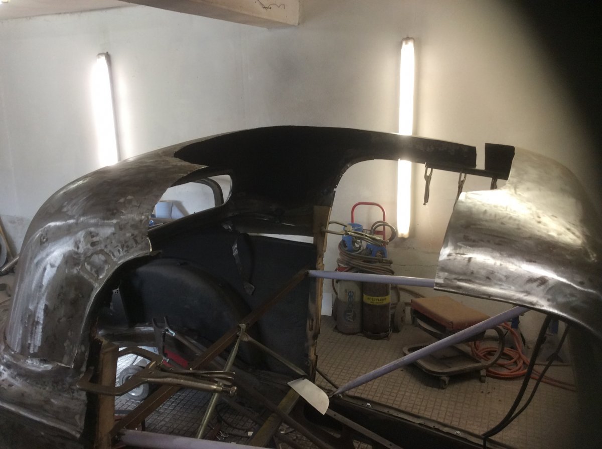

    image.jpg image.jpg image.jpg image.jpg image.jpg image.jpg Working on right side of roof to quarter, also made up new panel between deck lid and roof as it was badly damaged and full of plod.

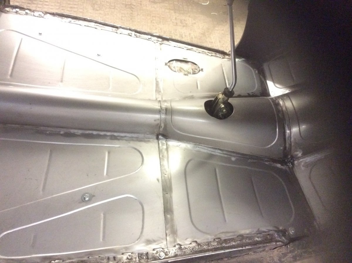

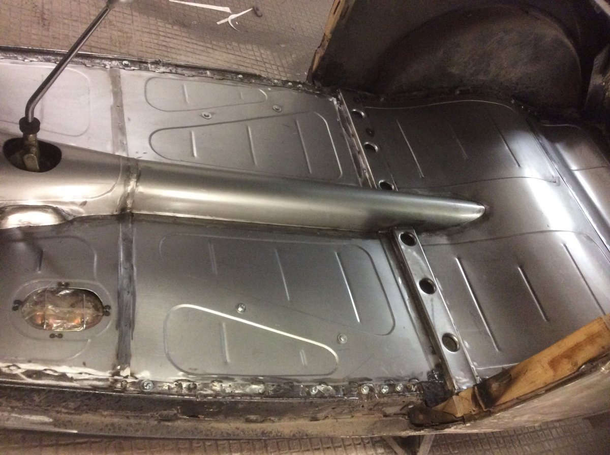

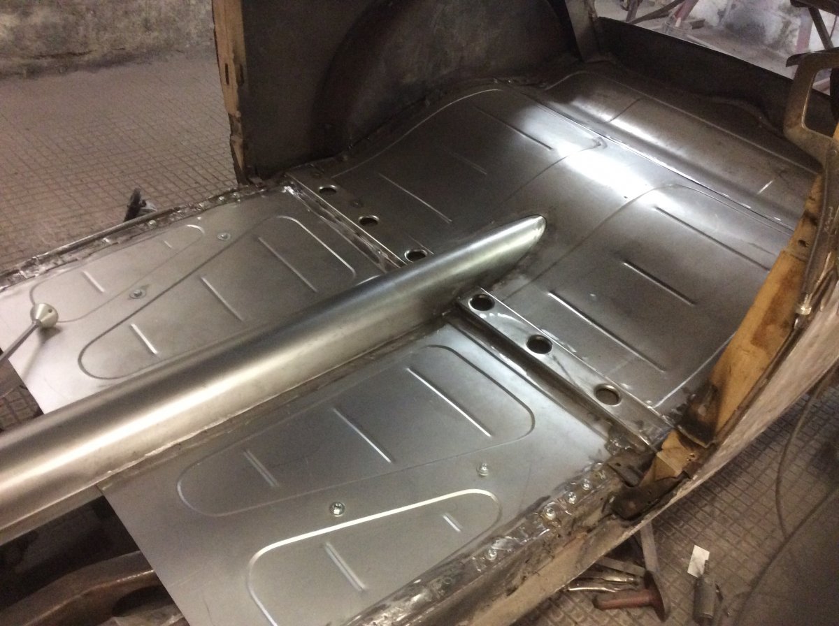

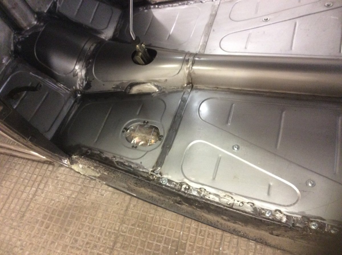

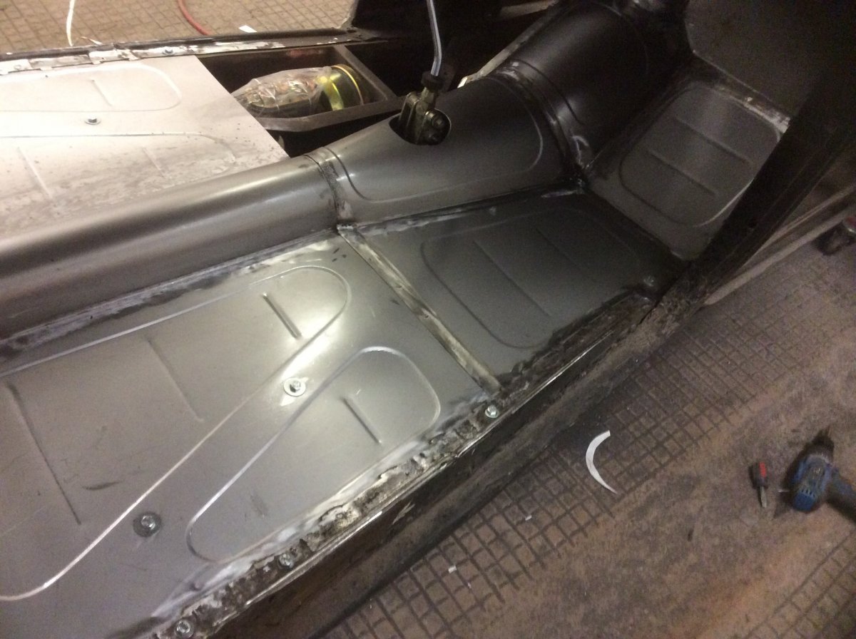

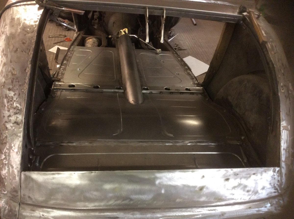

    image.jpg image.jpg image.jpg image.jpg image.jpg image.jpg image.jpg image.jpg image.jpg image.jpg image.jpg image.jpg Had a change from the body repairs and made and welded all the floor panels, trans tunnel and fire wall in as I'm gonna take out the wood from B/posts and replace with metal.
