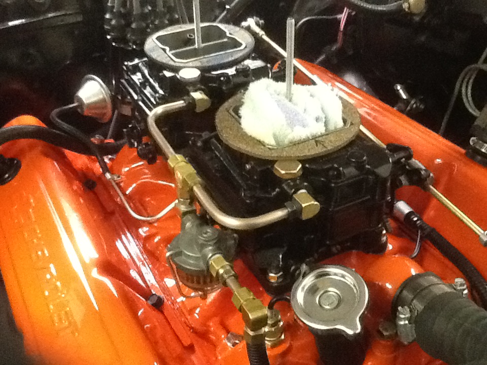

    I removed the chokes from both carbs , I rebuilt both carbs , the carbs are working fine if only one is run on the engine at a time . I have a plate to cover the front carb mounting area so I can run the rear carb alone , it is the primary . I removed a set of 3x2 Rochester and replaced them with these, I had no problems with the trips they had the aftermarket bases on the end carbs .​

    Tri-power front & rear plates seal when closed....maybe the front 4 bbl throttle plate is not sealing off? Just a guess on my part

    Yes that's right ! Now ,you guys are getting what I mean ! They are not sealing , so how do the vette front carbs seal ?they must have different lower base or different ,tighter,beveled ,bigger ,throttle plates they run 2 carbs at the same time? mine are pretty tight to the bore but you can see a little light around them when held to the light.

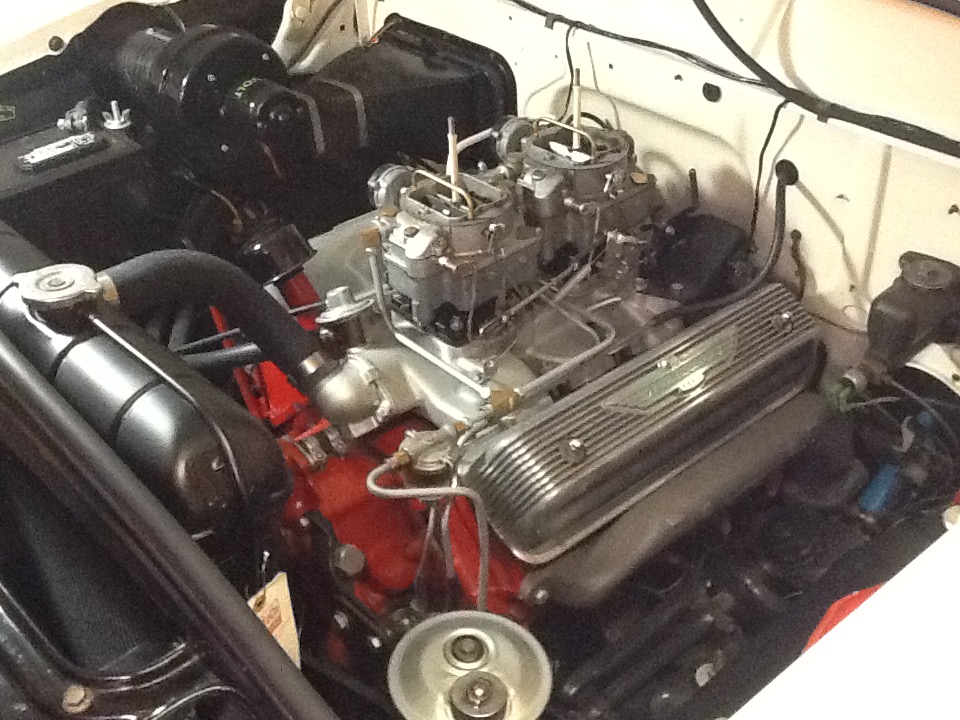

    carbking, member here, has had a few things to say about these WCFB's, especially when used as replacements for true dual four carburetor applications; might send him a PM. Did your carburetors have the choke housing that mounted to the main body, or down low on the throttle body? The throttle body setup IS NOT the one to use when making "clone" carburetors, which is essentially what you're trying to do. I can't tell from your photos, the black paint is hiding things. I personally can't give you the exact reason why that is, and it's information I only recently heard myself. I went with clone carburetors from a vendor for my dual quad setup, the "early 56" Chevrolet 2 X 4 manifold, and unless you look at the "numbers", it's hard to tell they are "fakes"; all the no-used holes are plugged, vent tubes added, etc. My setup is't currently on an engine. My concerns were the secondary "weights" are quite a bit smaller on the dual four applications, but that apparently is't a real concern. My bet goes with carbking having the answer for you.

    The throttle bodies on the genuine dual quad carbs differ from other throttle bodies. And the gaskets used are totally different.
    Before calling:
    (1) Place one of the carbs on top of a Xerox (oh, showing my age again.....copy) machine, and make an exact paper copy of the bottom of the flange. Carefully cut out the air/fuel holes and the mounting holes.
    (2) Place this "template" on the front carburetor "pad" of the manifold to check to see if it seals.
    (3) If it does seal, then visit your FLAPS and acquire some of the black rubberized gasket material 1/32 or so thick, and hand-cut 2 gaskets.
    (4) If it does not seal, you will need an adapter.
    EDIT: Had to do some chores before finishing post.
    What displacement engine do you have this on?
    283 - use progressive linkage
    327 stock - use progressive linkage
    327 w/hot mods - use solid linkage
    350 - use solid linkage
    Glad to see you have been testing. Your tests basically show an incompatibility of the larger throttle body and the front pad. If there are no issues with the intake, then the custom gaskets (or adapter) should solve the issue; and even though the rear carb is not leaking, the second gasket is for the rear. Gasket deterioration might cause it to leak in the future. Do it once, do it right......the mantra of those of us too lazy to do it over ;)
