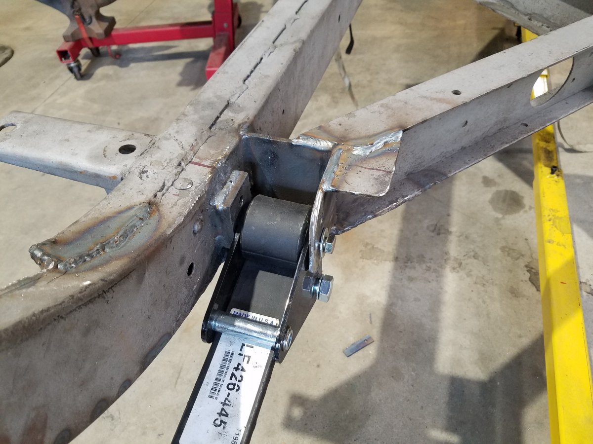

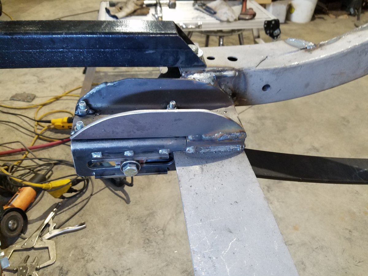

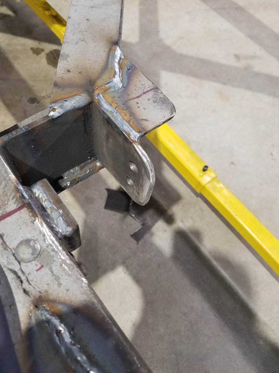

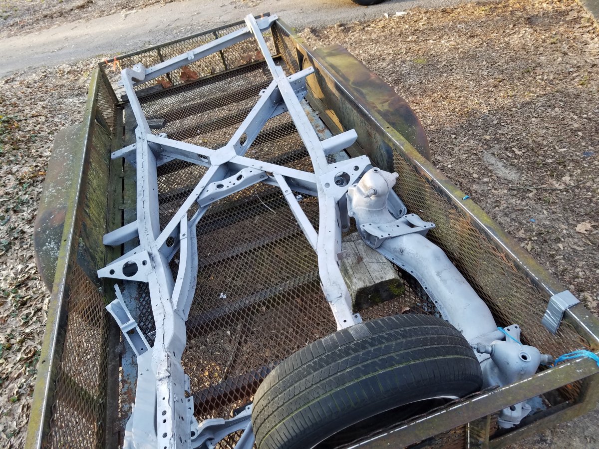

    I had the frame blasted and then started to move the springs inside the frame. I bought Cal_Trac springs and traction bars and sliders. 20190319_074530.jpg 20190406_172522.jpg 20190411_153226.jpg 20190411_152939.jpg

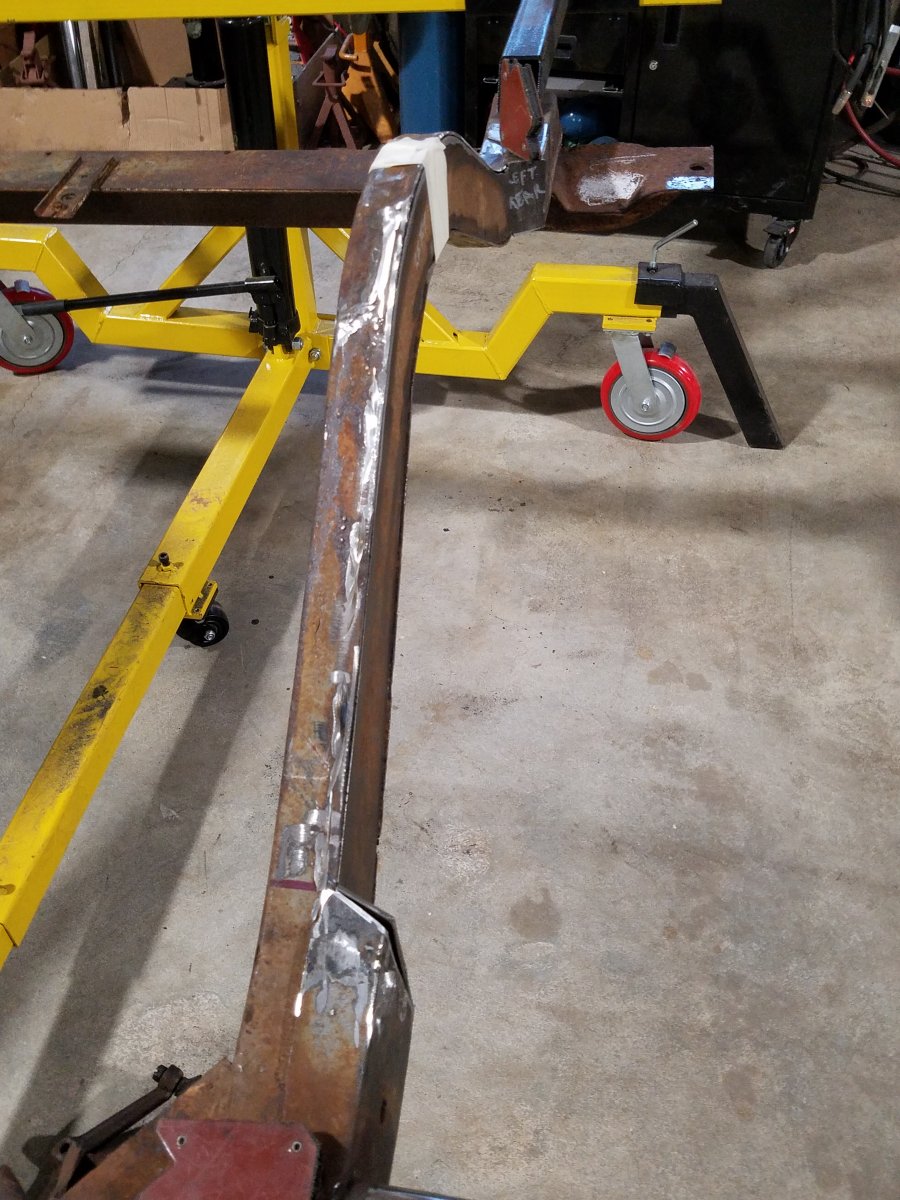

    Next I notched the frame for more tire clearance. I cut it in half and moved the piece I cut off to the inside and welded it up. I said before I had a 57 Pontiac rear end but I sold it and got a 9" Ford. I kinda wish I still had it. I figured the ford would be better.

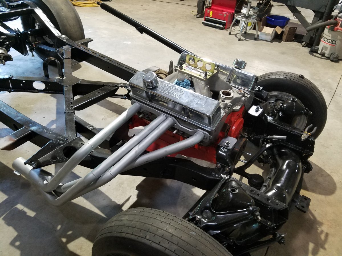

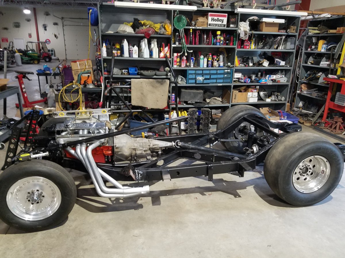

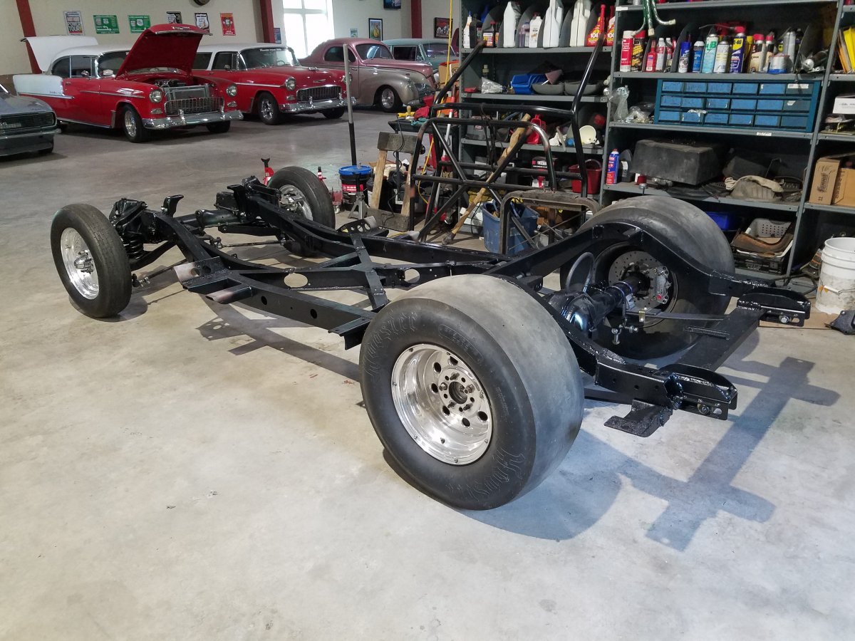

    Got the frame primed and painted and the motor and trans installed

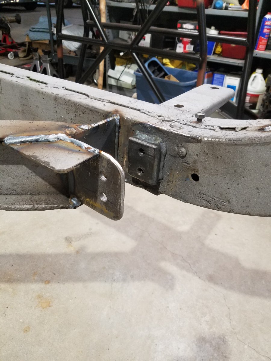

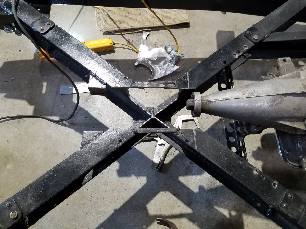

    I made new front engine mounts and notched the X member lowering the motor and trans 2 1/2 inches. That gives me better drive shaft angle. I also cut the X member and welded tabs to bolt it up so it can be removed.

    Stephen glad you are taking us along for your build-all good stuff. Glad to see another solid axle drag car come to life. I am including pictures of my 60 Vette chassis that started life with a small block that ran gas in the 60s to a big block modified production car (although occasionally ran gas) from Alabama.
    They both have sliders and also notice the cut down in the x-frame. Ricky Moore who built the chassis to where it is today, told me the cut down not only helped with the driveshaft angle but also helped with pulling the trans (Doug Nash 5-speed) at the track. Of course the car did not have the four link in the 60s and it had a Pontiac rear at the time but he updated it over the years to the Dana 60 and added the four link. The Pontiac you had may have been cool but I suppose you can argue the Ford 9" will take a bit more punishment (although some may debate that). Vette -12-13 005r.jpg
