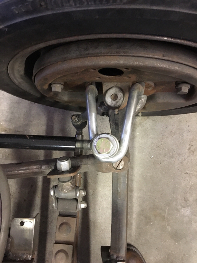

    I purchased a reversed corvair steering box on eBay new. Anyway, installed it with cowl steering on my coupe. The pitman arm on the cowl from center to center on tie rod is about 5 1/2”. The arm coming off brake drum is 4 1/2”. I’ve got about 1 1/2 turns on the steering wheel lock to lock. Seems like it’s way too quick for the street. When I look at all the corvair boxes for sale, looks like all have the same ratio 20:1. Could I have some how gotten a box with a different ratio? The box I bought looks just like every other one I have seen for sale. Thanks in advance, Ed[​IMG]

    I understand the basic principles of leverage based on length . I don’t really think that’s my problem after looking at the length of pitman arms used on existing hot rods I’ve seen. I just disconnected my tie rod and I have about 5 turns lock to lock on my box when it’s not connected. Wondering if this box is 20:1 or something quicker. Like I said I bought it on eBay a while back, and unknowingly bought a quick ratio

    O.K., disconnect your pitman arm and calc the degrees of turn you have on the sector shaft with the 5 turns of the mast shaft. (steering wheel).
    Or simply disconnect the drag link at the pitman arm, marking the sweep (total length of movement) from front to rear. (easiest way to do this is with a plumb bob; string tied thru pitman arm link bore, attached to a pointed weight, above a yardstick on ground running parallel to direction of 'sweep')
    By the way...What kind of spindles do you have? If early Ford, just what kind of steering arm up there is 4-1/2" long????
    I've never even heard jokes that short...

    Not having ever done this before, I copied this after seeing it done on quite a few cowl steering applications. Measures appropriately 4 1/2”.

    That seems short. Maybe try for around 6" from the drum plate to the hole for the drag link bolt.

    Going to take your advice and redo the spring mount, wasn’t very happy with the way it turned out, and like most of the stuff I do on this project, I wind up re doing till it’s as good as I can get it. I found my info from when I bought the steering box on eBay, and it was listed with the same part # as all the other boxes the equipment dealers sell, so I’m pretty sure it’s 20:1 like all the others. Plus I have 5 turns, lock to lock when it’s not connected to anything, and the pitman arm swings real close to 1/4 of a complete revolution. So if I could turn the wheel 20 turns, it would complete a full circle, thus it would be 20:1. Once I redo the spring set up, I intend to extend the arm on the front wheel, and that should slow it down to where it’s streetable. Thanks to all for input.

    You also want to put a jam nut on that Heim Joint where it's threaded into the steering link or it will soon be wobbled out and stripped.

    I like that 'wrap' bracket perching the spring shackle. This is a critical spot that sees failure from lesser 'well planned methods...'
    As SheepDip pointed out, any time a long threaded shank is used at the end of a link, put a jamb nut on! It keeps constant tension on threads otherwise destined to compress-and-pull, over and over.
