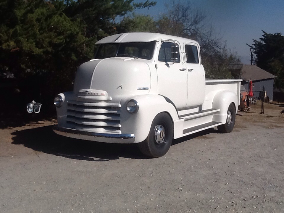

  2. Mine. Extended 12" Used 2 extra cabs and a couple doors...

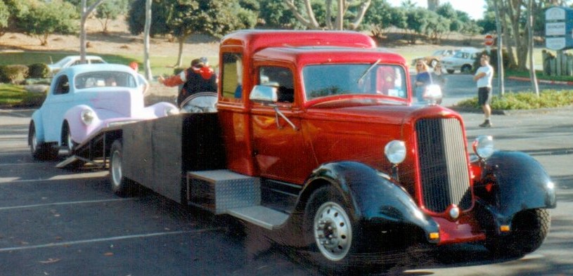

    Although rare and hard to find, there were some 4 door double cabs made for big outfits like the Railroads. I don't know if they were done by coach builders or if they were factory. I know you asked about extended cabs, but thought I'd throw that out there in case you didn't know they existed.
  4. RMR&C, yours definitely looks right and BamaMav yes I've seen some of the old railroad trucks. I know there were several companies back then putting together 3 & 4 door crew cabs but since they were strictly for industry the styling was for the most part kind of rough. It seems like they just started with a long bed pickup and force-fed an extension into the area between the cab and the bed with not very good aesthetic results.

    I'll say RMR&C's example above is one of the best I've ever seen, proportionally. I generally dislike the ones that were extended enough to have a back seat in them, although I can understand the desire to do that.
    I think the hugeness of the half-cabover body style helps too. Proportions on a regular pickup get wonky real quick but a big truck can carry that extra size more easily.

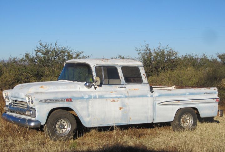

    This one came out ok, I think. Not the year/make you're looking for, though. It was built using 24" of Suburban quarter panel, stuck in between the cab and cab back. Didn't take long to build it, either.
  8. That 58/59 Chevy is sharp! I agree about the crew cabs. I don't think you can get away with stretching these old trucks long enough to build a crew cab without ruining the proportions.
  9. The build thread on that 59 Chevy is a perfect example of why I was thinking of maybe a panel truck donor. I think any early Suburban today is going to be to much $$$ to cut up unless you could find something that was hit hard in the rear. Thanks for posting the link.

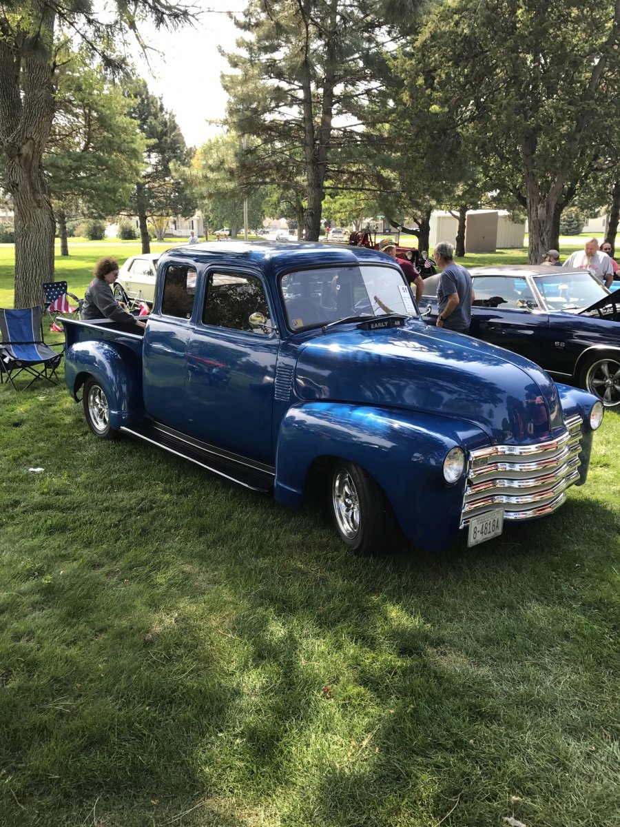

    This is a friend of mines 48 Chevy extended cab pickup. I don’t have any construction pictures, but he used 4 doors to make the extension, cut them to the size he wanted and welded them together, then welded then onto the body. D0E46923-D1D6-436C-A969-437290E5A23C.jpeg

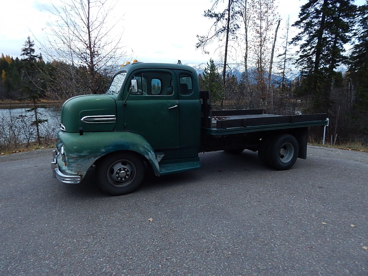

  21. Thanks! I am 6'4" tall and the extra legroom is really nice. But I extended the cab just because I always wanted to try it. I have seen some really bad attempts, was hoping to make it look more like a factory deal. Amazing how many people think it is!

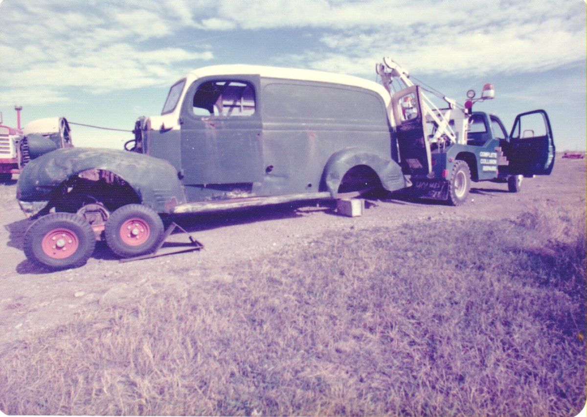

    The extended cab came out on Dodge trucks in 1975 if you are HAMB fussy. In any case, my objection has to do with the styling - specifically the curve at the back of the door tops on pickups. Here is a picture of a Fargo panel truck I picked up ages ago. Notice the square corner at the top of the door. In my opinion, you should do this along with extending the drip rail straight back over your new quarter window for it to look right. The factories back then went to the trouble to do this on limited production panel trucks. They didn't have to but it sure makes a difference, not like what Volvo did on their station wagons. Scan-200206-0001.jpg
