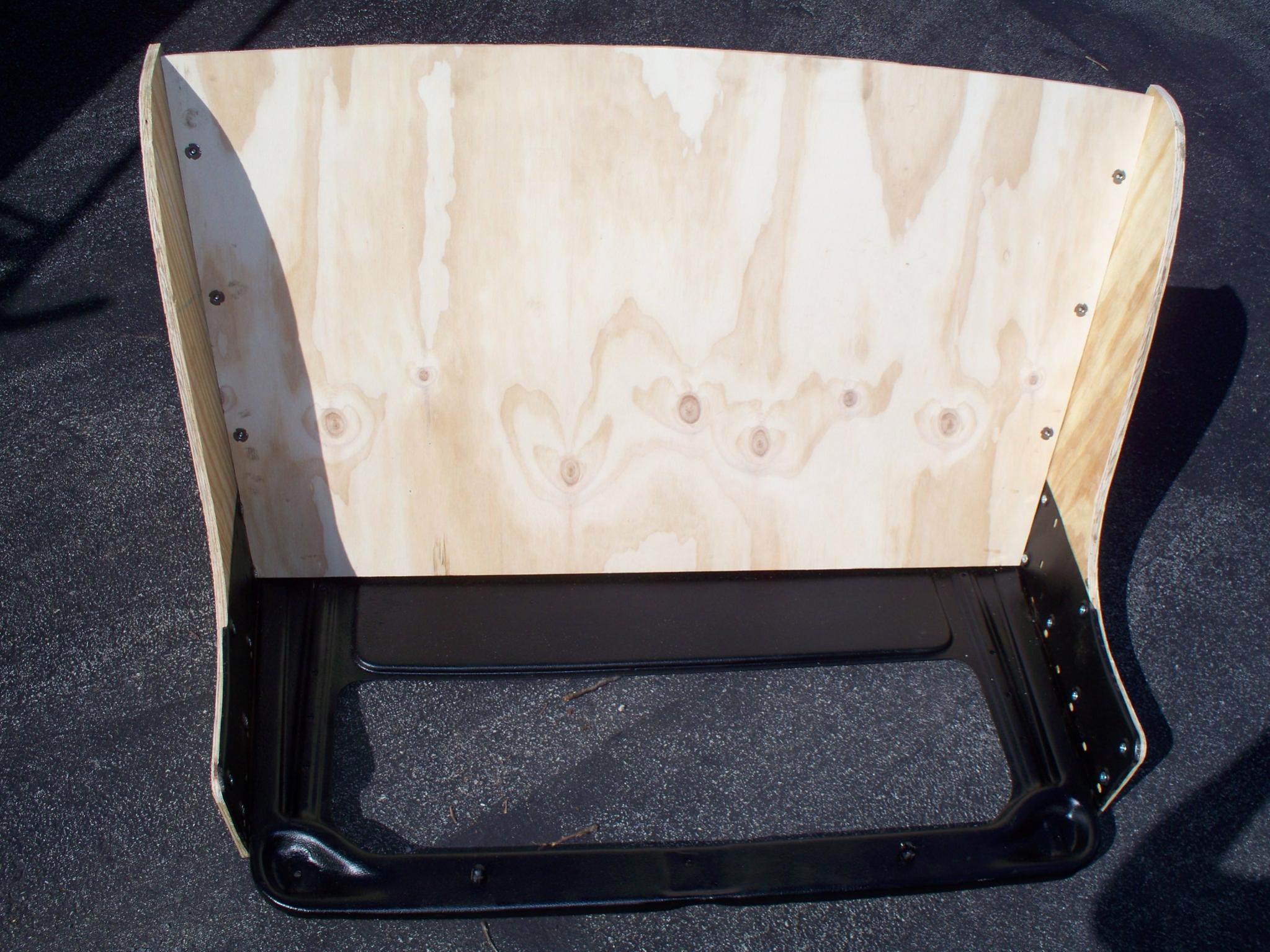

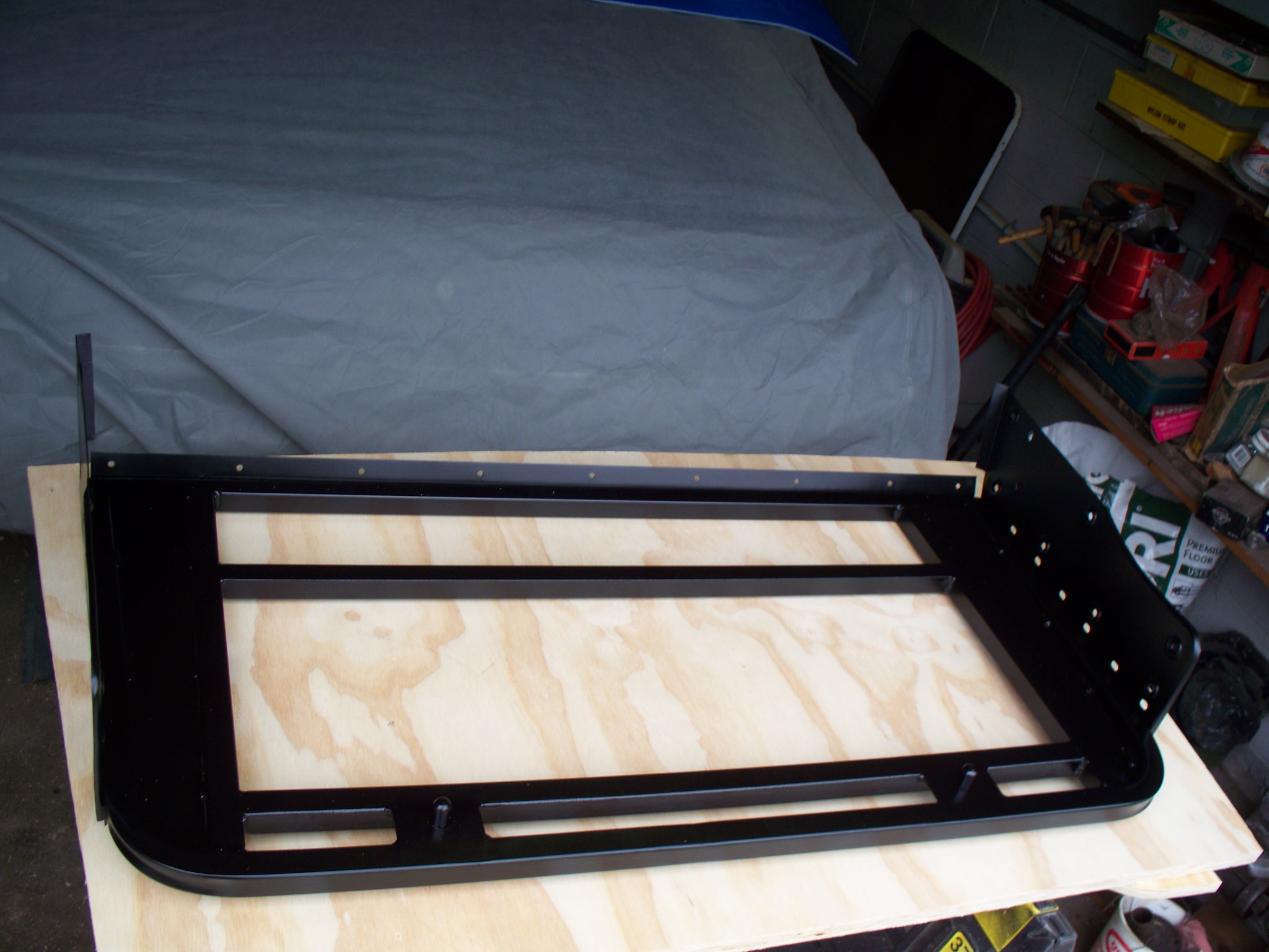

    New 34 Ford Coupe Seat 05.jpg New 34 Ford Coupe Seat 06.jpg New 34 Ford Coupe Seat 14.jpg New 34 Ford Coupe Seat 17.jpg New 34 Ford Coupe Seat 18.jpg New 34 Ford Coupe Seat 19.jpg New 34 Ford Coupe Seat 24.jpg For the past few years, a friend (Donnie Smart) has suggested multiple times that I make a copy of the '33/4 Ford coupe seat. Don had a set of patterns for the wood and I have a couple of original seats. Since the home construction business isn't keeping me busy, I thought that this would be a good time to make an attempt at creating a seat. Who knows, someone might even want to purchase one of these seats (I made templates). The seat duplicates the original in size so that it will also use the original springs (available in reproduction from Synder's). It turned out well enough that I sold one of my original seats and will use this one in my '34 5 window. The original seat pan is a stamped sheet metal item. My seat bottom frame is made from square tubing. My version is much more ridgid than the original and is about 10 pounds heavier. Check out the photos below. I'd be interested in feedback from y'all, especially '33/4 Ford coupe owners/builders.

    Yes, I would build the seat then disassemble it for shipping. By assembling the seat, both the buyer and seller are sure that the seat can be assembled without a bunch of extra work. The assembled seat can be shipped easily by Greyhound bus. The disassembled seat would be shipped by FedEx.
    I started with the '33/4 Ford seat because that's the car that I have and I had a couple of excellent original seats to use as a reference point. The wood isn't too much of an issue, as long as you don't get the seat too wide. I used Donnie's wood patterns and then checked them against my original seat, which still has it's original wood. I built the metal base on top of an original seat pan. This way I made sure that the width, taper, and contour matched the original seat. It'd be a pain to go through all this work, get the seat upholstered (which means the sides get padded) and find that the seat hit your door panels.

    Here's a photo of the replacement seat frame, which I patterned after the original seat pan. I've also included three photos of an original seat pan, with new wood and no seat springs.

    I appreciate the feedback, guys. Do you guys think that this would be more attractive to potential buyers if offered as just the metal structure and a set of paper patterns for the wood? This way the buyer wouldn't be paying me to cut and fit the plywood, then turn around and disassemble and package the whole thing. Shipping would be cheaper, as well, since the bottom is smaller than the backrest, as well as not including the additional weight of the wood pieces and the associated angle brackets & bolts. I'd only be shipping the structure shown below.
