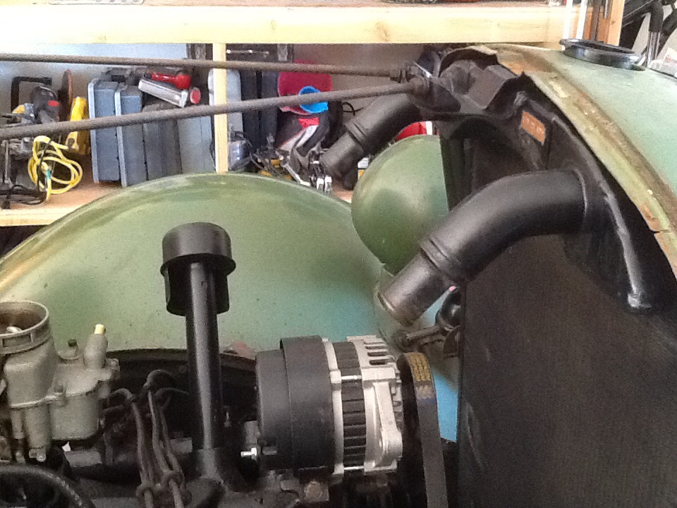

    image.jpg The radiator top tank outlets are a smaller diameter than the bottom inlets.Would larger thermostat housings improve flow as well as removing the small portion of the top inlets?(see pic) Also I figured out how to use stock gen bracket and small alt.Cheap and easy!

    cooling the engine involves keeping the coolant in the block long enough to remove heat.

    That pulley is a stock gen pulley I cut down with a hole saw.It fits the alt shaft exactly.

    Possibly , but there are other things I'd check out first if you are having a hot running problem . Are you just wondering , or is it actually running too hot and overheating . Give us some more details . The alternator setup looks good and a nice upgrade .
  5. Keep your stock outlets. If you are not yet having a cooling problem don't go looking for one. If you get it running and it doesn't cool come back and we will rip your build part and find you an answer in the process. ;)
  6. Do you have a shroud, and what fan are you using?

    Those are more than large enough to cool the motor. If it's hot ( and the radiator is good) the first thing I'd look at would be ignition timing.

    I agree. Don't change those outlets. I have never run thermostats in any of my flatheads. A good upgrade would be high volume pumps and a 4 pound pressurized system.

    not enough timing

    The stock 8BA thermostat housings were more than adequate to allow for sufficient water flow for cooling. Leave them alone. Check your timing.

    I was enlightened today by Cornhuskers Rod shop that the 59a radiator setup had the larger radiator inlets and the 8ba had the smaller 1 1/4" inlet. Looks like a early radiator was converted at one time to be used with 8ba heads? Looks like you have the later flathead looking at the intake. Like others mentioned, I would leave the inlets alone and look at timing. Does the core flow well?

    I was just late night speculating,no problems yet.Thanx to all!

    dan c. said: "cooling the engine involves keeping the coolant in the block long enough to remove heat."
    It amazes me that even today people actually believe this. One of the main requirements of a good cooling system is to have high flow rates through the engine as this promotes turbulent water flow and turbulence is required to promote the best extraction of heat from an engine. A flat head has several problems, one is the exhaust is channeled through the block , this is something that you have to accept unless you want to spend lots of money, the other is poor water pumps, even some of the new "high performance" pumps are not very good. The higher the flow rate the better the cooling.
