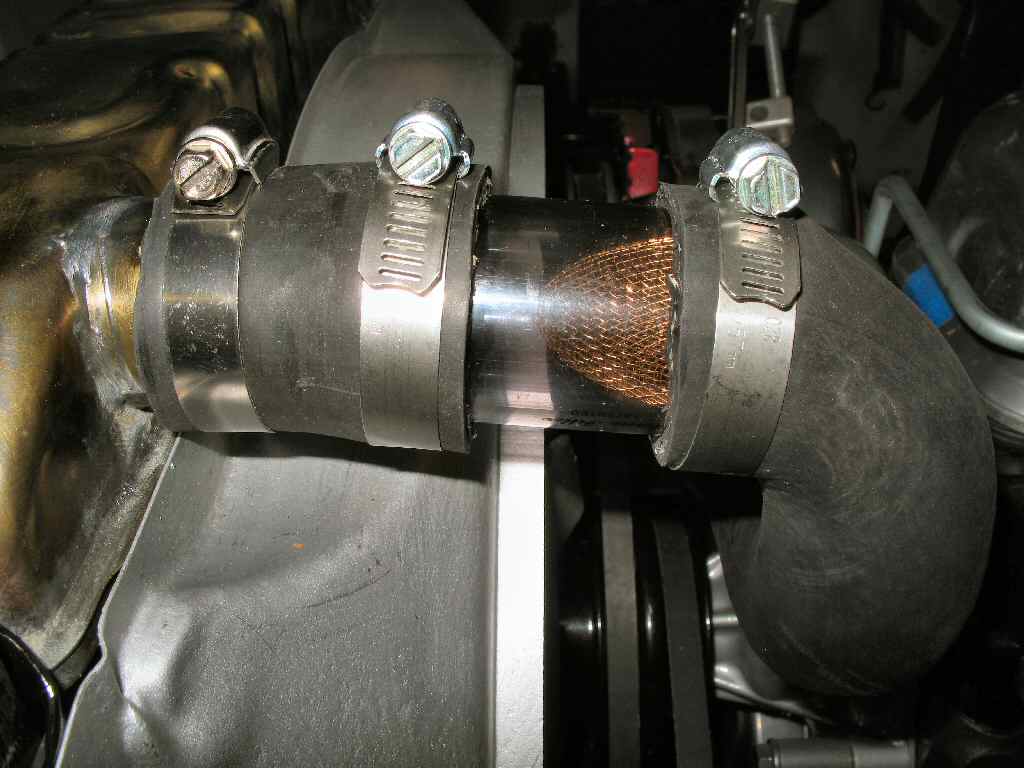

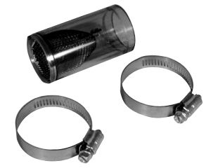

  5. See pictures i just added to my orig post of such filter

    I can't believe a lot of you guys don't know what a Gano Filter is. I bought (back in the 90's) and used two of them on my cars. On my 64 Ranchero with a 260 it caught a lot of crap and junk from going into the radiator and I had one on my rebuilt 69 Camaro (350 engine). On the Ranchero it was routine to take it out and clean the filter then put it back in, it worked great on the Ford. On the Camaro it caught a little bit of stuff but the Chevy was pretty clean compared to the 260 Ford. So for me it worked and a old radiator guy told me to install one when I was fighting cooling problems on the 260 way back when.

    The filter is real and it works. Since most states have outlawed hot tanking blocks it is possible that rust inside the block can come loose after rebuilding and clog the radiator. The filter catches most of these particles and prevents them from clogging the radiator core. This is not just restricted to SBF, but is applicable to all older engines. I have been using then for years and they work! Those of you how are puttiing these filters down are just to stupid and ignorant to recognize a good product when you see it. Nuff Said!!

    I have used them in the past. They did seem to work. I used them after putting in new radiators and they did capture small chunks of debris. I dont remember them being too terribly expensive but that was 20 years ago. Whether or not it was really needed, I dont know but seeing all that gunk in the filter and not clogging the radiator was peace of mind for me.
