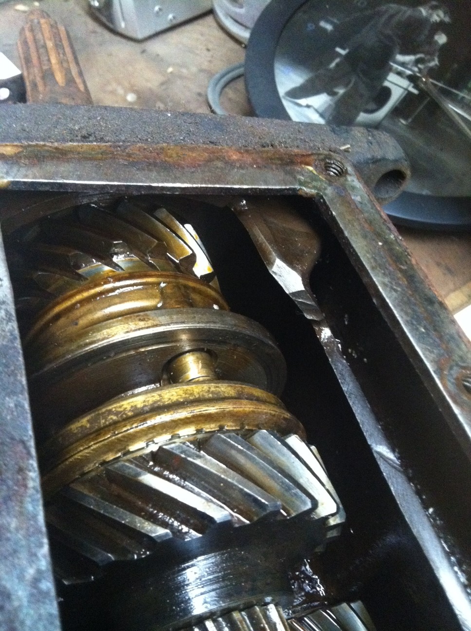

    I figured I would post pics of this trans I picked up. It is really cool and I figured some of the guys would appreciate it. It appears to be around a 40 Lasalle side shift converted to top shift and early ford closed drive. The side shift was removed and the holes welded up. The top of the tranny was cut off and it looks like they cut the top of a early Ford top shift case off and brazed it on. The front shift fork is modified to work with the Lasalle and the rear fork looks stock. It seems to shift good. Just a neat old piece. I would be interested if anybody has seen one done like this. Now I just need to build another car around it. LOL

    That's some crazy amount of work for back then, and they most likely could have found a 37 for $50 if they tried hard enough :)
    I have a modified 51-up Olds trans similar to that, but with a 37 Buick top cover shifter. Lots of machining and brazing on mine.

    Transmission Specialists had 1958 Hot Rod Magazine ads for these, but no tech article about how they did it.
  9. F&J
    Joined: Apr 5, 2007
    Posts: 13,221
    F&J
    I've seen the ad on here somewhere. Anyways, I am trying to recall what trans was in the pic with that Ford top cover "with modified forks". The ad did say the forks were modified, etc
    Maybe FalconGeorge remembers it, as he was talking about that mod, maybe 2 months back. I don't think it was a LaSalle/Cad, I almost thought it was a GM Selector trans, but I'm not sure at all. It showed a flat plate adapter to make the Ford top fit the other top load trans pattern, so, the one I saw was not a brazed setup.

    Packard, but the caption said they did a similar adaptor for side-shift cad/lasalle. Frank, whats interesting is, the original piece we are talking about used an adapter plate to mate the ford top plate to the case, and we were discussing whether it used different shift forks or not. Now this deal shows up using modified ford shift forks. See where I am going with this?;)

    Can the OP PLEASE post some pics of the shift forks??
  20. superchargednailhead
    Joined: Jul 20, 2004
    Posts: 245
    I can take more if you want I had his on my computer. The rear shift fork is stock unmodified ford.

    I can't even guess how hard that was to cut two cast iron cases apart with what they had for tools? And cut them so that the joint line was close enough for brazing rod filler?
    Then, it must be close to a 2 foot length of brazed joint, and how to keep it from cracking, by the time you braze all the way around to where you started?
    Had to be set up on a big wood stove I would guess.
    ...and planning the 2 cuts to have the fork heights to be close? Yikes, try that today, even with modern tooling.

  27. the transmission in my car was not brazed, it was welded with a torch. it was done, in 1958, to keep the car looking original. my uncle liked to keep people guessing, and never told anybody what the tranny was. the car was raced and won trophies, was my dads daily driver for years. i started working on the car when i was 14 and drove the car to high school and put thousands of miles on it driving to car shows in pennslvannia, new jersey, new york, and all the new england states....tranny was never a problem.
