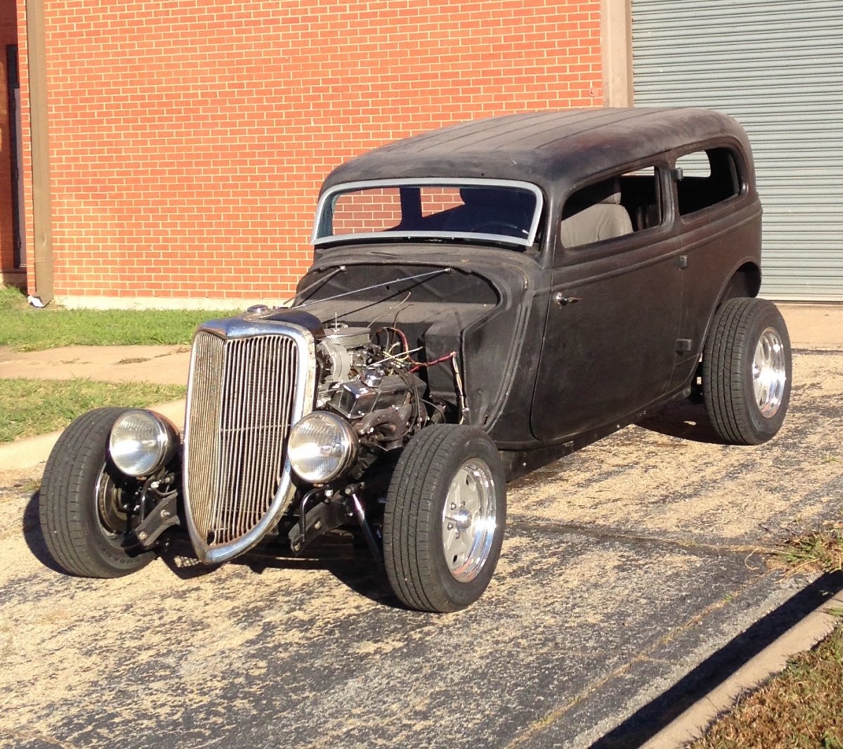

    Conner Drost and I will be working on this metal work conversion for stage one. DSCN0375.JPG DSCN0376.JPG We picked up this sedan body over the weekend

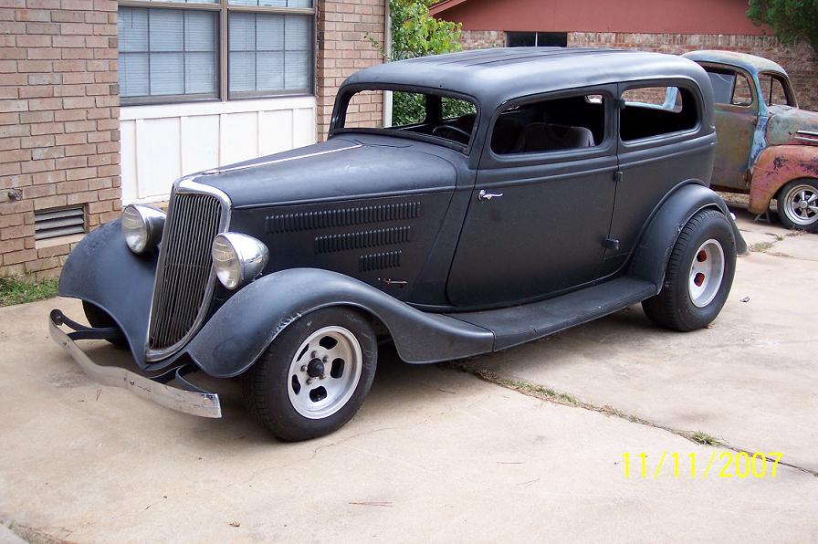

    I'm going to join the "Don't Do it, find a Four Door to cut down" team. But of course, it's your car so my opinion matters none; so I'm really only replying so that I can watch the thread and see the progress. I'm really interested to see how you do it.
    This is my Sedan, I'll put the fenders back on once I get it further along...

    Thanks guys we're excited as this is a personal project rather than a customers.hardest part is carving out extra time versus working on customers projects and family life.
    I did a quick search and nothing popped up converting a sedan to a 3 window,any of you guys came across anything? I always like to see what's out there first method wise ,before we start cutting.i did find the 4door to 5 window on here ,end result looked awesome.
    Again thanks for support and encouragement.
