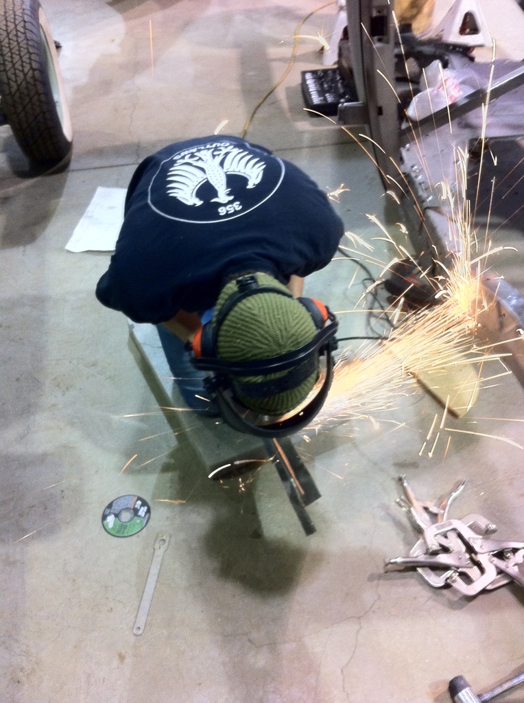

    Pop's and my conversion of a 4 door sedan into a 5 window coupe. With help from Chris Davenport. Already made quite a bit of progress, so i will post a few pictures to get everyone up to date. Hope to learn from the community and hope this thread will help someone else.

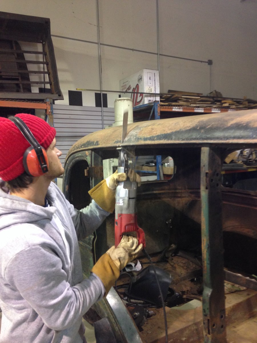

    Now for the tear down

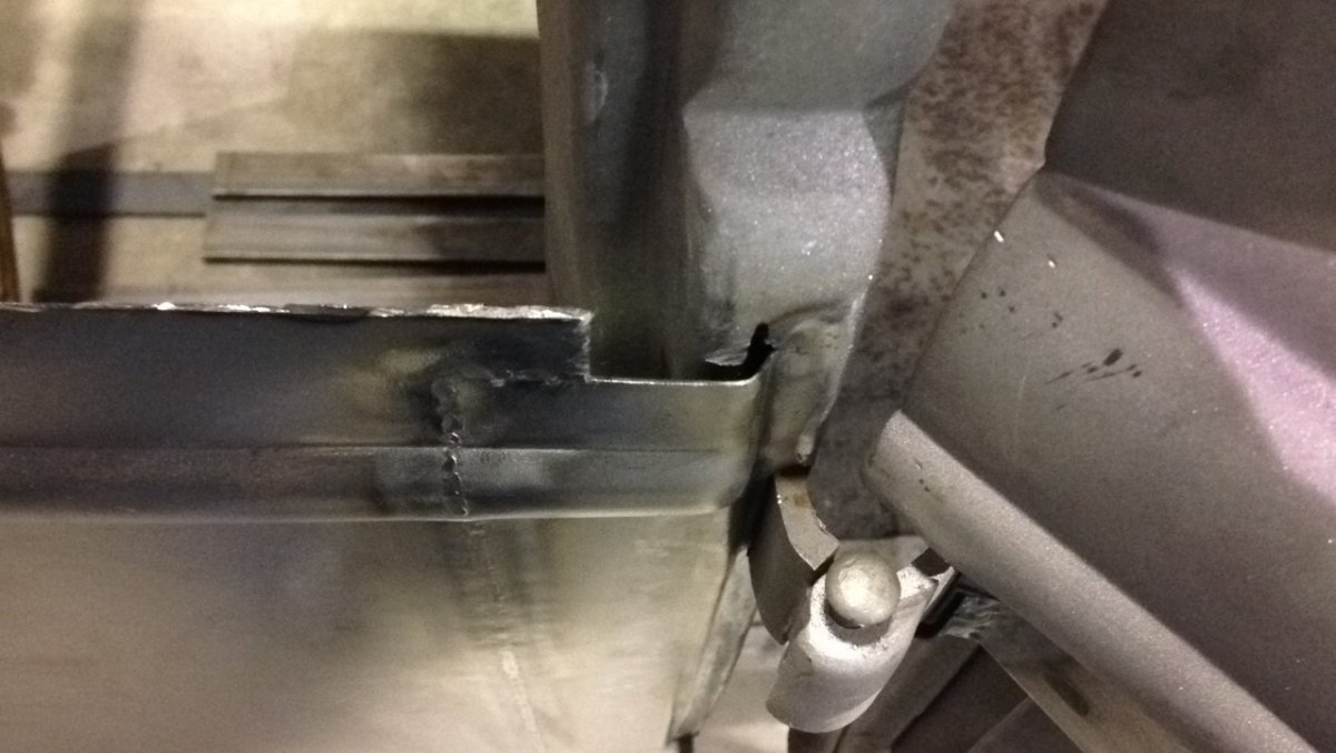

    Rebuilding the sub rails.
    The original bottom hinge was missing so we took a hinge off of the back door that we were not using and then grafted a new piece of metal onto the hinge so it would be the length we needed.
    Also took a pice off of the back door bracing and grafted it in and welded it to the hinge.

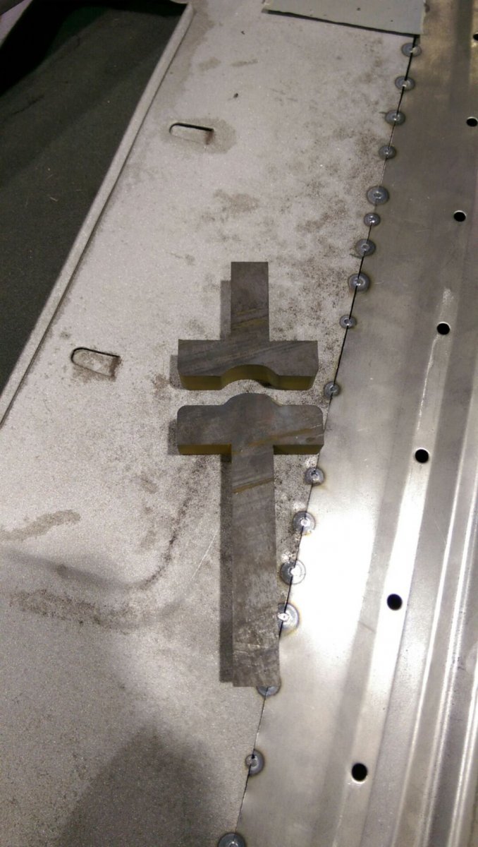

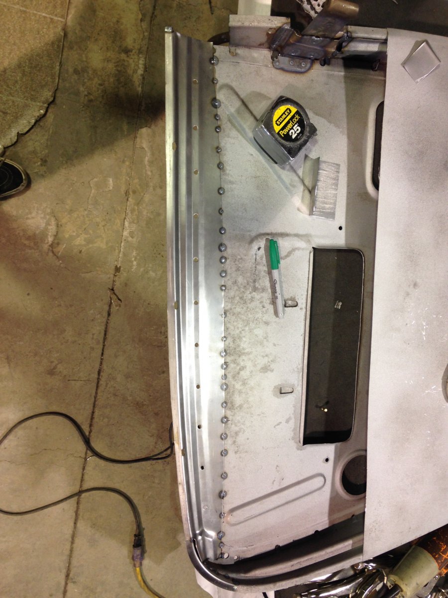

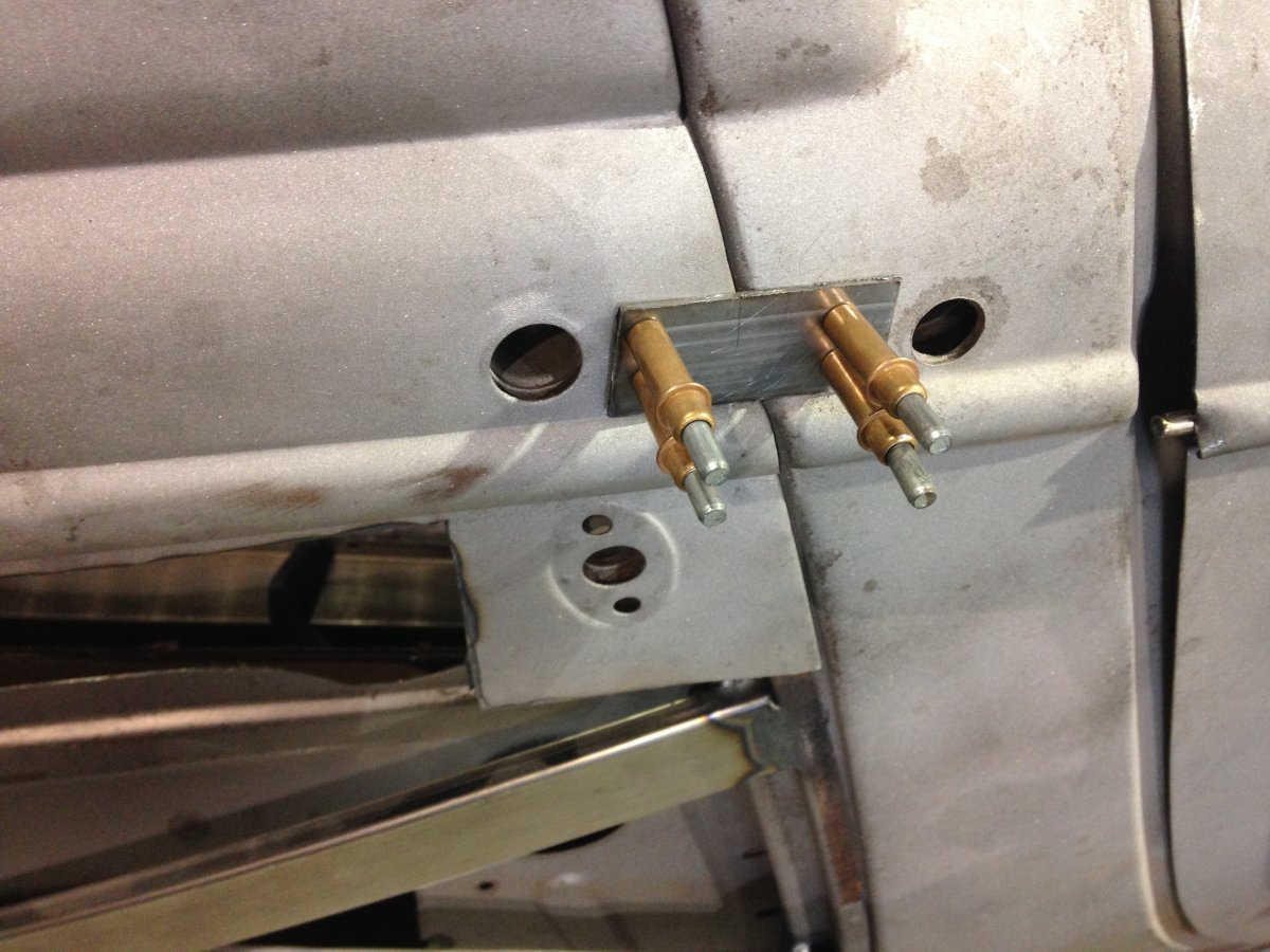

    turned a small flange and cleko'd it to the quarter panel so it would hold the correct shape.

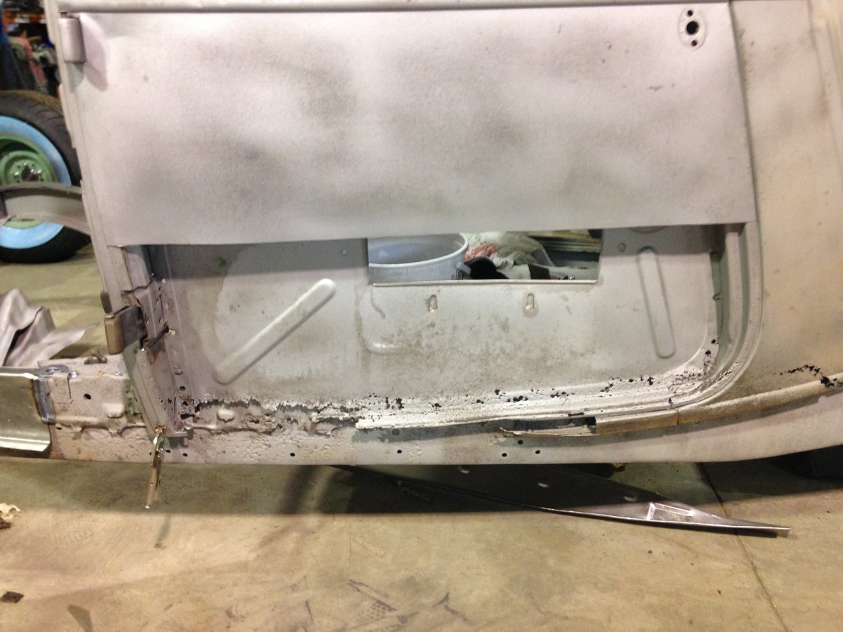

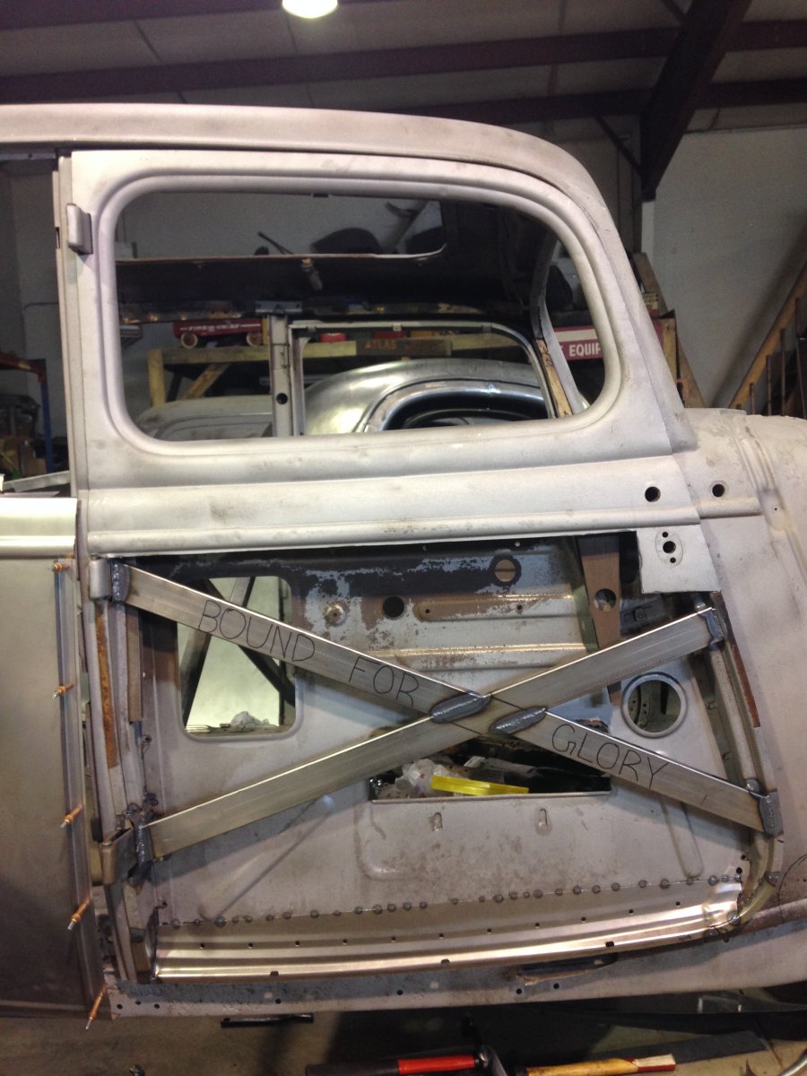

    Repairing the bottom of the inner panel of the passenger door. Created a new structural piece for the bottom corner.
    Put in some much needed cross bracing inside the doors, "on the side he's got bound for glory, in red, white and blue flash paint." who knows the reference????? Doing some adjusting on the hinges to get the gaps right on the doors.
    Doing some much needed rust repair/patch work.

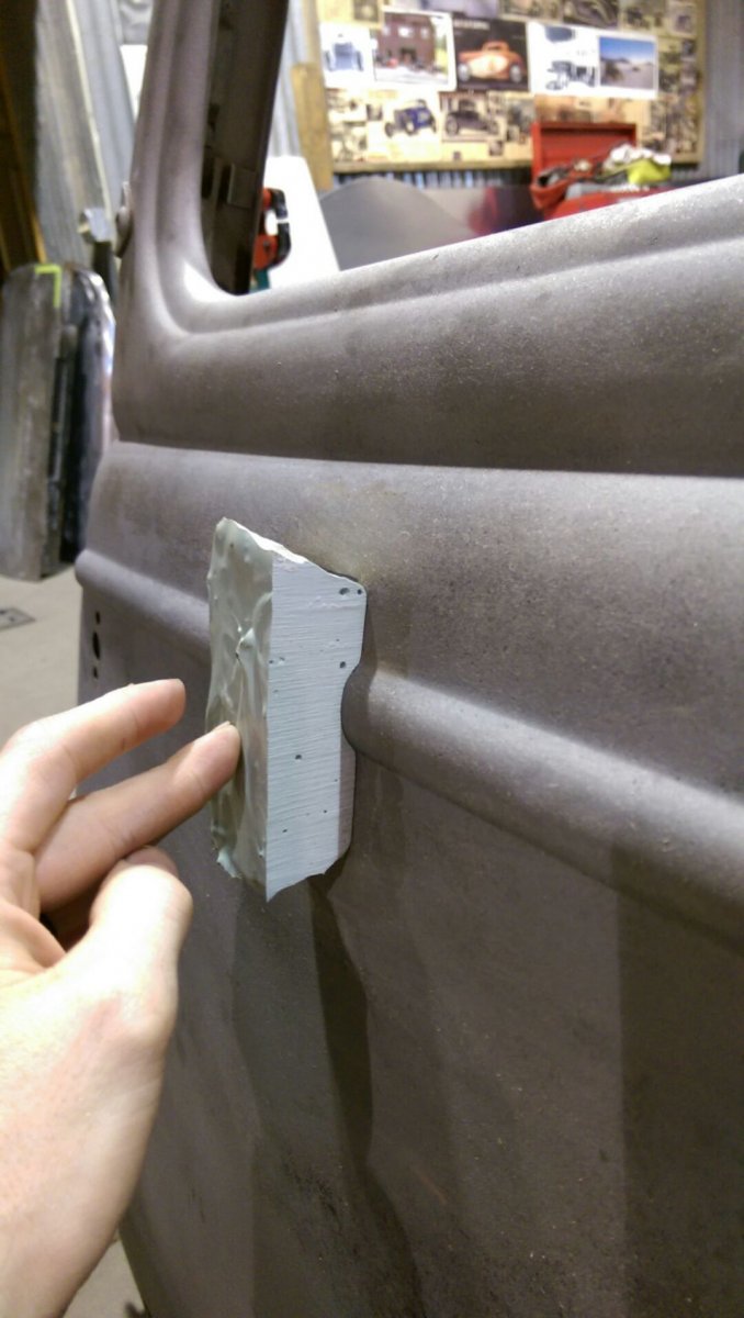

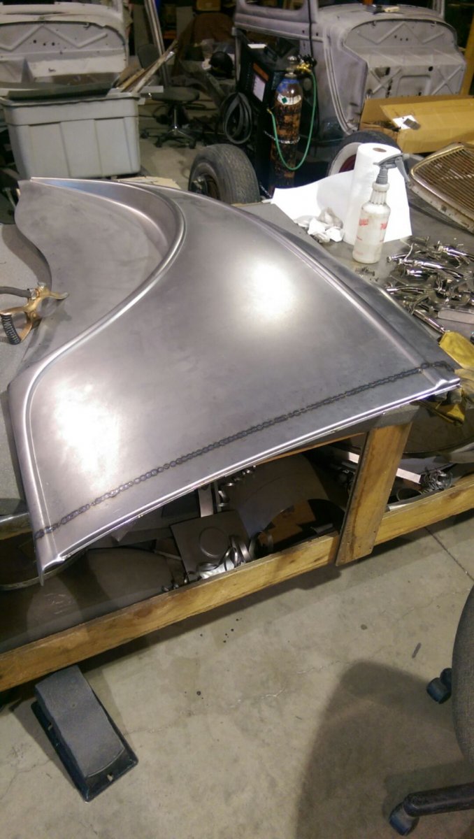

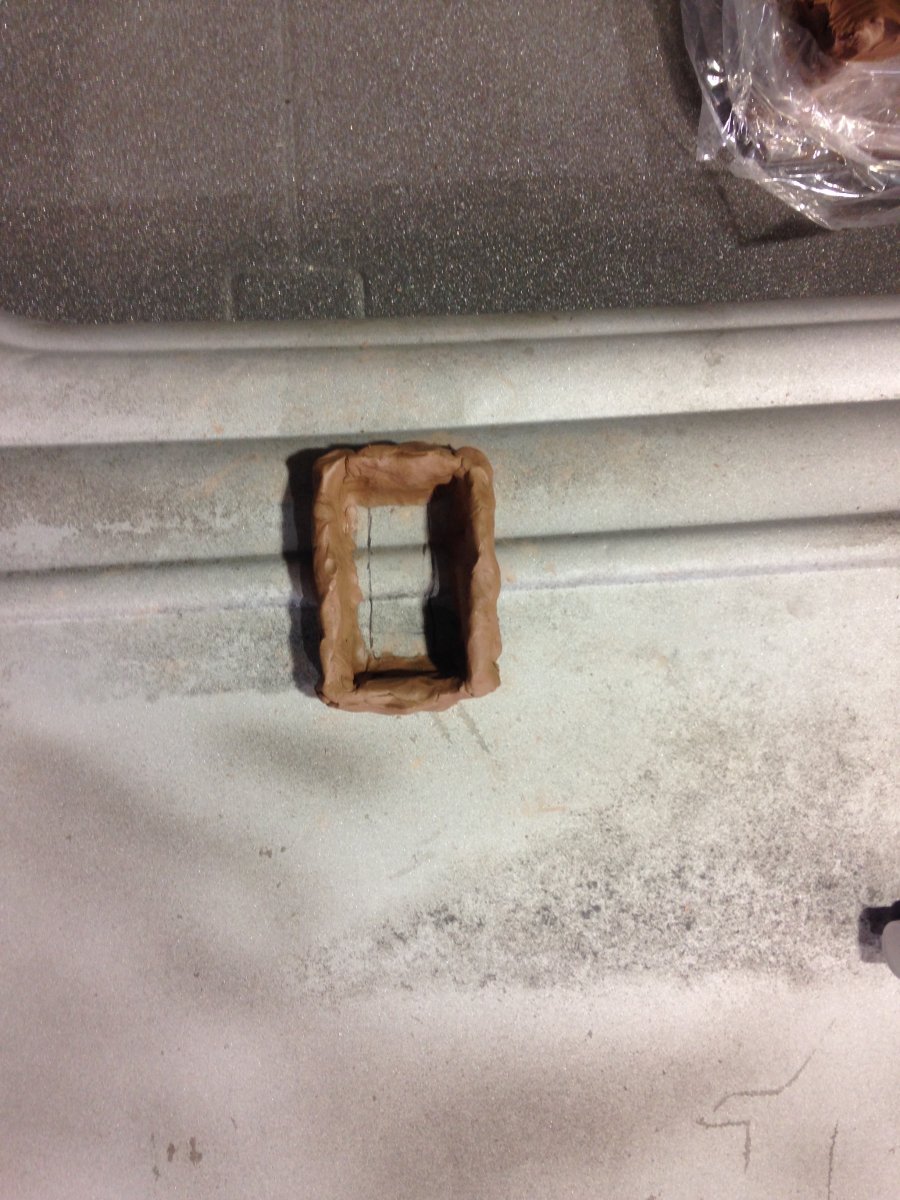

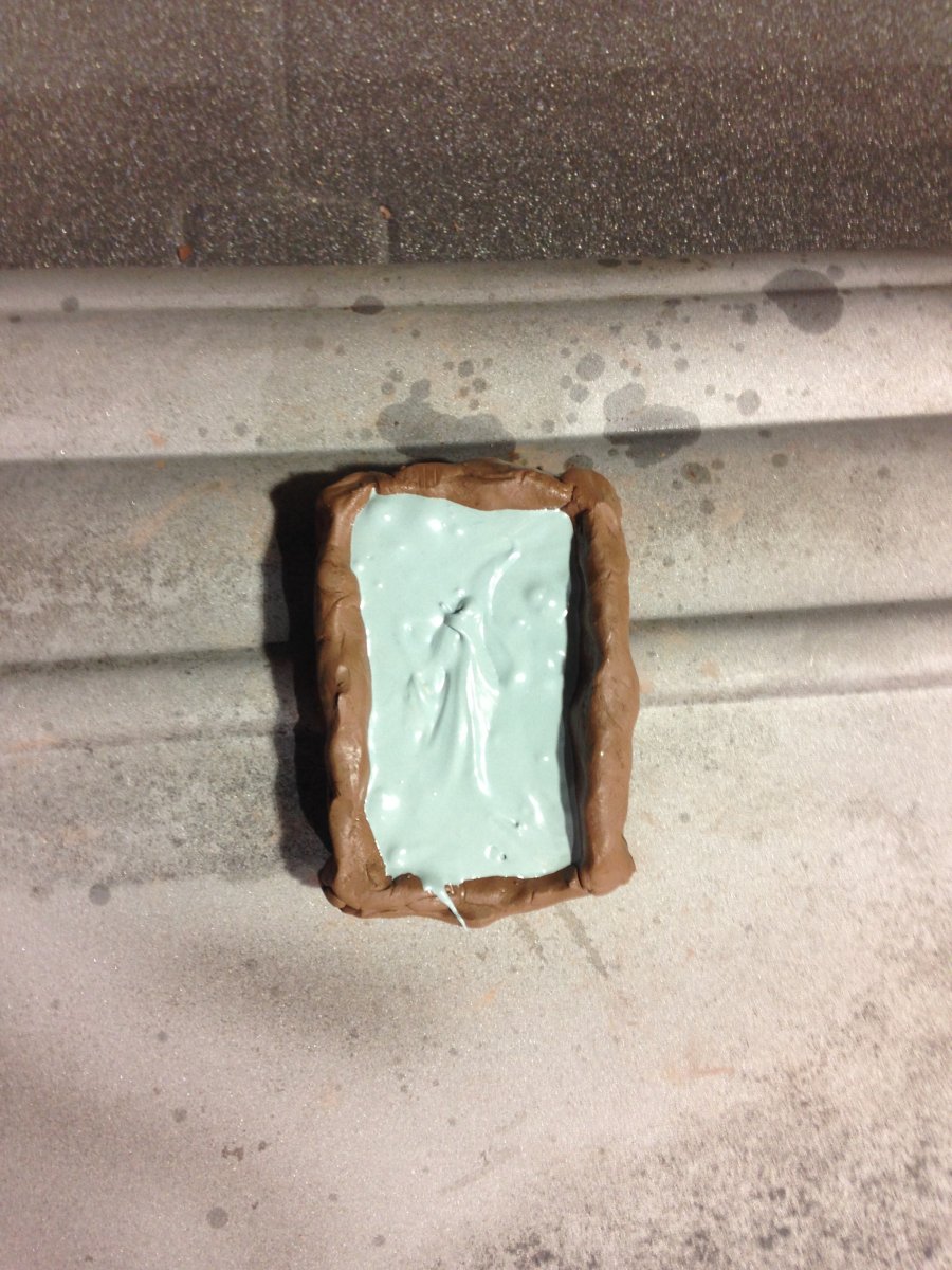

    Bondo was used to the the exact profile of the belt line. Once it was hardened Chris sliced it in half and scanned it onto the computer to get an exact computer duplicate to send of to the machinist to get a dye made. We later discovered that the belt line was tapered so we ended up cutting the dye in half and stamping out one side of the belt line at a time.

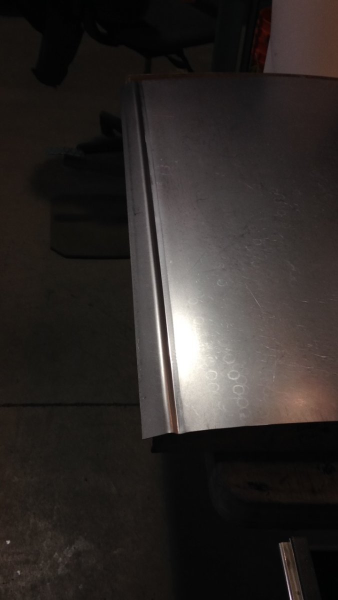

    Chris pounded out a door skin on the power hammer and we did some pre stretching for the belt line.
    Here in the previous two photos you can see that only one side of the belt line has been hammered out. The picture below is the finished panel and belt line in place.

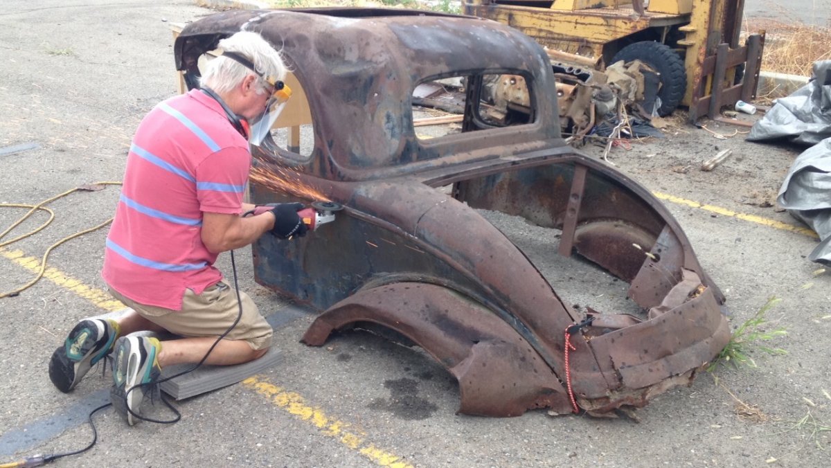

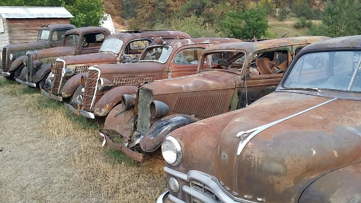

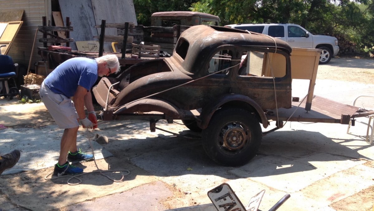

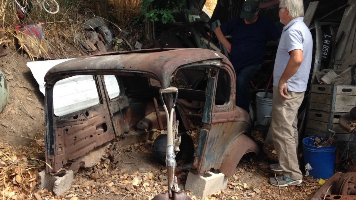

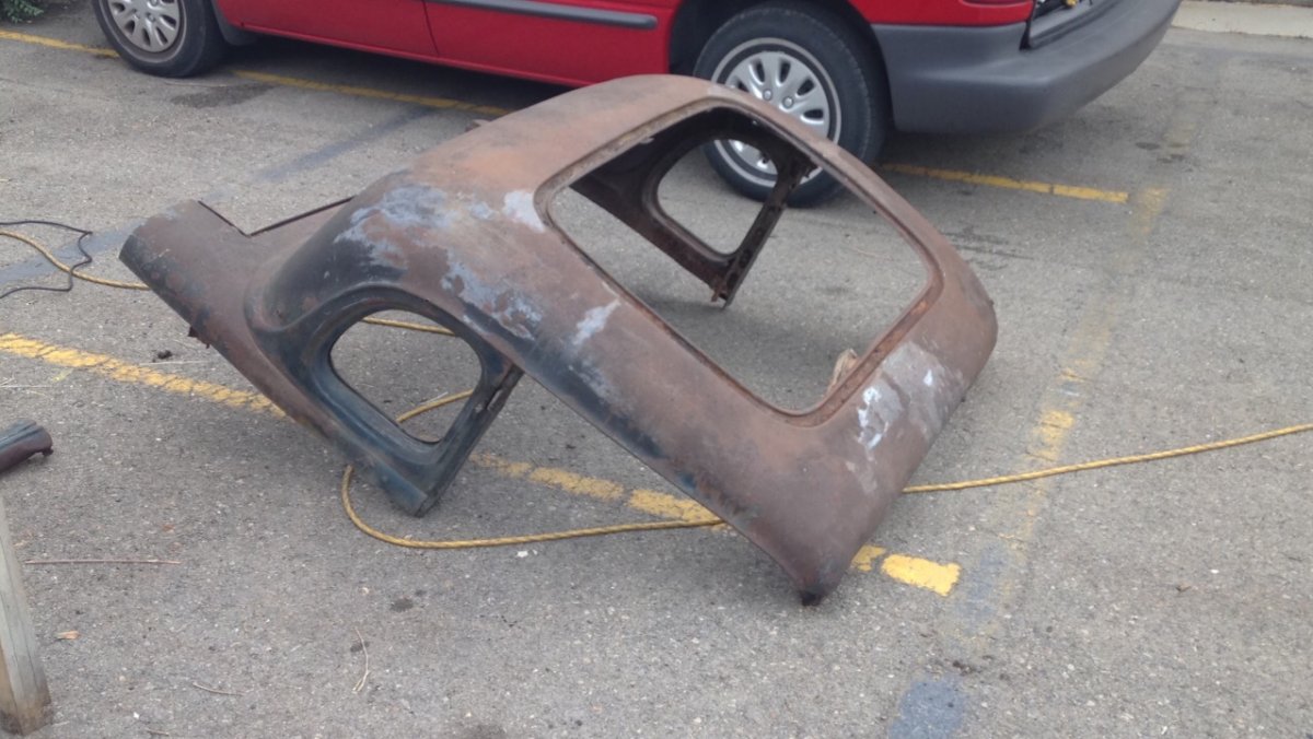

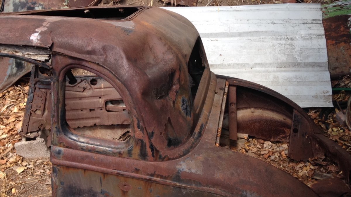

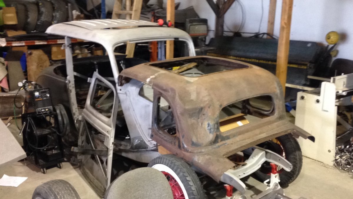

    Here are more photos! The picture above is where we originally found the car. She's the second one in. Too bad she is missing the grille right?
    Woken from her slumber. Notice the shovel acting as an A pillar to hold it up.
    Nothing a few hits with a hammer won't fix.
    When I was hauling this I was thinking to myself... 99% of humans don't even know what this is on my trailer. They just look at it as a piece of junk. I was also thinking if I get in a wreck right now I hope they hit my car not this beauty I have on the trailer.

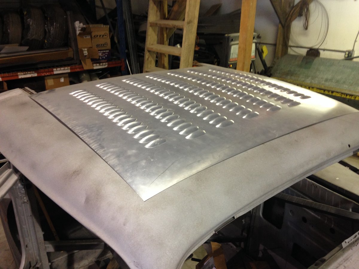

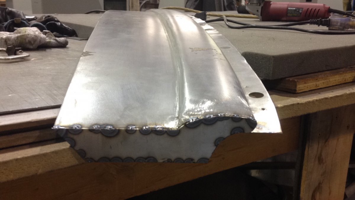

    The two meet for the first time. Little sneak preview of the aluminum louvered roof insert we made as well.
    The dye we had made.

    Between the 5 window quarters, the cut off chunks of the roadster quarters, and the belt line dye, chris will fart out a complete roadster body instead of taking a lunch break someday.

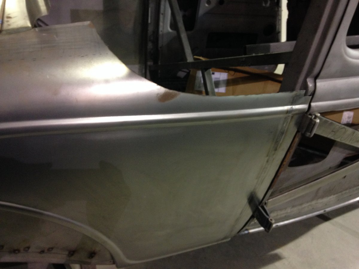

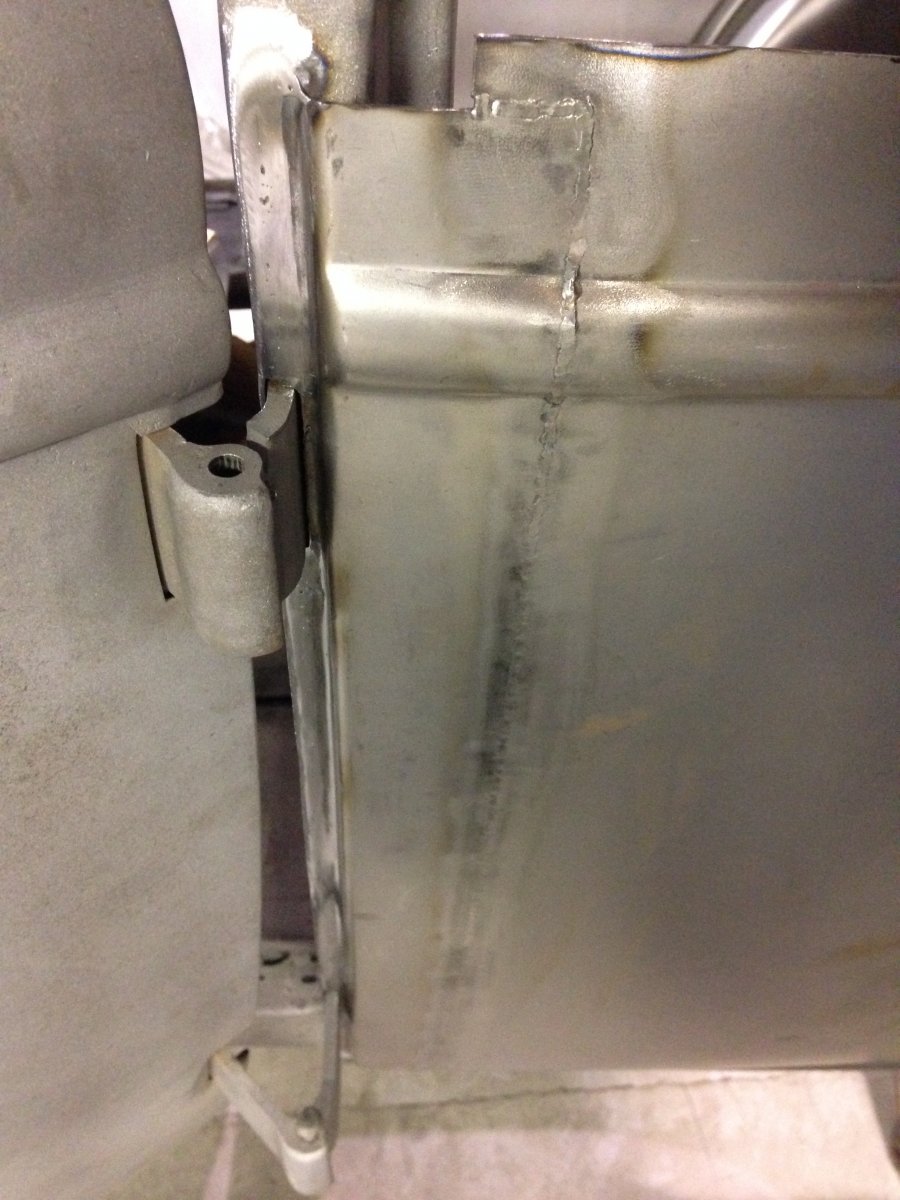

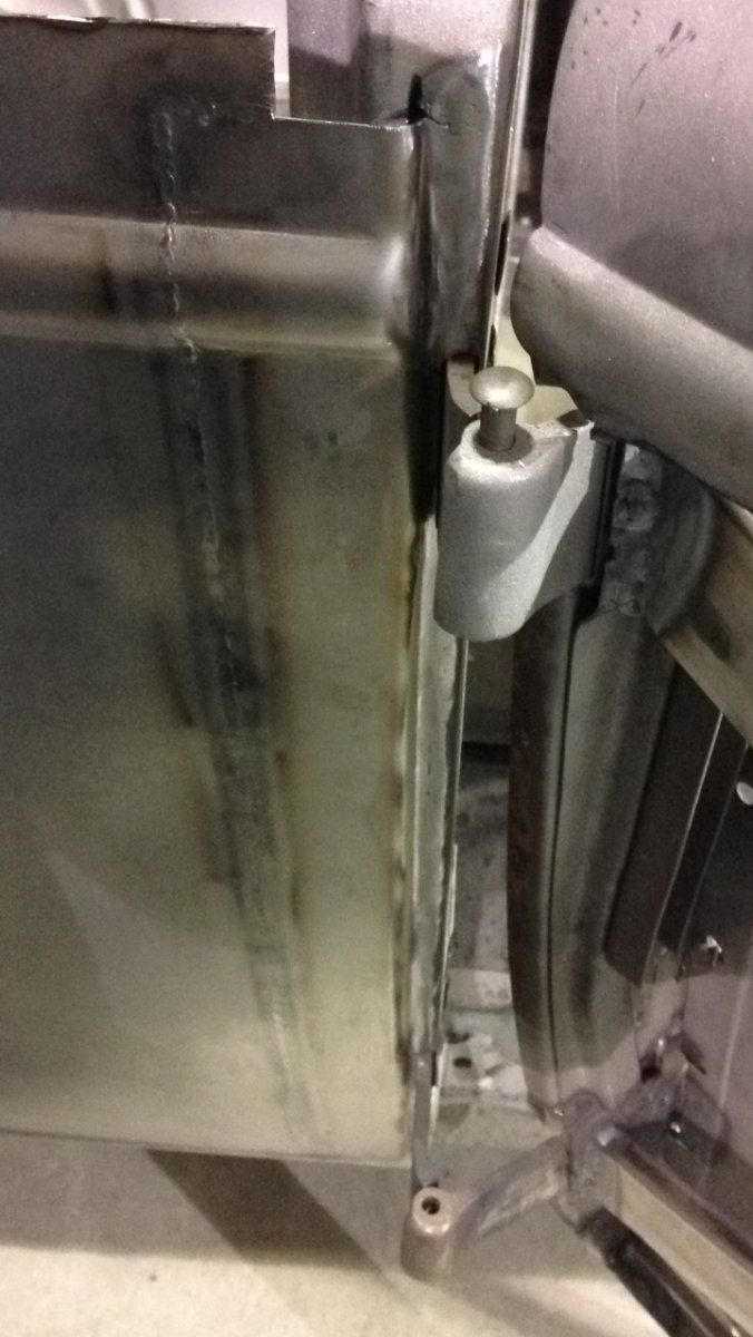

    Fitting the quarter panels on the car...first we cut out a linear section of the b pillar, cut the front end of the quarter panel off then tacked it into place. Then fitted the quarter panel and scored where the two overlapped. Cut and weld. Turned out great.
    Fitted the back end together and welded it into place.

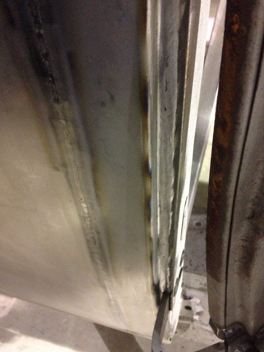

    You can see in this image where the quarter panel was welded into the b pillar. All gaps and surfaces matched perfectly.
    You can see where I welded and then grinder smooth.
    This picture above is of the drivers side.
    Where the quarter panel was welded into the b pillar and ground smooth.

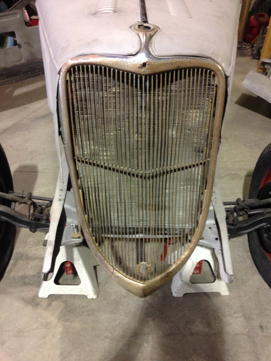

    Was able to find a 33 grill! Need some tweaking but will work.

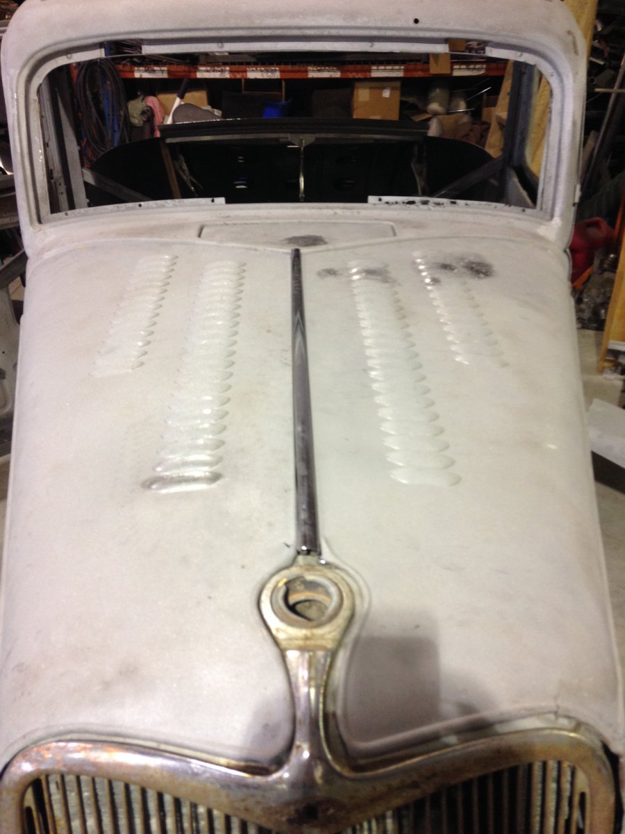

    Louvered the hood, you can see it needs a little tlc.

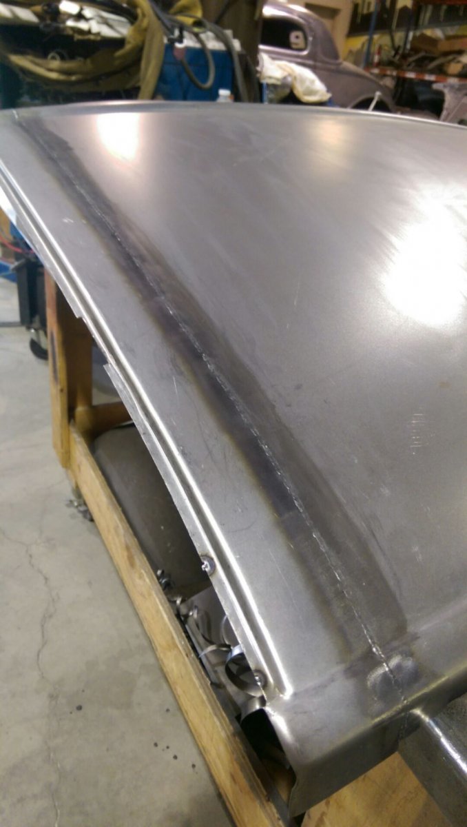

    Roof insert pounded out and louvered. Ready to be fitted, will be able to use Chris's new flanging machine he is making to turn the flange with ease.
