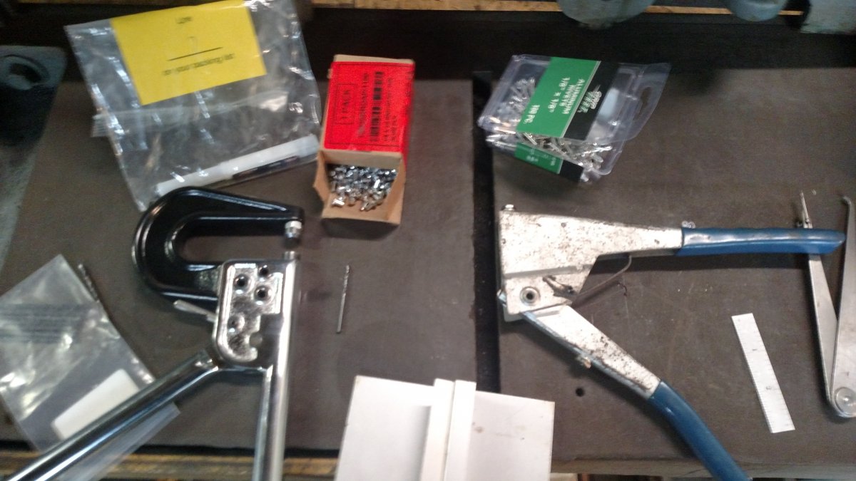

    Well after three different job changes in 2016 I am finally working somewhere that leaves me with enough spare time to start back up on this project.
    Last week I got some 4x4 .125 wall box tubing and split it down the middle to make two 2x4 c channels. This should make for a nice stuff but lightweight frame. I am hoping to come in at about 1000 lbs without driver. But before I go any further than mocking up the frame rails I need to make sure I know how much room I need for a comfortable seat.
    I made up a pattern for the bottom of the seat. My plan is to make a staggered side by side bucket bench seat thingy. I want to make the whole think out of aluminum. While I could Tig weld it together I thought I would go for a slightly more aesthetically pleasing solution. Rivets!
    I started with a test panel to make sure I liked the spacing and got all the folds in The right order and orientation.
    On the right is the pop rivet tool, the pop rivets arejust used to hold the panels together so I can insert the solid rivets. Clecos would be really helpful right now. On the left is the rivet squeezer I am using to set the 1/8 aluminum rivets. Below is the final result. I am glad I made the test joint because I didn't actually have enough room for the squeezer on half the holes.

  21. J. A. Miller
    Joined: Dec 30, 2010
    Posts: 2,064
    J. A. Miller
    from Central NY
    Where did you get your rivet squeezer?

    So what was the issue with room Burke? In aviation sometimes we must grind off things a little to allow clearance to get on rivet at 90 degrees. If the dome snap is not high enough as in tool is fouling with the flange you can space the set down with spacer washers...It is very good to do the test piece as you are...
  25. Burkedore
    Joined: Nov 9, 2013
    Posts: 146
    Burkedore
    The rivet is too close to the bend not allowing my to center the tool. I could grind the head a little but I think changing the part a little will work better.

  26. Burkedore
    Joined: Nov 9, 2013
    Posts: 146
    Burkedore
    http://www.browntool.com
    It's the "economy" model. Pretty good for the price. If I were building an airplane I would definitely but the real thing though.

    If you have room on your actual part to layout the hole away from the wall or flange that is a good option...if you really have to put it in that location grinding the tool carefully is an option and if its the rivet set itself you can buy smaller diameter ones or grind them as well.
