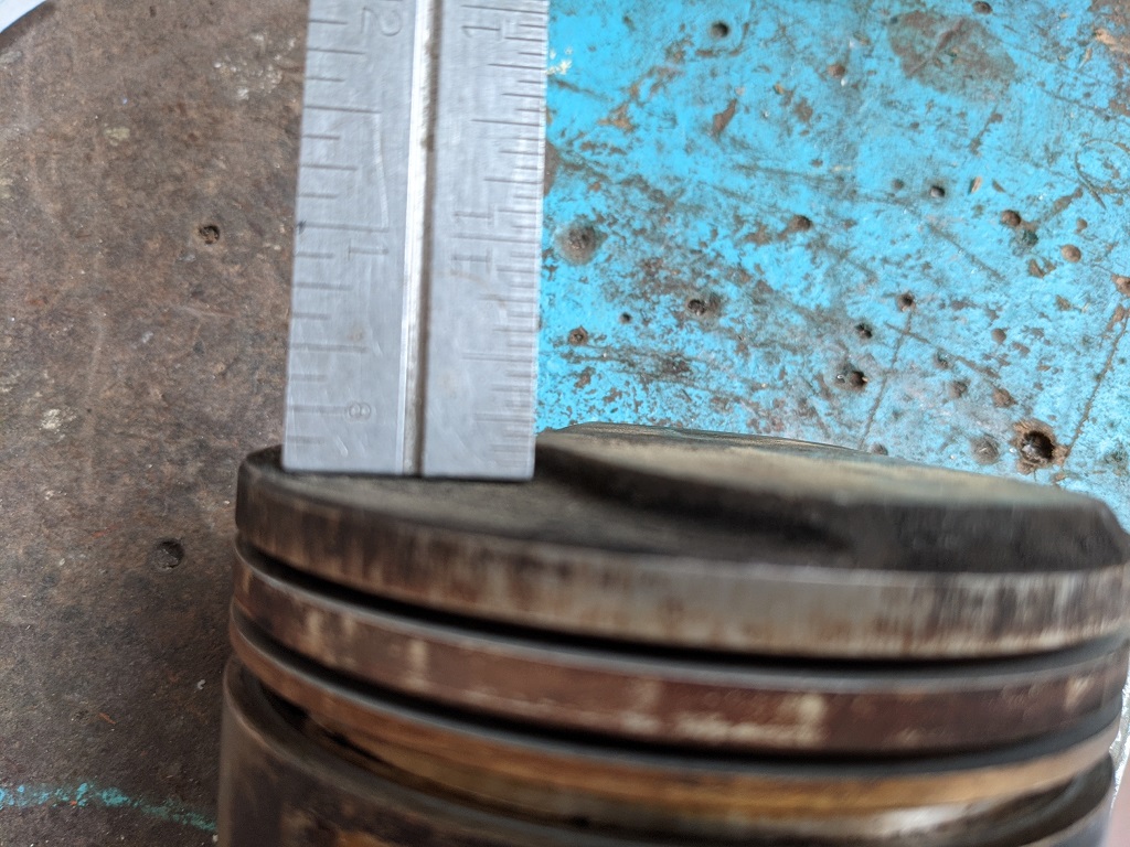

    can you post pictures of the pistons? or measure the dome height?
    Black Panther and Desoto291Hemi like this.

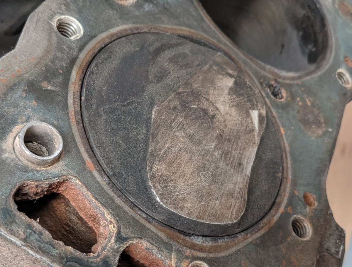

  21. Ghost28
    Joined: Nov 23, 2008
    Posts: 3,200
    Ghost28
    Deuces likes this.
  22. 1971BB427
    Joined: Mar 6, 2010
    Posts: 8,759
    1971BB427
    from Oregon
    Hard for me say without seeing the whole piston, but those don't appear to be factory pistons? Look similar to what Sealed Power sold as replacement pistons for the 396 engines. Depending on the piston, these may no longer be a 11:1 piston. If the wrist pin location adjusts the height, the Sealed Power were rated 9.5:1 with a 100cc chamber. So be sure what you truly have before changing heads, or you might end up way low!
  23. squirrel
    Joined: Sep 23, 2004
    Posts: 56,071
    squirrel
    cast pistons?
    375 hp were forged, weren't they?
    anyways, can you measure the dome height?
    Deuces likes this.

  25. 1971BB427
    Joined: Mar 6, 2010
    Posts: 8,759
    1971BB427
    from Oregon
    Yes, but I believe these are replacement pistons, so non factory anyway. Even some cast were milled tops, so tough to tell. But Sealed Power used this shape, and the as cast finish, which leads me to think they are cast Sealed Power, and might be lower compression than original 375 HP.
    He needs to check the bore size to see how it compares to stock also.
  26. Truckedup
    Joined: Jul 25, 2006
    Posts: 4,660
    Truckedup
    those pistons may be showing a bit of detonation erosion?

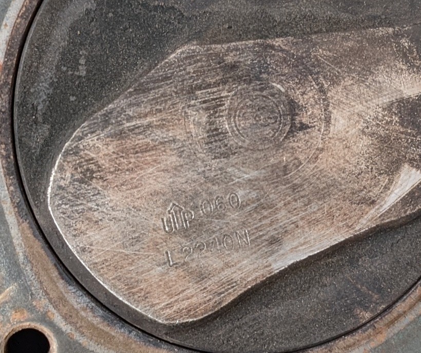

  27. squirrel
    Posts: 56,071
    squirrel
    these work fine with closed chamber heads...but they're not 375 hp pistons. Forged replacement 325 hp.

  29. squirrel
    Posts: 56,071
    squirrel
    or maybe they're the 11:1 pistons? they also sell some with a .110 dome
    yeah, they're 60 over, like my tired old 396 block...and they were in a 30 over 402, before it spun a main and a couple rod bearings.
  30. Ghost28
    Posts: 3,200
    Ghost28
    Laying a flat edge across the dome it measures pretty close if not exact to 3/16th of an inch. I am gonna have it taken apart and checked out for new bearings and rings, If they are the 325 horse sealed power, I am thinking on using the closed chamber heads I got with it, if I can keep the compression usable for the street and possible some strip. Should I be concerned with detonation corrosion lookin at them? The pistons on this engine don't show any over size, and the bore with out getting too technical is 4 inches plus a tad over 1/16th inch
