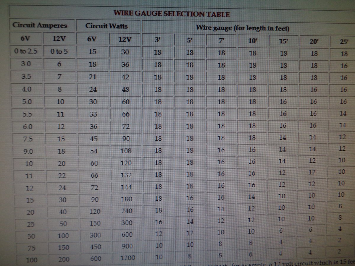

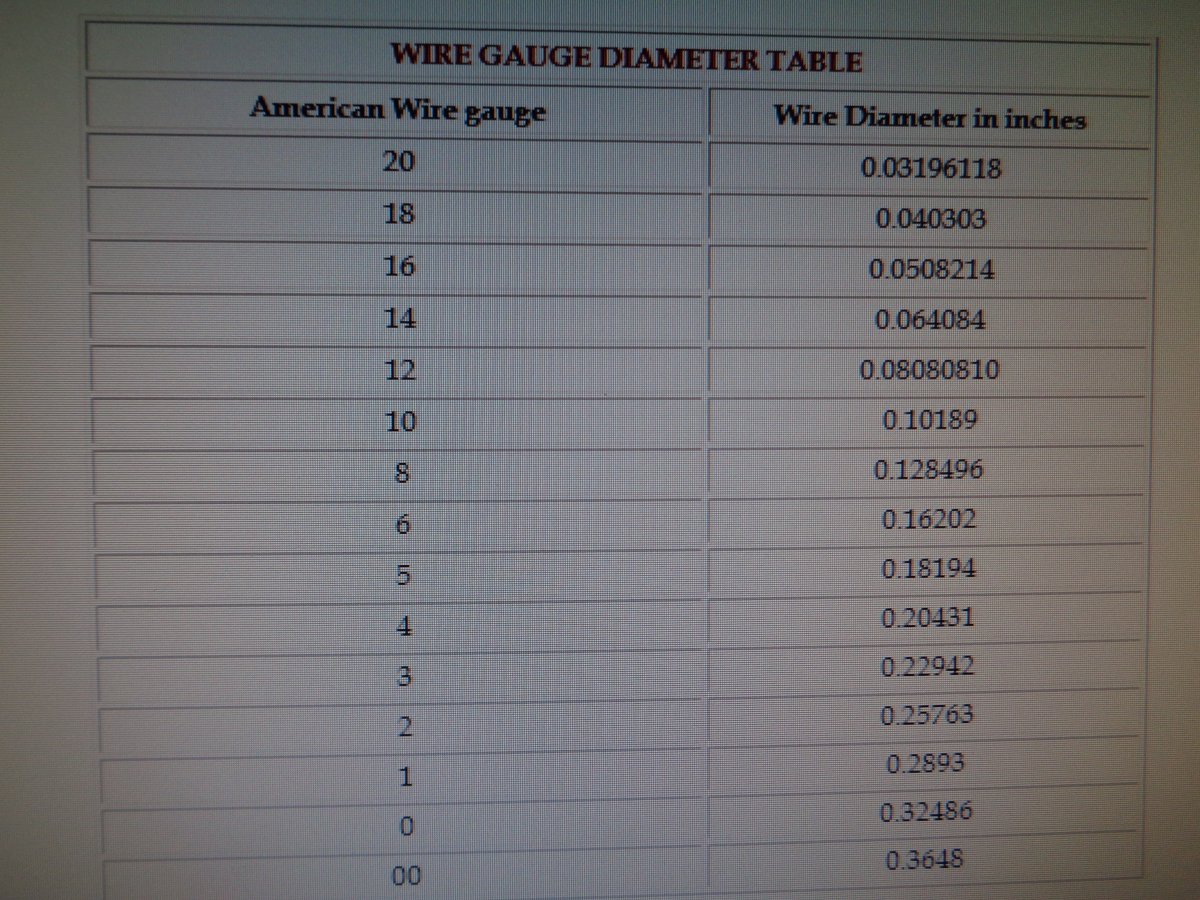

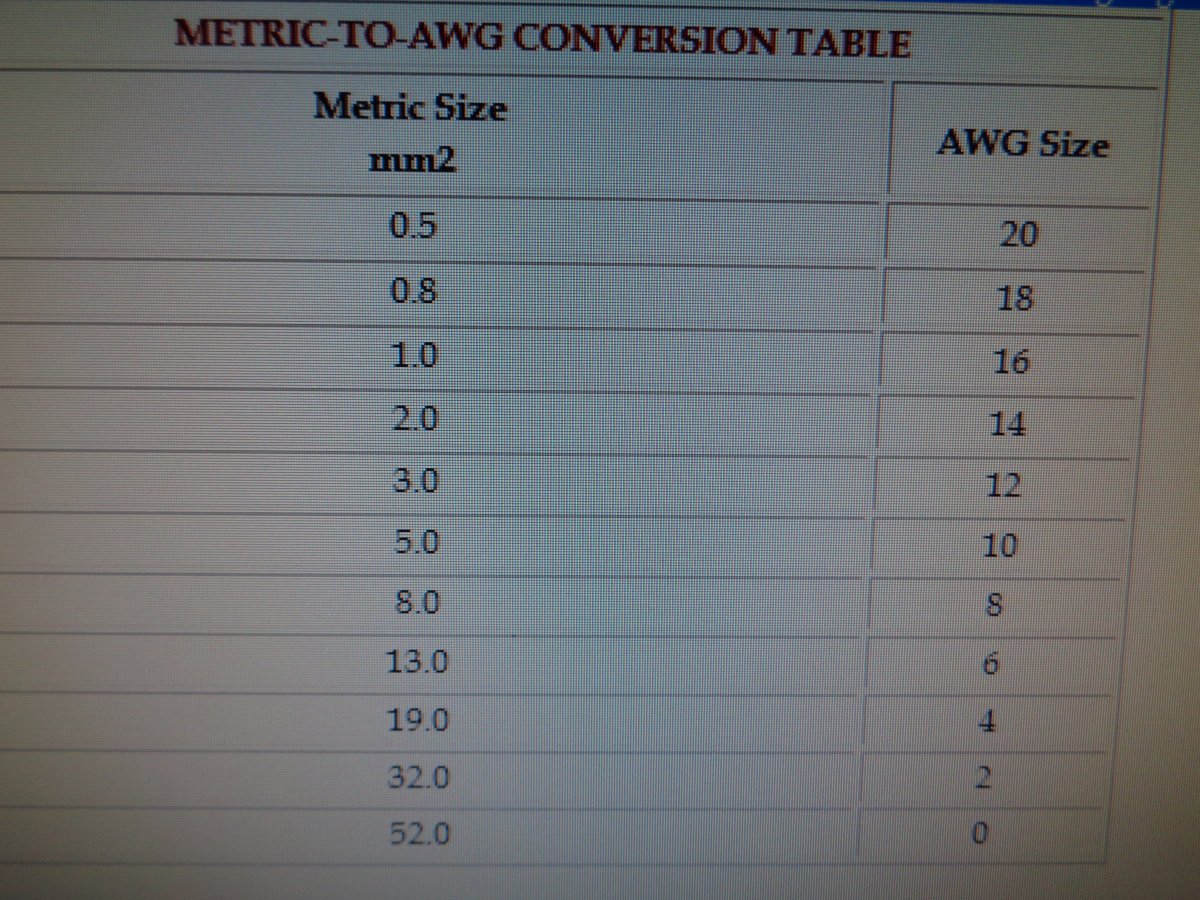

    Take the time to look over these wiring tables. Everything you need to know about selecting wire gauge is there. Sorry that I had to take pics in order to relay the info.
    American Wire Gauge (AWG) sizes may be determined by measuring the diameter of the bare wire. When choosing wire gauge, the distance the wire must run and the amperage it will need to carry must be determined first.
    Refer to the Wire Gauge Selection Table. Note that you can always use thicker wire ( lower gauge number) than is recommended.
    Using the Wire Gauge Selection Table - Find the amperes or watts the circuit is expected to carry on the left and the distance the wiring must run at the top - followthe columns until they intersect. For examl
    ple - a 12 volt circuit which is 15 feet long and carries 10 amperes should use at least 16 gauge wire.
    Hope this helps.
    AZguy likes this.

    Almost every wire is either just bare copper strands missing all the insulation or the insulation is broke open in many spots. Over the years as stuff needed to be replaced they would just splice wire in and tape it with cheap tape so there are sections of just rolled up sticky wire where the heat has broken the tape down. The few wires that were replaced weren't done right and aren't the correct gauge so I don't trust anything else that was replaced by him over time. I don't plan on keeping stock gauges, lights, or switches. I'm going to make a panel and fit it into the dash to replace the factory gauge panel.
    Thanks. I don't plan on trying to run just heavy gauge just because like you said if I need a certain connector size it won't work. For the majority of just the general wiring though I'd rather run a little heavier gauge, then heavier gauge when necessary. I don't plan ok running much but extra, no power seats or windows or anything like that but I will probably get some kind of a/c system later.
