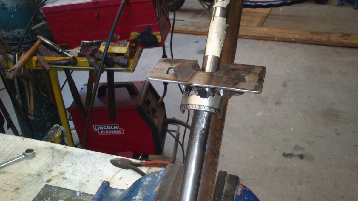

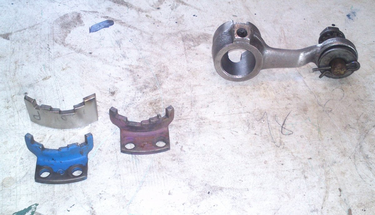

    Use the OEM column and do what X38 did on his Ford. You need a vertical shaft to engage detents and some form of retainer to hold shift tube in tension. Use an OEM single linkage to hook to your transmission.
