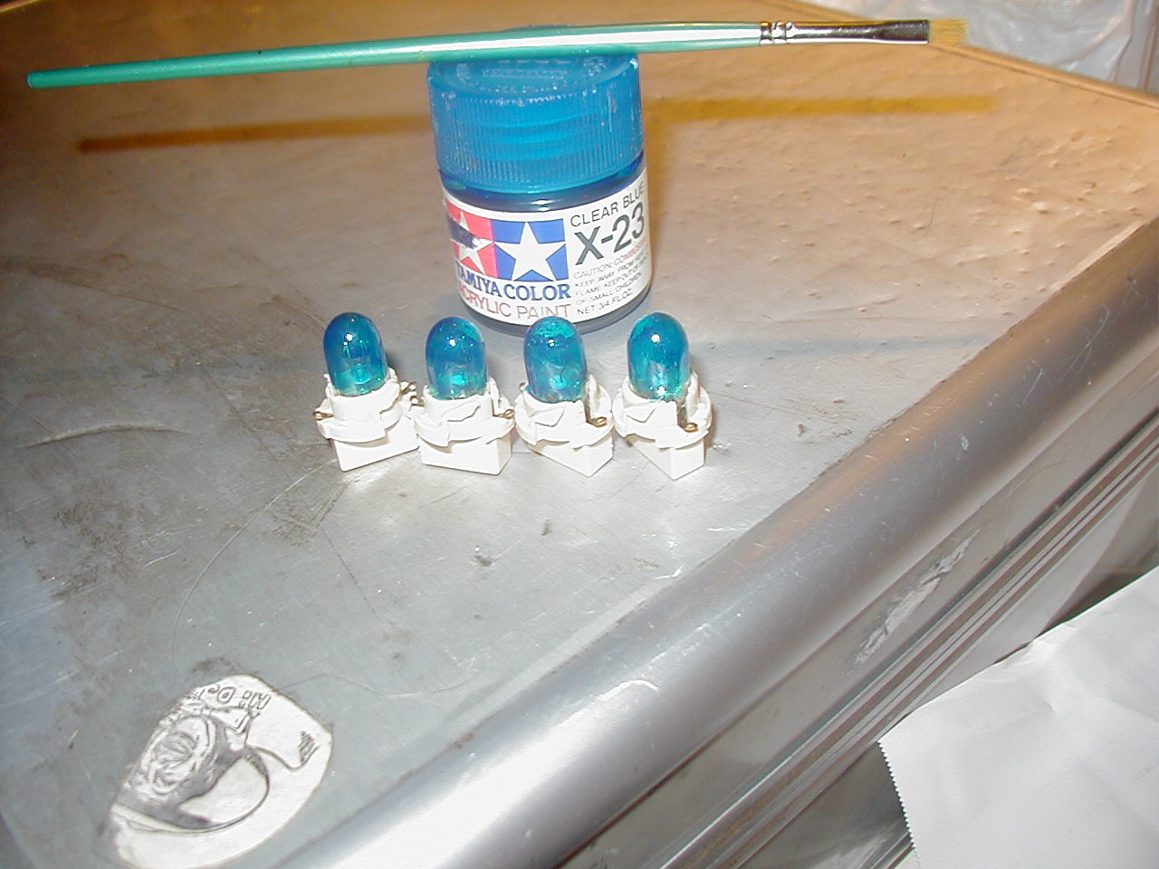

    I've used magic markers with some success...

    Go to the hobby store and buy some transparent spray on model car paint. Works perfect - I've tinted all the interior lights in my car. Works better than the caps, because you can control how tinted they are by the number of coats you spray on. Also a whole bunch cheaper too - tint a couple dozen bulbs for $5 bucks vs $5 bucks a pair for the caps!

    I used to paint the interior light bulbs in my big truck cause they were too bright. Model car paint lasted years and big variety of colours to choose from

    X2... model car paint
