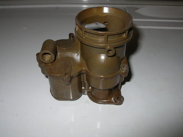

    I do the alodine thing. I prefer the powder form over the premix as sold by that airplane supply place.
    Heres' an example.
