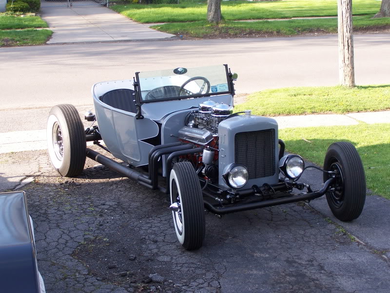

  30. I have the same problem with my 5.60 X 15's, there's a flaw in the tread pattern. My buddies set has the exact same flaw which means it's in the mold. If you look at the center tread towards the top on the right in the first photo. You can see a wiggle in the tread pattern in the center only.
    The second picture look in the same general spot but only on the left tire. It's on every 5.60 15 I've seen. Double click the picture if need be.
