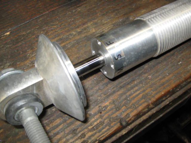

    Have a pair of these coil-over shock assemblies that have a sticker as shown in the picture with S F M S F M printed at the top of the shock. Are these shocks adjustable? If so, how are they adjusted? Thanks for your time.

    I don't know on those shocks but my koni coilovers adj by pressing a button on the top of the body and turning the shaft
    My other Koni shocks adj by compressing shock and turning shaft.

    SicSpeed: Thanks. I compressed and turned them and I do hear a click as I rotate the shaft. Just need to determine S, F, & M by trial and error now. Thanks again.

    If you know any local racers they might have a shock dyno to check the rebound change

    Counter clock is usually soft
  6. Soft, firm and meduim.
