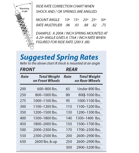

    Here are a few items that have been posted in other threads that may amount to some useful info all in place for you check out.

    A few questions arise: surely the correction factors should equal the cosine of the angle from vertical? The factors given in the respective tables differ from one another, and both differ from the cosine of the angle in question. I should rather expect:
    • 10° .985
    • 15° .966
    • 20° .940
    • 25° .906
    • 30° .866
    Importantly, this applies only where the force to be resisted is vertical, e.g. a conventional axle. If there is a linkage of any sort between the wheels and the springs, e.g. (but not only) any kind of independent suspension, it is necessary to figure out the direction of the force where it acts on the spring, and measure the installation angle from that angle.
    (The .pdf file shows a set-up featuring triangulated 4-links and a Watts linkage, which should generate a conflict of rotations, even though the angled links' angle is insufficient to provide adequate lateral location on their own. Would parallel links not be better here?)

  9. What I was thinking.... Makes me wonder if they were trying to show a few different things on those drawings, and we didn't see all of it? Or maybe it was just another one of those "experts" on the internet.
