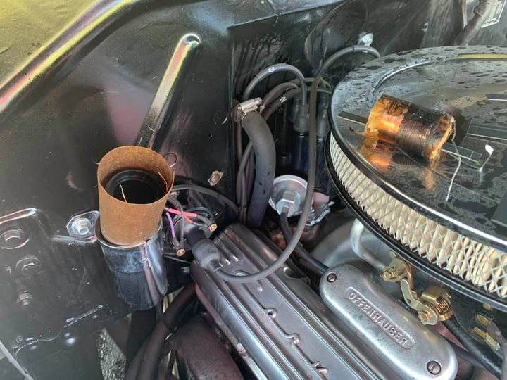

  11. the-rodster
    Joined: Jul 2, 2003
    Posts: 6,945
    the-rodster
    Enough to do this....

    One thing about low voltage DC, even though you dont get shocked by it you do get burned..
