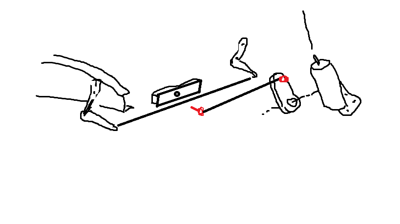

    the gas springs don't need to go past centerline....only near it, unless you want them to actually keep the door closed in lieu of using a latch of some kind.
    What is the green object in your sketch ? Another spring? You won't need one there or the related bellcrank pushing on the upper link assembly.....the 2 gas springs on the lower links will suffice, as long as everything is tied together.
    Suggest making a angle-iron connector between the upper & lower arms (where they are shown in your sketch attached to the door) so that the door is adjustable in the vertical plane, but the geometry of the linkage stays the same. Also makes it easier to get final position.

    Let me review to see if I have this correct...connect the hinges together at the door with a bracket and then mount the door to this bracket so it can slide up and down on grooves cut into it. Similar idea to a GM hood hinge where the hood slides on slots in the hinge, right?
    That is a good idea. I wonder if I can make it fit? There isn't much distance between the drip rail on the box and the door jamb. I only have 5/8" of space to fit the hinges between them. I could refabricate the door jamb panel to make the space wider...I'd rather not as it is already bent up and I don't have access to a sheet-metal brake anymore.
    The green thing is an actuator...just playing with the idea of mounting one so I can open the doors at a push of a button. With actuators, I could delete the spring cylinders.
    I ordered springs with a 60 pound strength, this lead to a 3-5/8" fulcrum to balance the door at 30 degrees of opening (hump point). I am going to return them and order 90 pound springs., this will let me use a shorter fulcrum. A shorter fulcrum means less spring less travel and also a better mounting location to stop the rotation past centerline.

    I was thinking... My first design connects the spring cylinders to the hinges. That limits the "box" mounting locations because I need to stay out of the back 5" space where the boxes will to be notched for the future rear axle relocation. However, if I mount the cylinders on bellcranks welded to the center connecting shaft, then I could move the cylinder s towards the center area of the box. On the back cylinder , I could connect it to the box wall in the 5" notch area. The front mount might be an issue as it is left floating in space.
    By moving them inwards, I gain 5" of box depth to mount them and can build in a lot more adjustment holes. The bar is going to be way up at the top of the box above the drip rail, the brackets would hang down 3"-5" from bar centerline so only a few inches would show when the door is open....worth a thought.

    I did a re-design as shown above and it works SO much better to use the longer struts. I have far more room to mount it without bottoming or being too short. I might do a hybrid of the two designs. one strut mounted on a hinge and the other on the center bar to shift it past the 5" notch.

    One last design issue to tackle. The connecting bar length needs to be adjustable. Too short and it will pinch the upper hinges together, too wide and it will wedge the upper hinge pivots inside the box.

    It shouldn't have to be adjustable once the distances are figured out.
    And, if the "spuds" are made somewhat lengthy, say 1" to 1 1/2" long; the notches in the tube as per your sketch can be made to accommodate them.
    Also, if the connector arms are made with ample length; say 6" or 8" long, then they will flex for any discrepancy when they are connected to the upper arms.....of course this depends on how thick of material is used, but you've got plenty of room.
    However, if there is still a need to make it adjustable, the connecting bar can be 2-piece a'y with one tube telescoping inside the other.
    If round tubing is going to be used, a Coiled Spring Pin (in preference to a Roll Pin) can be used to keep them aligned. The outer tube can be slotted; with just a little clearance for the Pin, and the inner tube drilled/reamed for a nice fit with the Pin.
    Alternately, if square tubing is your choice, there are sources for that purpose, and they fit nicely. The advantage over round tubing being no slots or holes to worry about. Check local steel supplier. McMaster-Carr has some too, see pages 1914-1915

    More good points. I like the pin and slot idea. and it made me think that the connecting bar pieces do not have to be clamped super tight, just made so it won't rotate. Even a polt instead of a pin would work good.
