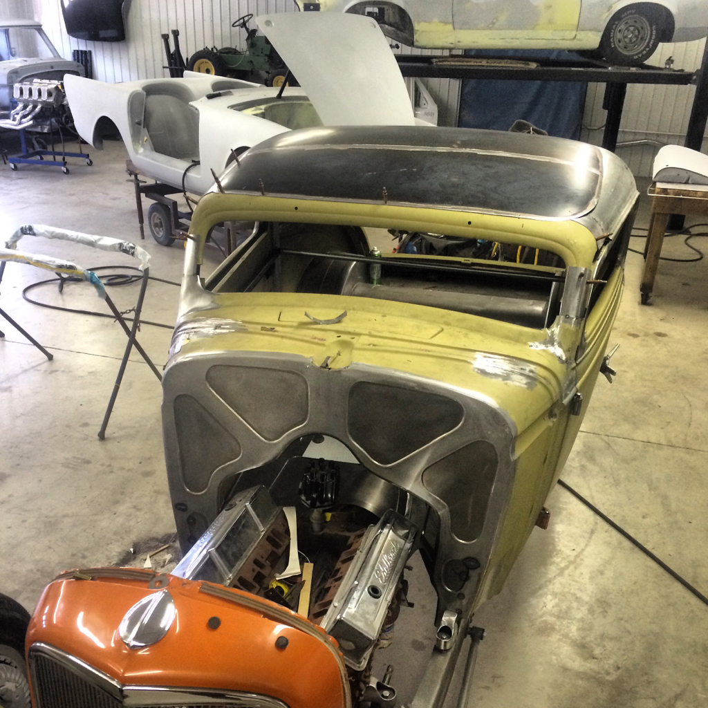

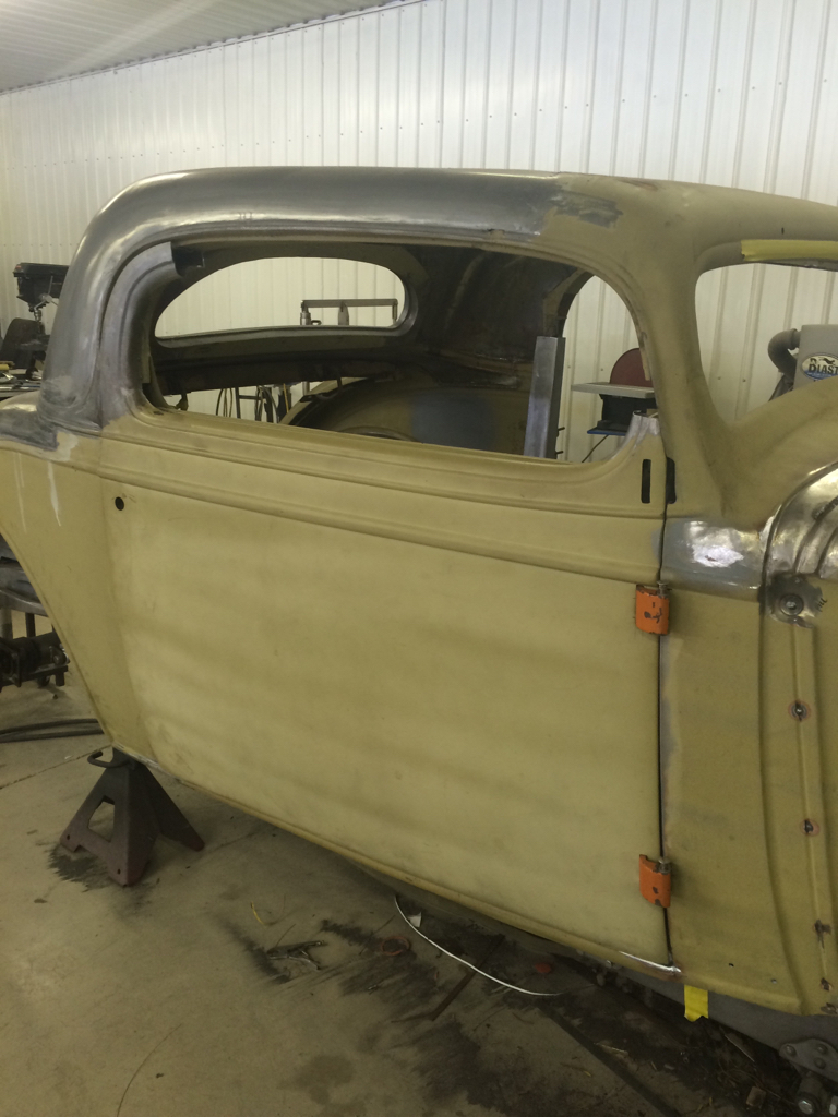

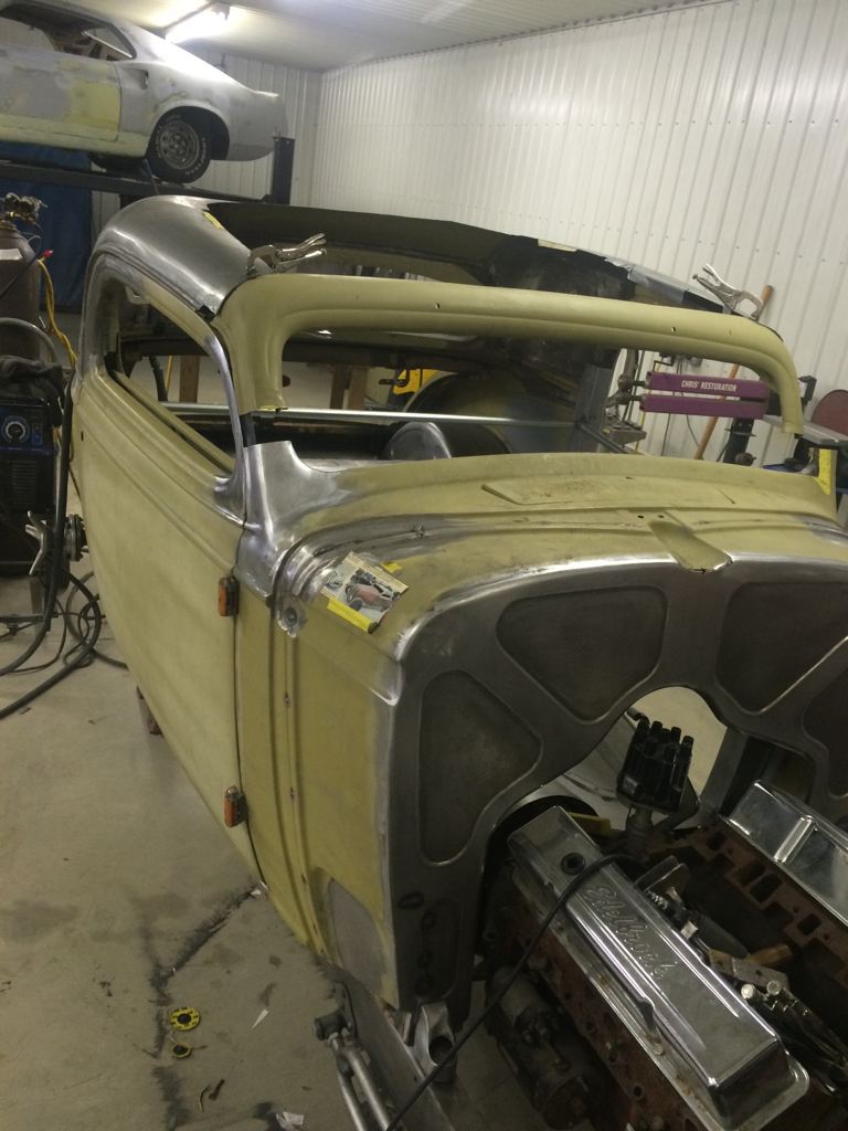

    This started a couple months back when I was asked by Larry Stewart if I wanted to do some metal work on Dave Thomas 35 Chevy 3 window . Of course I said yes . This is Dave's car so I told them to bring it down to the shop . He's owned it for almost 40 years now . It's been all over the place in many different forms . When it came to me .the chassis was already done.it was but by Ionia hot rods and it's a work of art . The body had some stuff done to it but I ended up redoing a lot including getting rid of all the wood inner structure and making it out of steel , finished up chopping the top , filled the roof and the list goes on and on and on . So far it's all in bare metal and debuting it at York in a couple of weeks . Bare with me because I have a lot of photos to post .
    So this is how it came to me .
    ImageUploadedByH.A.M.B.1432255360.543178.jpg ImageUploadedByH.A.M.B.1432255393.708763.jpg

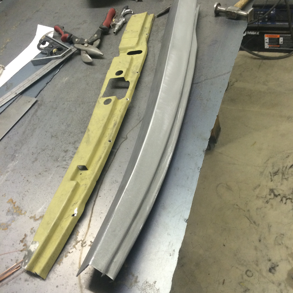

    ImageUploadedByH.A.M.B.1432255540.410656.jpg ImageUploadedByH.A.M.B.1432255604.742151.jpg I ended up making all the new structure out of 14 gauge ImageUploadedByH.A.M.B.1432255674.381406.jpg

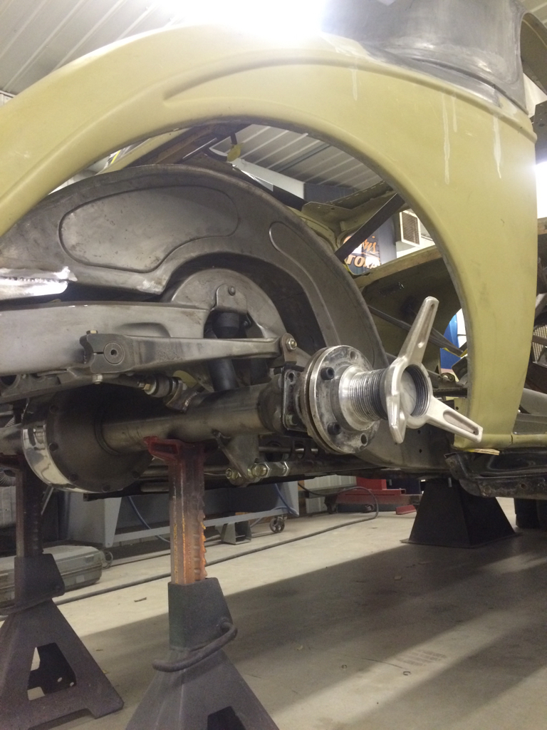

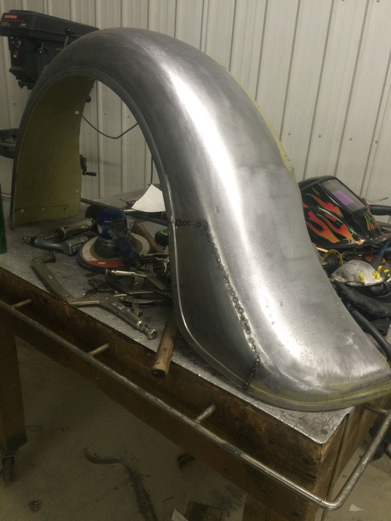

    ImageUploadedByH.A.M.B.1432255887.996186.jpg btw Butch Lloyed started the floors and I finished them ImageUploadedByH.A.M.B.1432256049.694783.jpg and I finished up the wheel tubs as well . ImageUploadedByH.A.M.B.1432256124.331267.jpg

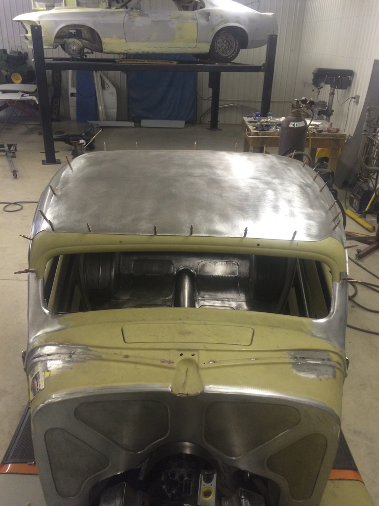

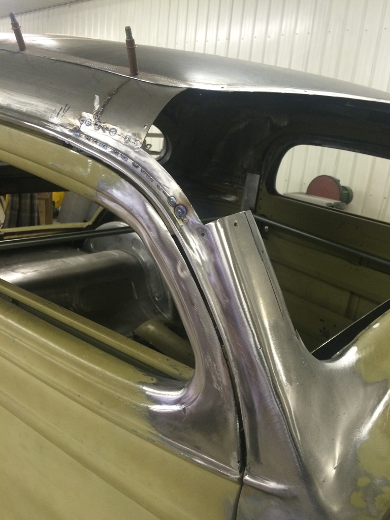

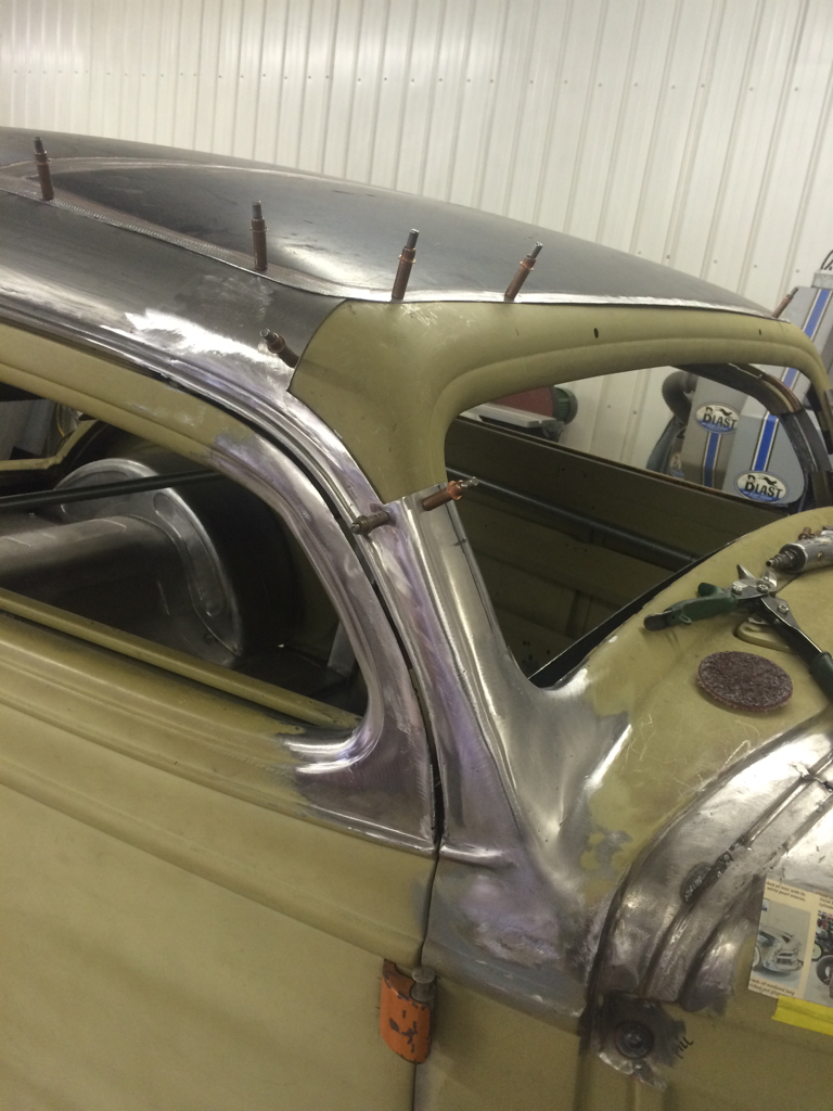

    ImageUploadedByH.A.M.B.1432256459.478920.jpg ImageUploadedByH.A.M.B.1432256507.627660.jpg now onto chopping and filling the top . This will be the third time that this car has went under the knife for the roof . The chop was starting else where I ended up bringing the front down about an inch and a half more then filled the roof using a 54 Chevy roof that I ended up taking a foot out of the center

    ImageUploadedByH.A.M.B.1432257385.830424.jpg starting to fill the roof
    ImageUploadedByH.A.M.B.1432257441.351976.jpg tacked in
    One continuous weld pass only stopping to grab more wire
    ImageUploadedByH.A.M.B.1432257577.995592.jpg metal finished to some extent

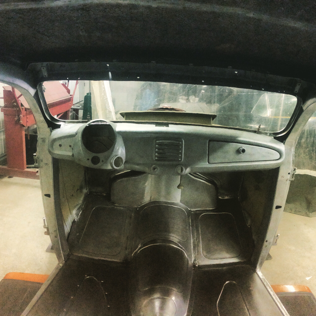

    ImageUploadedByH.A.M.B.1432257743.541240.jpg ImageUploadedByH.A.M.B.1432257793.396266.jpg ImageUploadedByH.A.M.B.1432257832.250135.jpg ImageUploadedByH.A.M.B.1432257878.418111.jpg ImageUploadedByH.A.M.B.1432257957.425688.jpg started cutting down the Nash dash

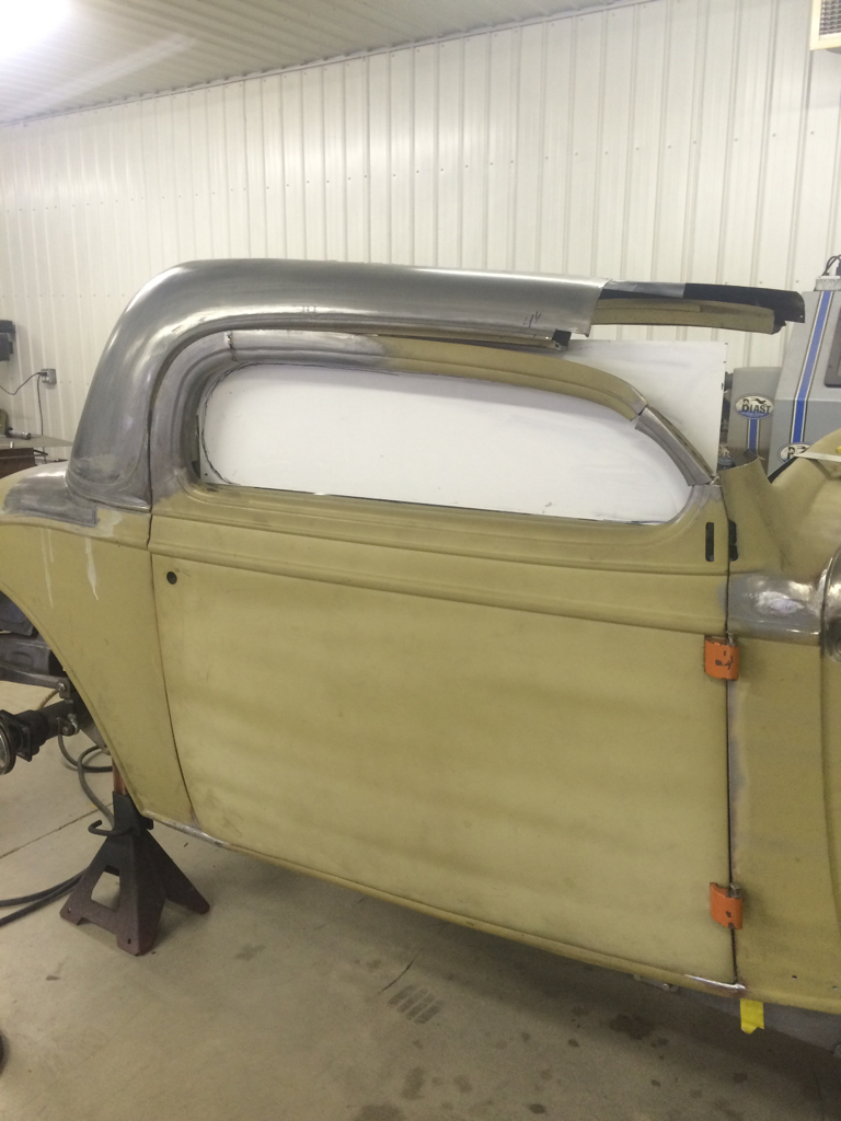

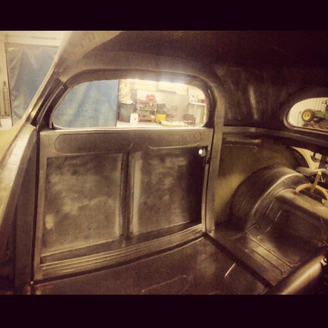

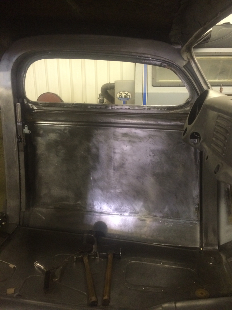

    ImageUploadedByH.A.M.B.1432258346.621766.jpg ImageUploadedByH.A.M.B.1432258393.491814.jpg ImageUploadedByH.A.M.B.1432258449.580559.jpg the doors were bad as well so I decided to make all new inner structure as well ImageUploadedByH.A.M.B.1432258532.219408.jpg

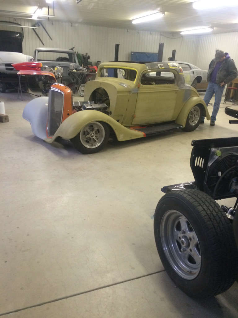

    ImageUploadedByH.A.M.B.1432259493.062825.jpg ImageUploadedByH.A.M.B.1432259505.930261.jpg ImageUploadedByH.A.M.B.1432259520.265125.jpg ImageUploadedByH.A.M.B.1432259531.815126.jpg and this is where I finished off today
