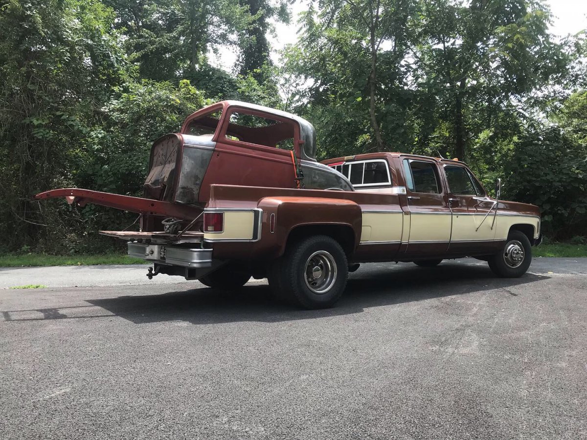

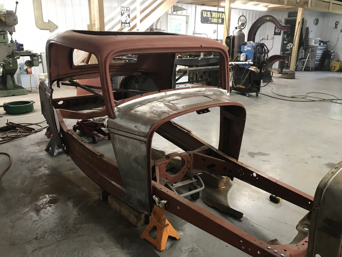

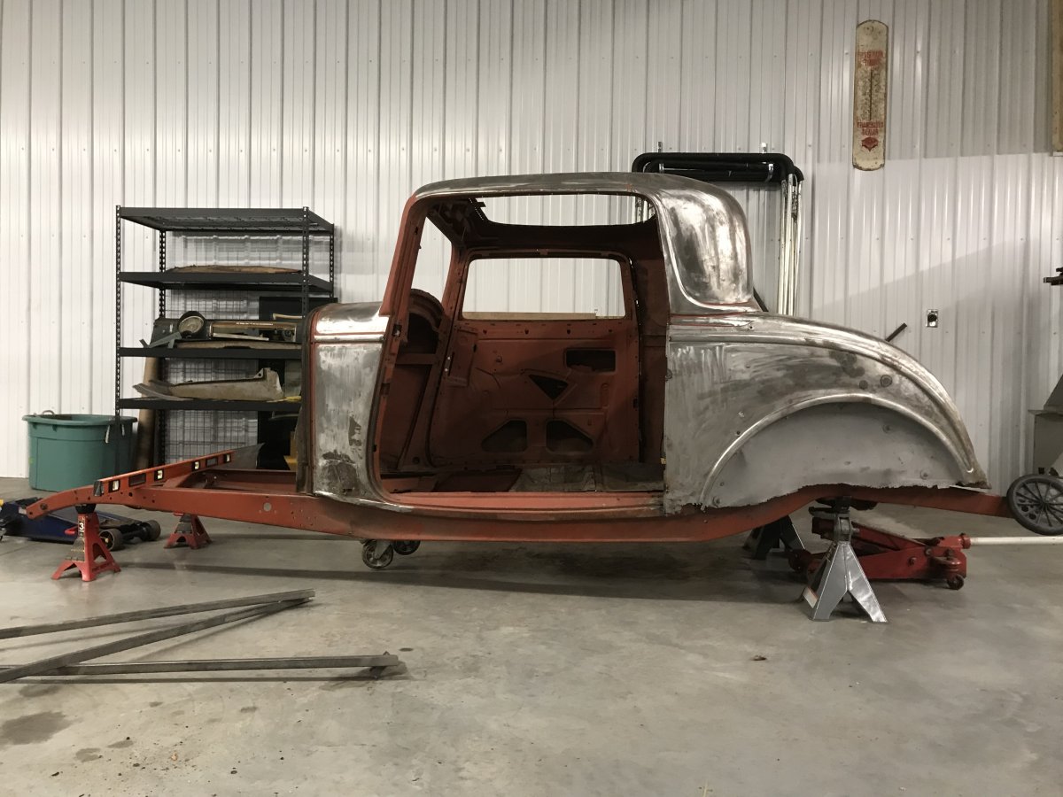

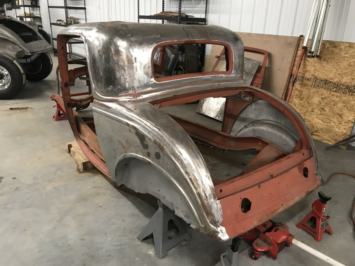

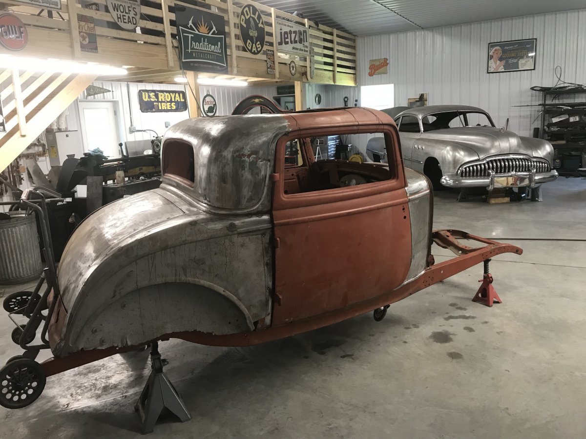

    Here it goes , with being from the east coast I’ve always had a love for Traditional east coast hot rods , heavy channel , no chop bare bones hot rods .Ive been Dreaming about this project for over a decade. Actually while I was building “The Wagon “ collection small parts here and there .but it was never the right time or place to get a body . I always knew some day I would get around to this build of my own I just never knew when . I always Knew in the back of my mind it was going to be a 32 Ford 3 window coupe , heavy channel no chop , Wayne powered inline 6 . For the past decade I’ve been vigorously searching magazine, the web and anything I could find that had to do with channeled 32’s ,my favorites are Bill Kelly’s coupe before it was chopped, Tuffy , golden rod , Ricky Nelson Roadster and the list goes on .........

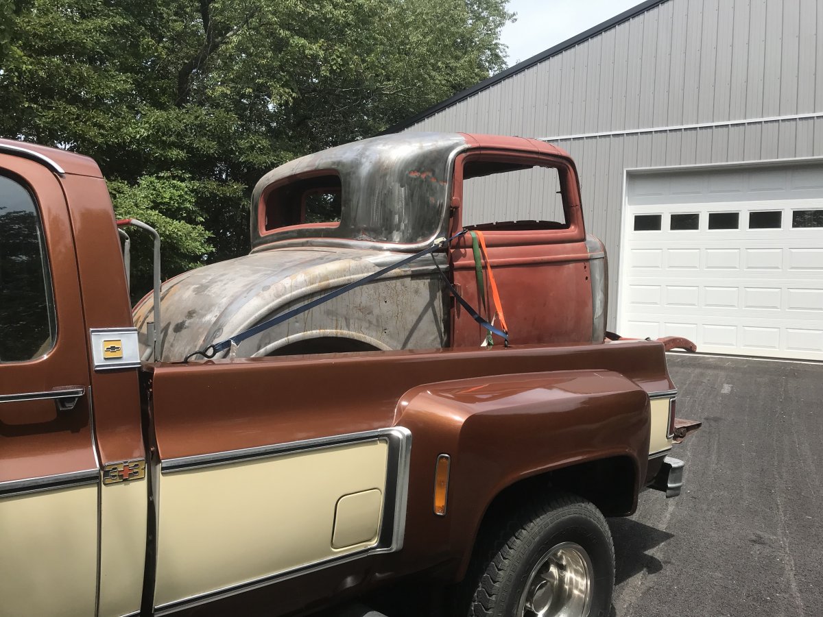

    So a Couple of month ago , I sold my Running driving beautiful 59 Buick electra in hopes to Buy a Really nice 54 Nash-Healy another Dream car of mine , but the Deal fell threw And my wife said why don’t you start you 32 project, and at the moment with 8 customers projects going on at my shop I didn’t want another one , but as time went on and the more and more I thought about it , now is the right time . I searched everywhere for a body . I was even thinking about a brookville if nothing came up. But I waited and waited ,losing hope at time that a real 32 would show up. Then I got a Text message from a buddy of mine Mason Dyer saying” have your seen that coupe I tagged you in on Instagram for sale “ immediately I jumped on , contacted the seller and 5 min later the deal was done . After a month trying to sort out shipping it finally arrived Sunday and I’ve already started cutting the car apart .

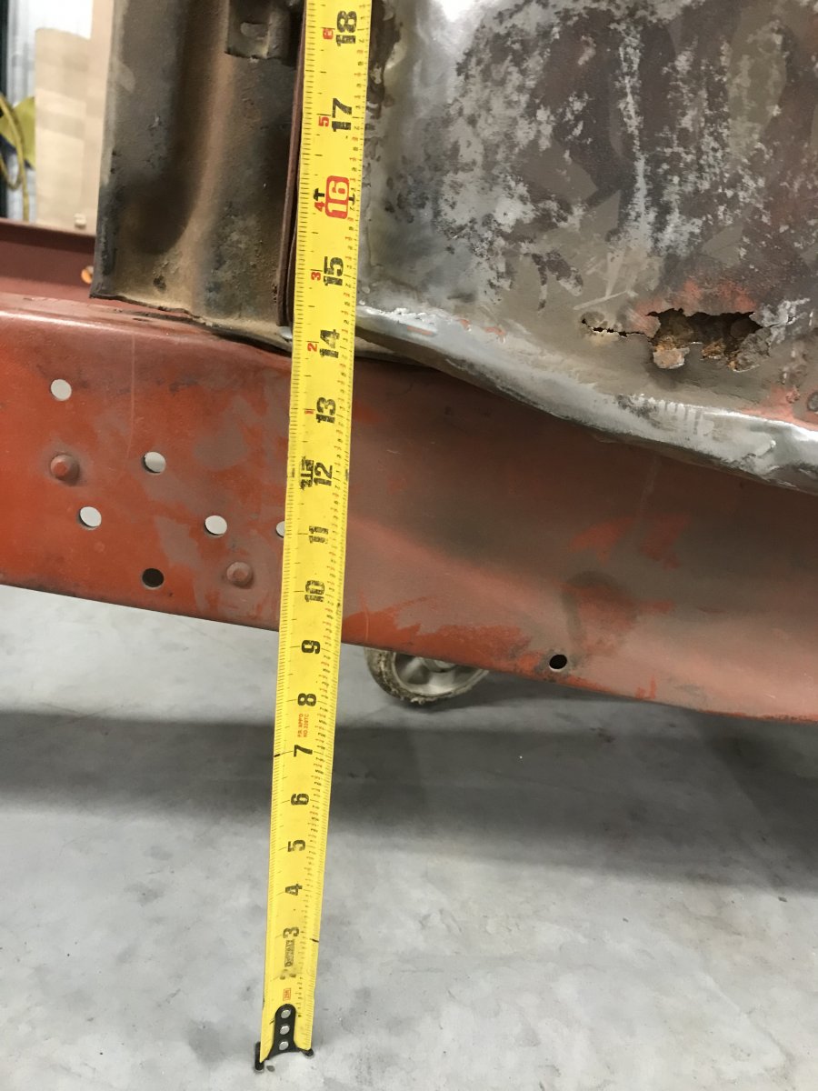

    Here’s part of a sneak peak of what the Coupe is going to look like when it’s done . I had my friend Eric Black do the rendering , when He does his renderings they are to scale . And he was able to figure out that I could channel the coupe 9” and I still would be able to fit comfortably.

    Here we go! I'm pretty sure I can't fit in a 9" channeled 32, but I do love them.
    Sidebar: If that is your squarebody crew dually, I'm jealous. My wife does not think I need one.:(

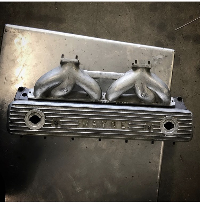

  15. Just beautiful. The Wayne 12-port will make it really stand out.

    Yes that’s my dually .

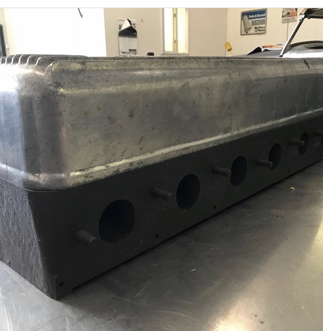

    Subbed. Any history on the Wayne head?

    I bought it off of eBay , about 5 years ago . It came from the mid west . The guy I got it from said he found it on Craigslist and some dirt track guy had it laying around before him . The head number is #1119 . Which means its the later 11 series head . It originally came with a 3 log intake manifold and turn down exhaust manifolds . I traded Zeke Zackerson the 3 carb intake For the Side draft intake because I knew I was building a channeled car and I didnt want the the carbs sticking above the cowl . I wish I had more history on the head . And honestly the head looks like it’s barely been used .
