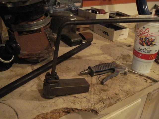

    Got one sent you a pm. also have a raduis cutter gizmo I made for the lathe I will post some pics of both tomorow.

    Heres a radius cutter that I built to cut the wheels. It works ok, the bigest problem was keeping the chips out. I ran the lathe in reverse and flipped the tool bit upside down to help clear the chips out. [​IMG]
