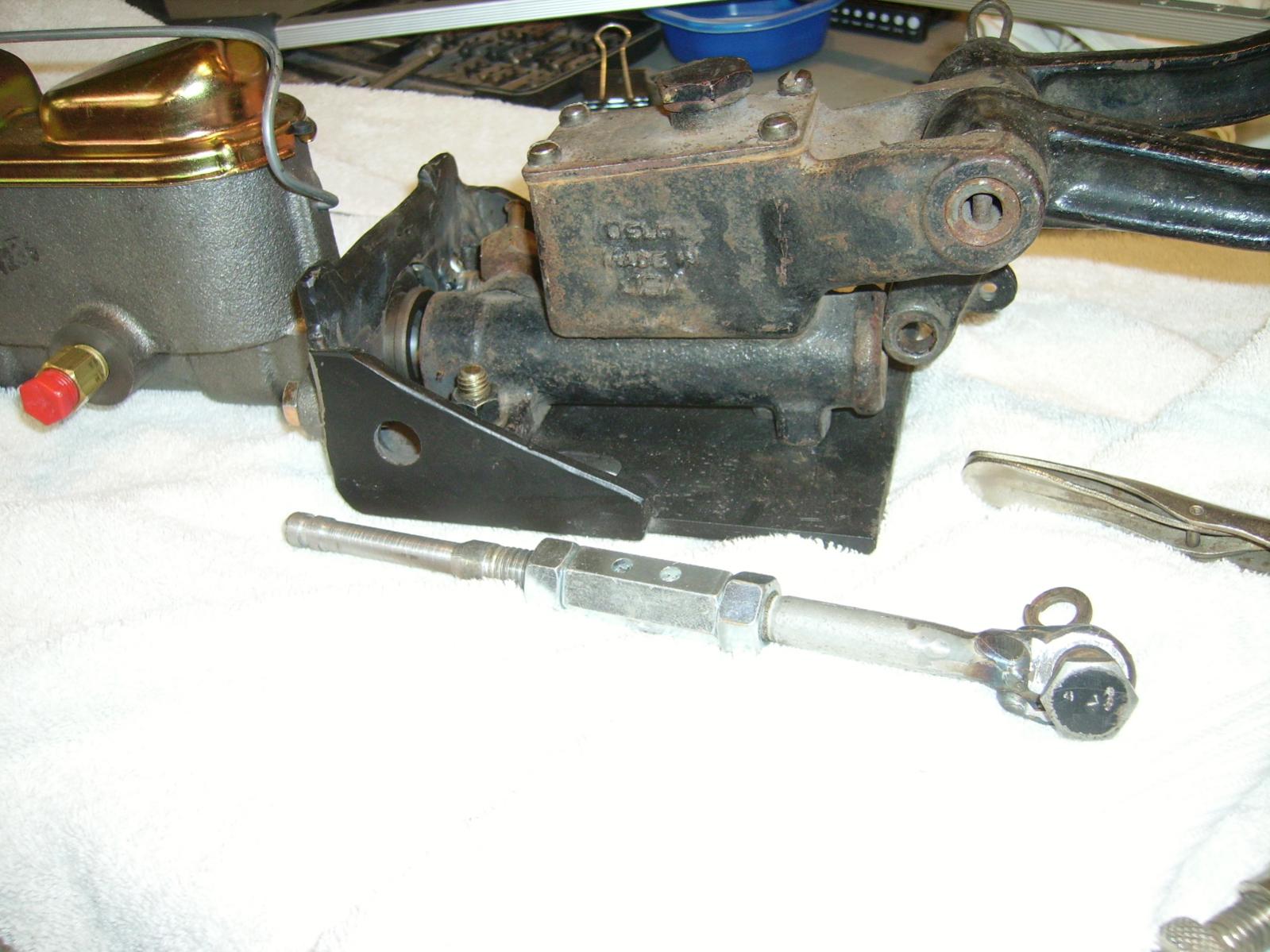

    I hope these pictures will help you, slightly different, 38 Chevrolet but I suspect that your brake/clutch unit are about the same (I've got one -48 Chev- but didn't go dig it out to look at it). I had two or three Z bars laying around and the one I used required a cut to clock both levers to match. I fabricated a rod to go from the Z bar to the clutch pull arm and another adjustable push rod for the throwout arm. I used the original steering box mounting holes for the up right for the Z Bar.
    Not sure what you are doing with the brakes, but I adapted a Mustang II Master Cylinder to the org MC using a home built bracket and brake push rod. I am using a Lakewood Scatter shield and side mounts on the engine and a rear transmission mount.

    thank you good pictures the 46 steering box is farther forward for the original front suspension i am useing thanks for the pictures
