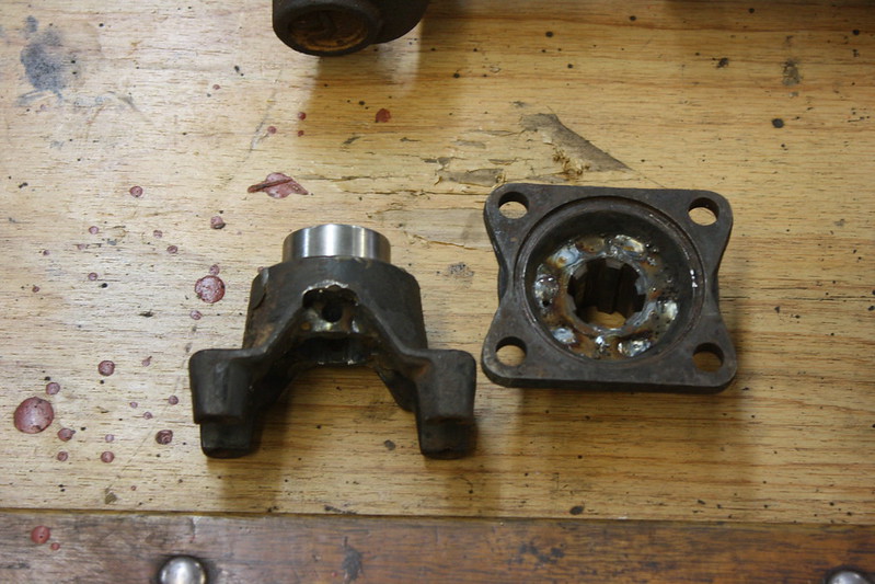

    Easiest is to find a ‘42-47 Ford PU rear. But have also read that other methods work, with machining an adapter and using a seal, etc. pretty sure kits are available, but don’t recall who from

  4. As Budget36 said, 40's Ford pickup rear end parts... or buy one from Hot Rod Works or other vendors.

    For converting to open drive Hot Rod Works is the only way to go. Stay away from the cheaper kits.

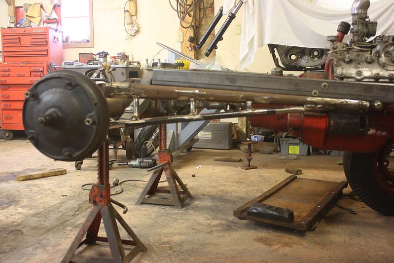

    What I did on the mid engine street lakester built for a friend....All made from parts laying around an some lathe work and welding. It doesn't leak or vibrate but this car doesn't get a lot of miles....

    Dude I may have to" steel"your idea on the rear ladder bars you made that is a dope idea why did I not think of that. That is exactly the idea I needed. I hope you do not mind but I love the look of that. And it is a period look. I'm building a 32 mid engine potvin blower set up. You can check it out in build threads 32 gbones32coupe

    Dude do you have a build thread on This car I'm intrested pm me or post more pic of the car I could not find it. It's cool man love it

  18. Truckedup
    Joined: Jul 25, 2006
    Posts: 3,962
    Truckedup
    It the car is in a lakester build thread here about 5 -7 years ago. unfortunately, a lot of the build photos were lost in a computer fuck up...There might be a few more , I will have look for them. The same car is my avatar.

  22. If the 40 Ford rear is a truck rear you will need a machinist that knows his shit. In the truck rear the pinion and the driveshaft was one piece.
    Other wise you can get the parts you need from Speedway as a kit. I know that is whimping out but it is the easiest way.
