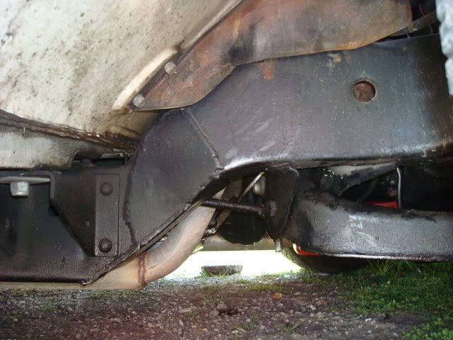

    I put a Camaro Clip in my '60.
    I trimmed the outsides of the ends so the clip would slide inside the truck rails.
    And I lined up the lower part of the clip ( the horizontal part that normally bolts up under the Camaro ) with the inside lower edge of the frame.
    If I would do one again, I'd probably space it away an Inch or maybe even two.
    ( I still need to be able to drive on a dirt road... )
    i'm also using big block springs, which didnt affect the rideheight but they did help with the tires rubbing on the inner fenders, when going through a big dip.
    Also, if its that low, the front wheel offset gets pretty critical.
    To much, and it will rub on full lock...
    And I took plenty of measurements to make sure it was square, straight, centered, had the right caster, and I welded it with strengthening plates over the joint, etc...
