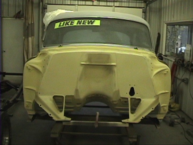

    I completely removed the ribs and then smoothed the firewall on the 54 I am building for my wife. I am painting this firewall this afternoon. I will try to post a picture but it is not a good one. The dark shadows on the primer are the guide coat that I have been sanding today.

    i'm working on 54 myself and i'm gonna cut them out and smooth out the firewall. just the way WZ JUNK did his wifes car.

    Clean work, WZ. What steering are you going to use on your wife's car?

    Using a Chevy van column. I made a polished aluminum cover for that odd shaped hole you see in the firewall. It covers the part of the hole not filled by the column and it is the lower mount for the column. Car has Mustang front suspension and a Lincoln disc brake rear. I am using a throttle body injected motor. I painted the firewall yesterday. My son should be home with the camera this afternoon and I will try to take another picture.
