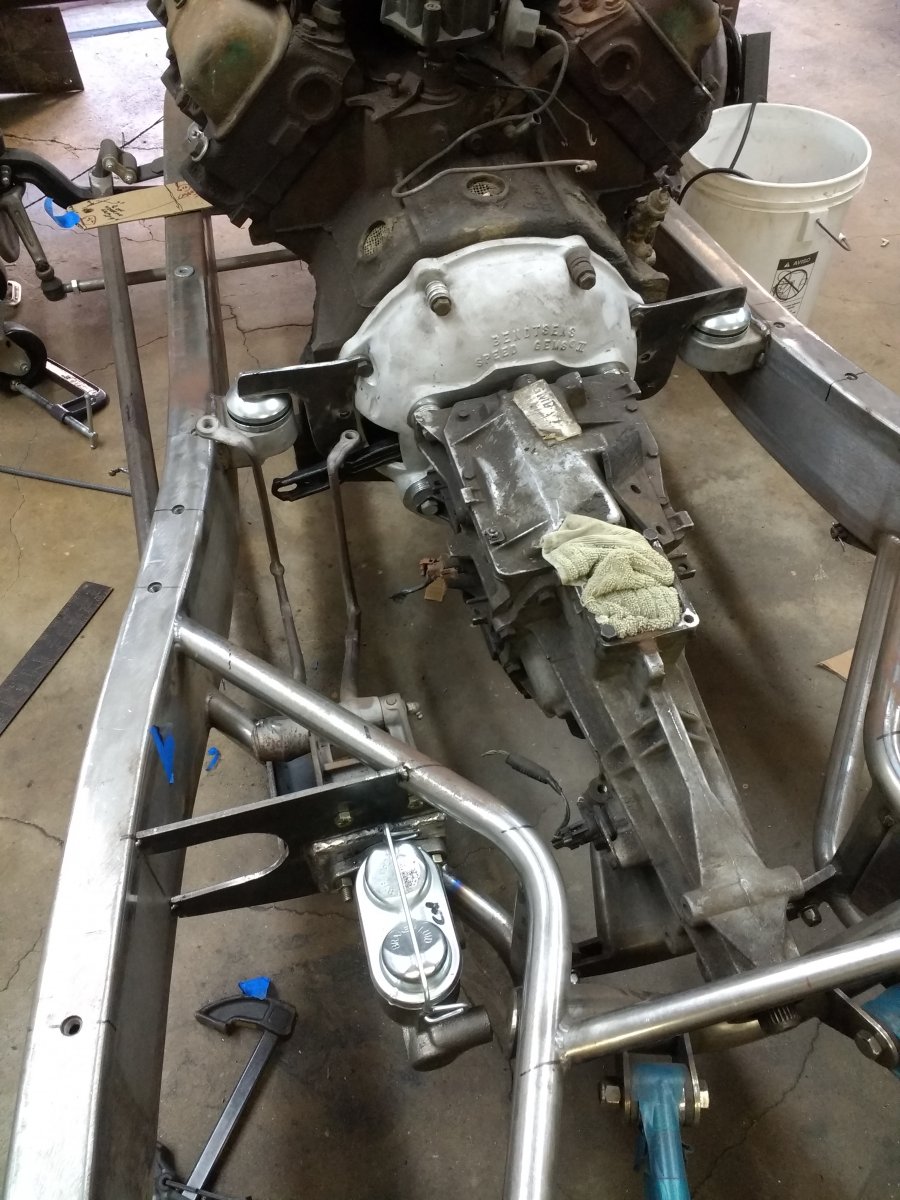

    I pulled the body off the frame so I could finish the body work and do some additional work on the chassis. I got the F1 pedals and master cylinder mounting figured out. I also got the rear motor mounts figured out and fabricated.

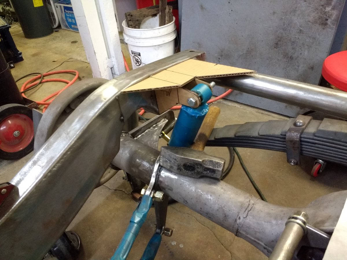

    Mocked up the rear shock upper attachment. My rear spreader bar was not set up for this and I ended up needing to mount the top of the shocks up tight to the bottom of the body to get the shock travel I needed.
    Seemed to work good so fabricated the mounts out of 3/16 plate and got them tacked in.

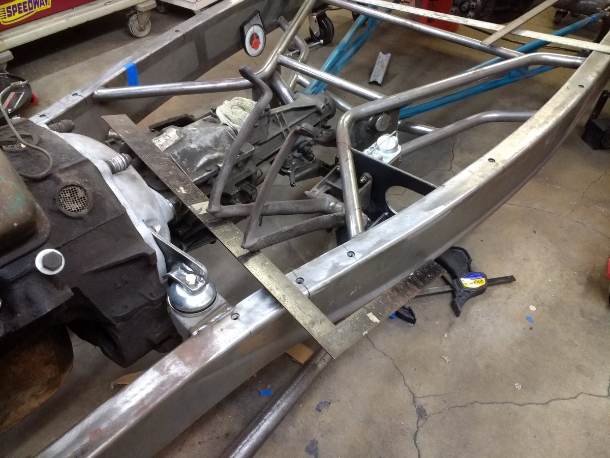

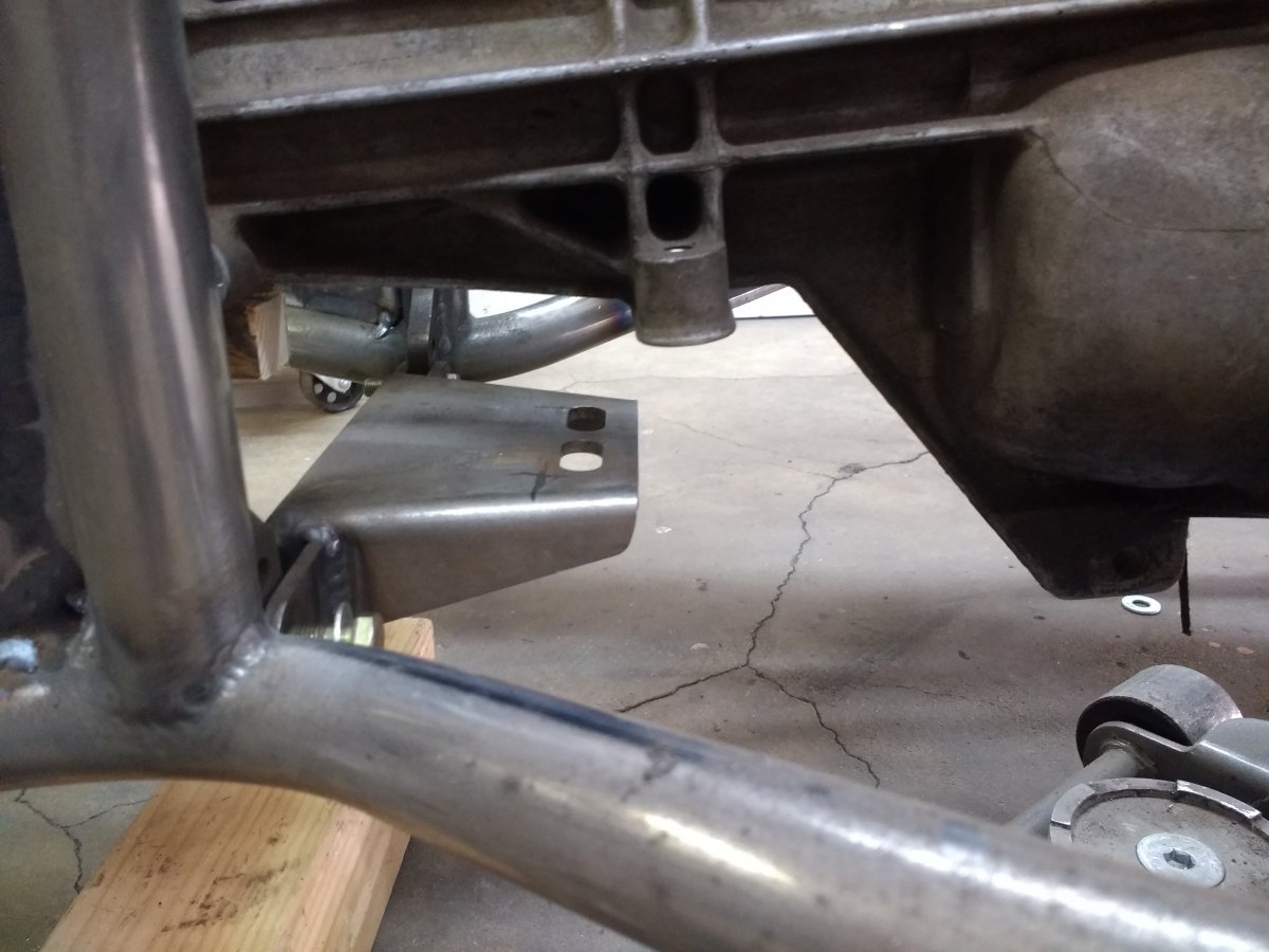

    The trans mount set up that came with the frame was back to far and was already cantilevered more then I liked so did not want to add on to it any more.
    I took the existing mount plate and recycled into a new mount.
    That is temp mock up mount block in the above photo as the trans will move forward a little once the crank is drilled for the pilot bushing then I can install the rubber trans mount block.

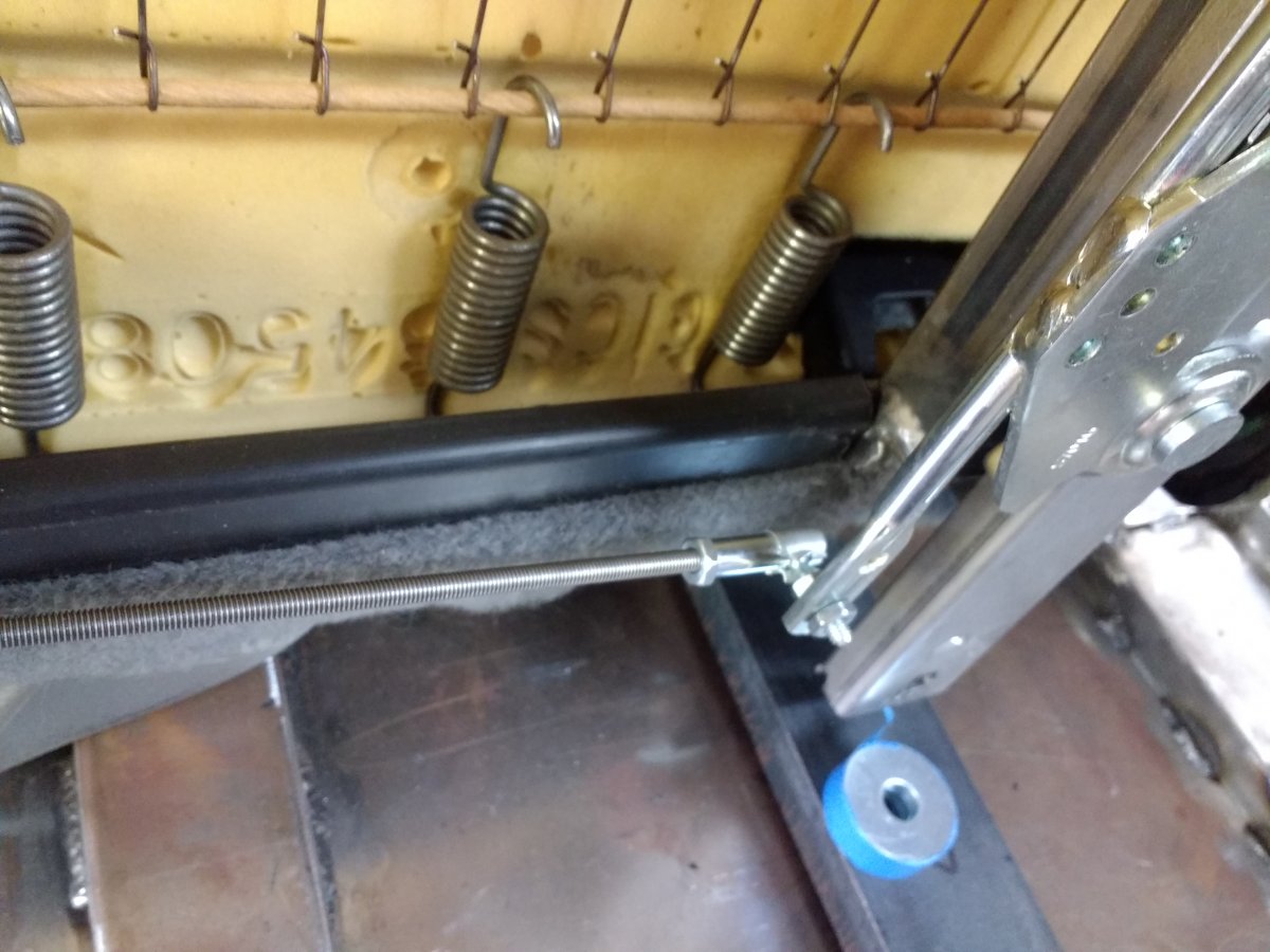

    Played around with the seat to see where I liked it and built some brackets to install the seat slides. The existing mount holes in the bottom of these mini van seats are offset to one side and not evenly.
    I used some all-thread and small ball joint ends for the connector rod. The slides have to sit on 1/2" risers for the moving parts on the bottom of the sliders to clear the cross members.
    With the seat bolted down the seat slides really good.

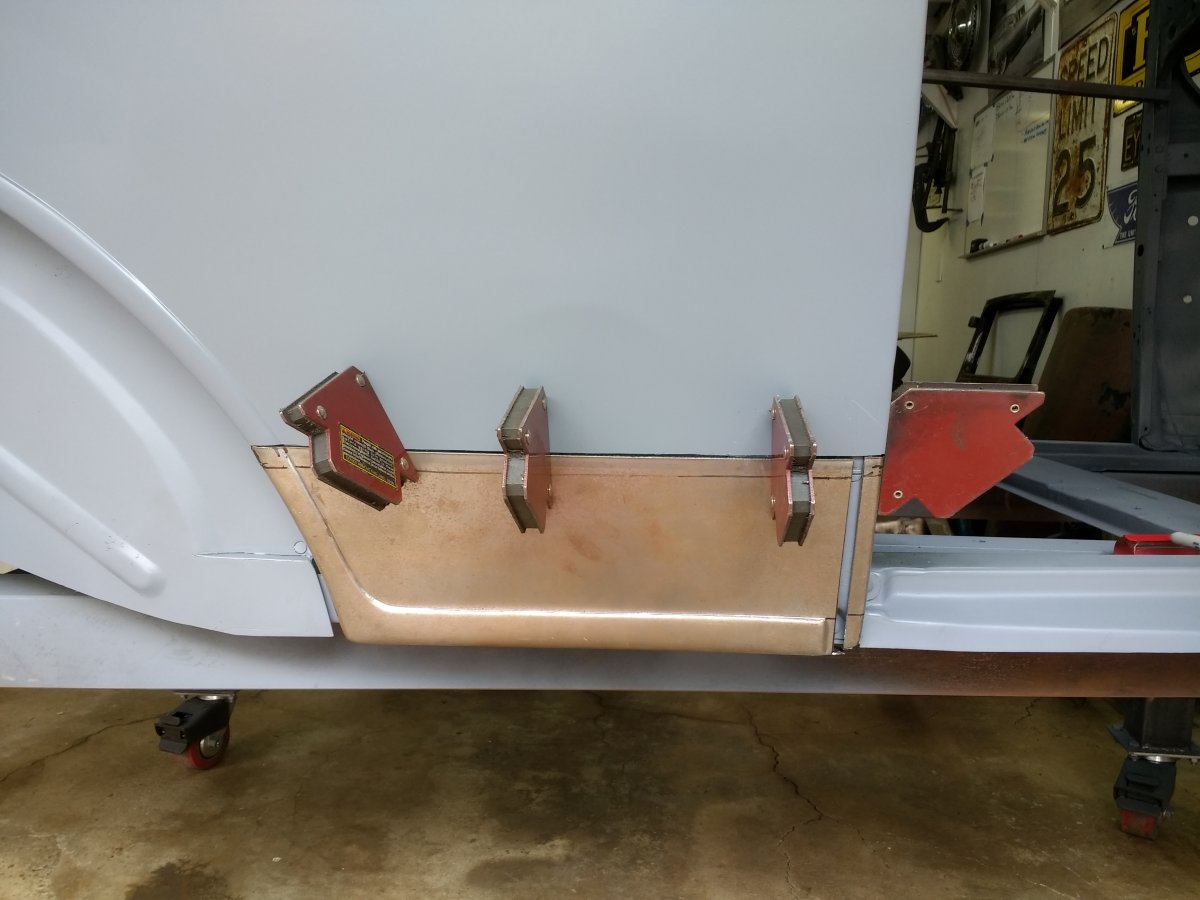

    The bead on the rear quarter patch panels matched well but I found that these patch panels were about a 1/4" to short to fit my car so had to extend them.
