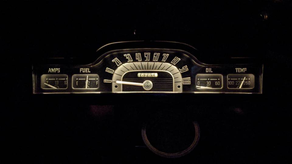

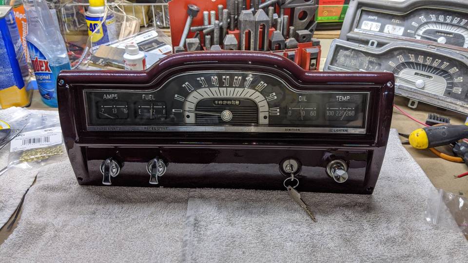

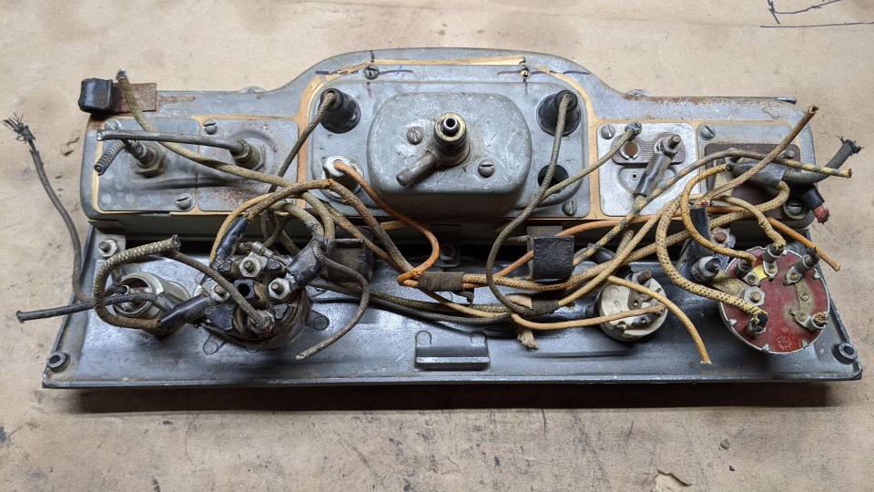

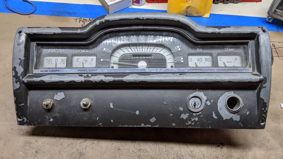

    I have been working on rebuilding my gauge cluster off an on the last two months. I am using a 1951 Plymouth cluster and wanted to update it using mid 80's Camaro volt, temp, oil, and fuel gauges. Fitting the replacement gauges was not to hard but I had been stuck on making new gauge faces. Here is what I started with.

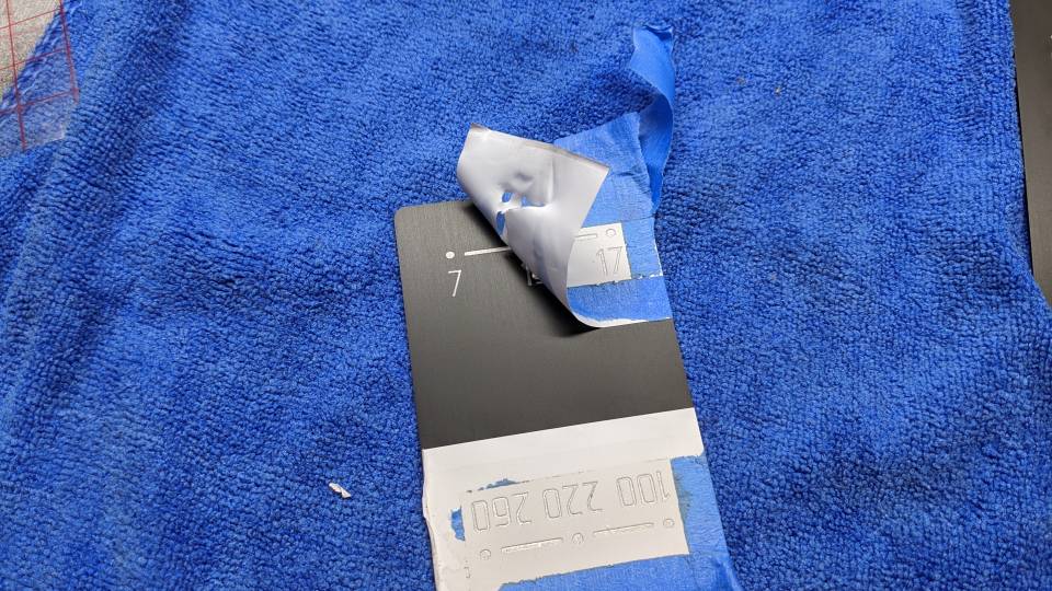

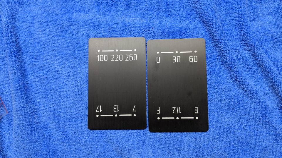

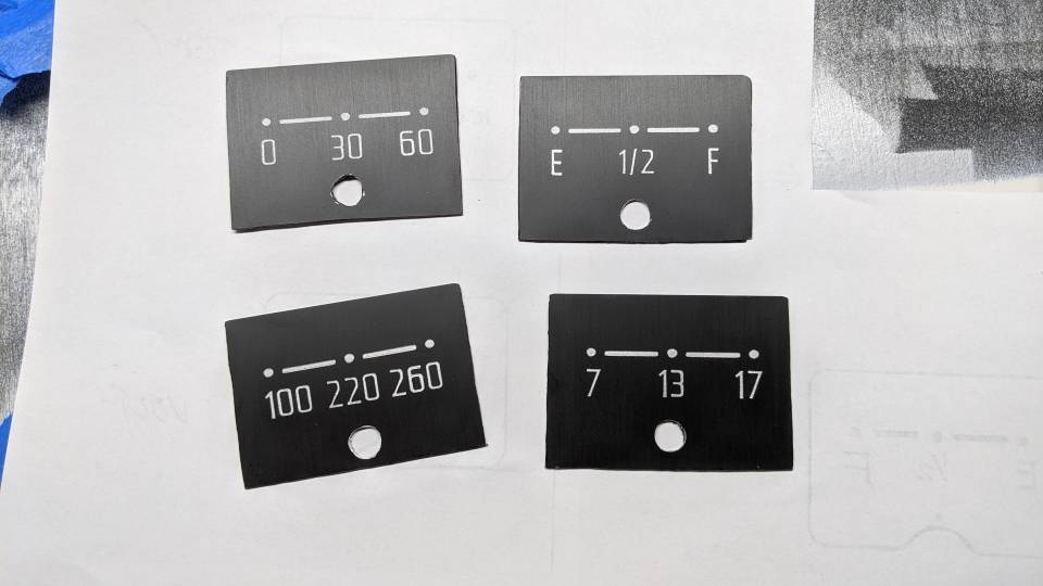

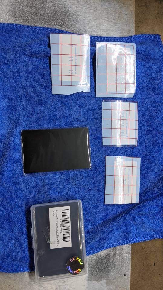

    My artsy daughter recently puchased a Cricut machine which looks like a computer printer but has a knife and cuts fairly intricate designs in paper and vinyl. I figured she could cut me vinyl stickers that I could use as stencils. The early attempts with painting the dial faces using the stencils did not turn out as well as I wanted. I ended up getting the best results by using the vinyl stencils on black anodized aluminum and bead blasting.
    IMG_20200625_115021.jpeg IMG_20200625_122055.jpeg IMG_20200625_122449.jpeg IMG_20200625_144109.jpeg
    Here is what I ended up with.
    Sent from my Pixel 3a using The H.A.M.B. mobile app

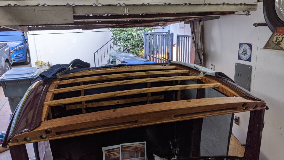

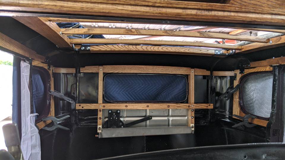

    You don't know what you don't know. I was working on getting my visor and the header metal that is under the visor installed and figured out that my new wood header was too tall in the front and needed to be tappered down in the front. Fortunately I had not nailed any of the metal in place was able to remove the header with out a lot of work. IMG_20200701_161708.jpeg

    I had to cheat a little bit. The voltage gauge should read 8 to 18 but we could not get the Cricut to cleanly cut the small 8s without moving the small inner circles out of place.

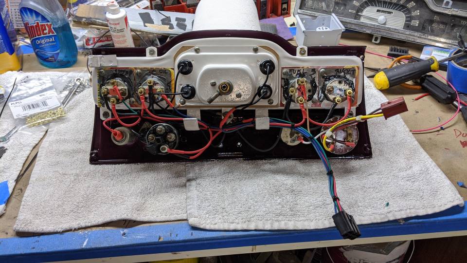

    I had to come up with a filler panel for the middle of the dash. I ended up making one from a piece of ribbed aluminum cut out of a old piece of a shower door header.

    What type of bead did you blast this with this? We have a Cricut as well and I am always looking for new ideas. Yours turned out really nice and crisp.

    Here are the glass beads I used. I tried the aluminium oxide that was in the blast cabinet first and it ended up leaving a dust under the tape edges that scratched the finish. IMG_20200710_101706.jpeg IMG_20200710_101725.jpeg
