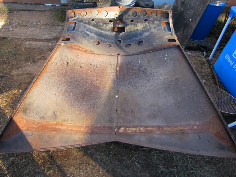

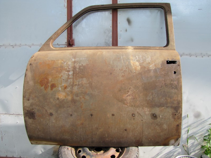

    Citric acid is great stuff, i have used it with good results. I bought a kid's pool and made around 220 gallons mixture of that stuff. Its a lot, but i needed that much to get shoebox hood and NOS door cleaned from surface rust. It works fine on sheetmetal, but springsteel gets ruined with citric acid.

    This how i do it:
    1. I rinse all the loose dirt or use degreaser to get all the loose crap out of the piece.
    2. I sunk the the piece in citric acid mixture and let it be there over 24 hrs, it doesnt hurt if its there a bit longer.
    3. I rinse the piece and brush it with steel brush. This will make the process faster. I used a powerwasher on those bigger pieces i did. Powerwasher is good way to clean them, but not so handy on smaller pieces.
    4. I sunk the piece again in mixture for next 24 hrs or so. Usually these 2 baths have done the trick. If not, i repeat the rinsing and bathing the piece.
    5. I rinse the piece again and if i am happy with the result, i make sure its rinsed properly and dry the piece with a heatgun. The heat will neutralize the acid. After it is dryed and cooled down, i spray primer on the piece. If you leave it after drying it, its starts to get rusty again.
    I hope that helps.

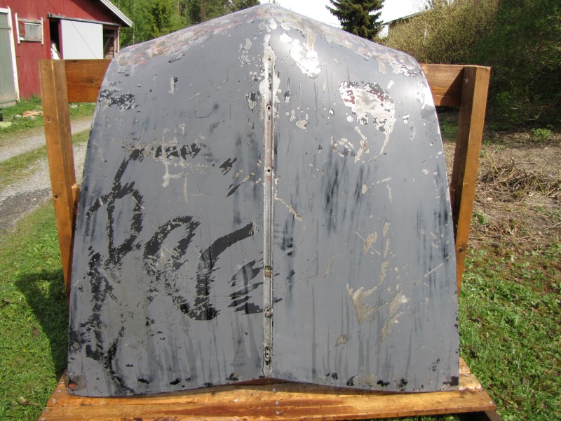

    Its not that strong, i use 5% mixture. Some people have suggested that 7% is a correct mixture and other say that 3% is the most effective. So i have used something between them, that 5% has worked fine with me. I have also heard that heating the mixture will make it more effective, but the process has been fine without any extra heat.
    Like i said, that headliner bow failure is completely my own mistake and its my only bad experience with citric acid. It was a huge WTF moment, when i get them out of the tank. I noticed that i havent get rid of those yet, i dug them out of the junk pile and took a pic. The thicker one is near std size and those welding wire looking things are what are left of my headliner bows.

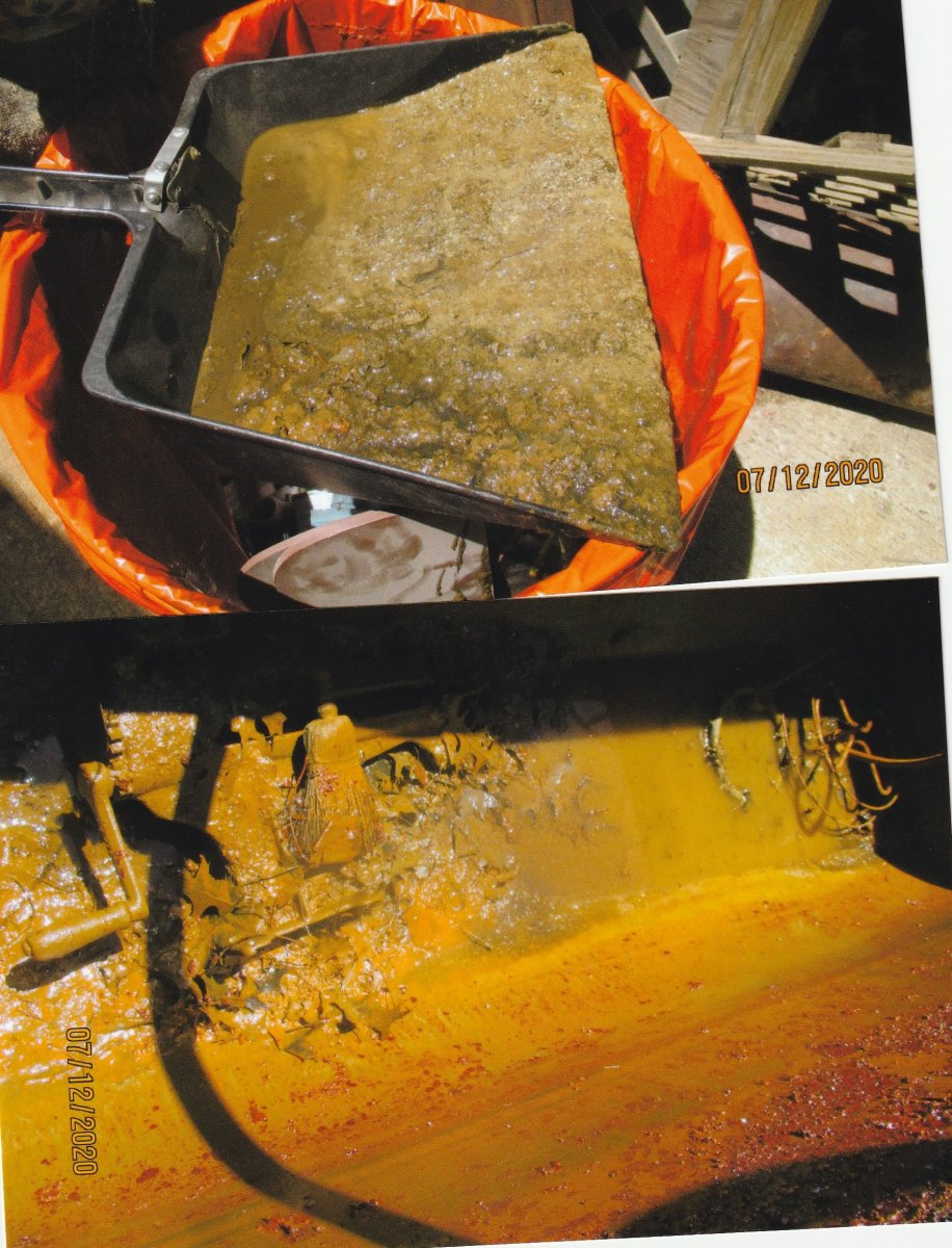

    Draining my IMG_20200712_0003.jpg IMG_20200712_0004.jpg IMG_20200712_0005.jpg 3 year old batch. And in with the new.
