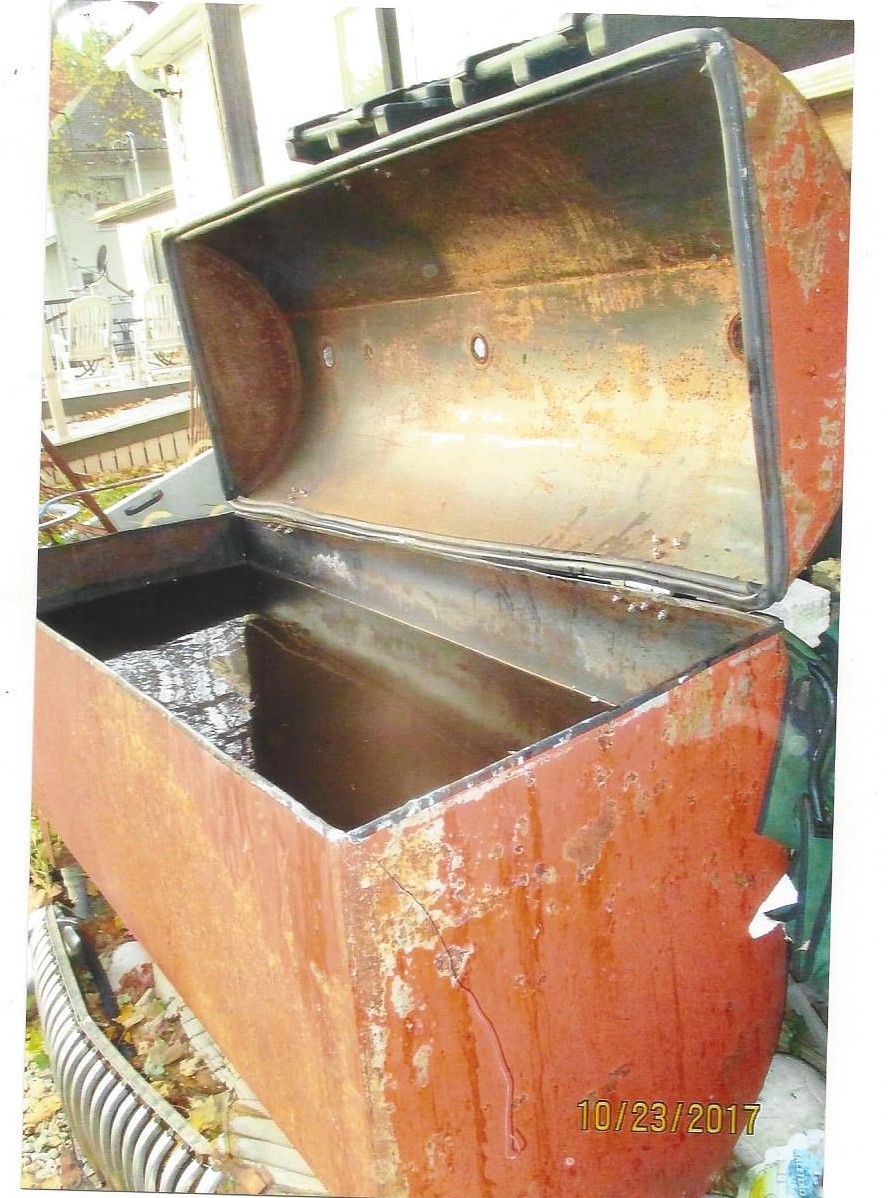

  18. Barrelnose pickup
    Joined: Aug 20, 2008
    Posts: 1,059
    Barrelnose pickup
    ^^^^ This is what I used. Cut the top out and attached back on with hinges and a handle.
    The top helps to stop evaporation.
    I run a couple of bars side to side and hang the parts off wires so they are off the bottom.
    It does a great job.

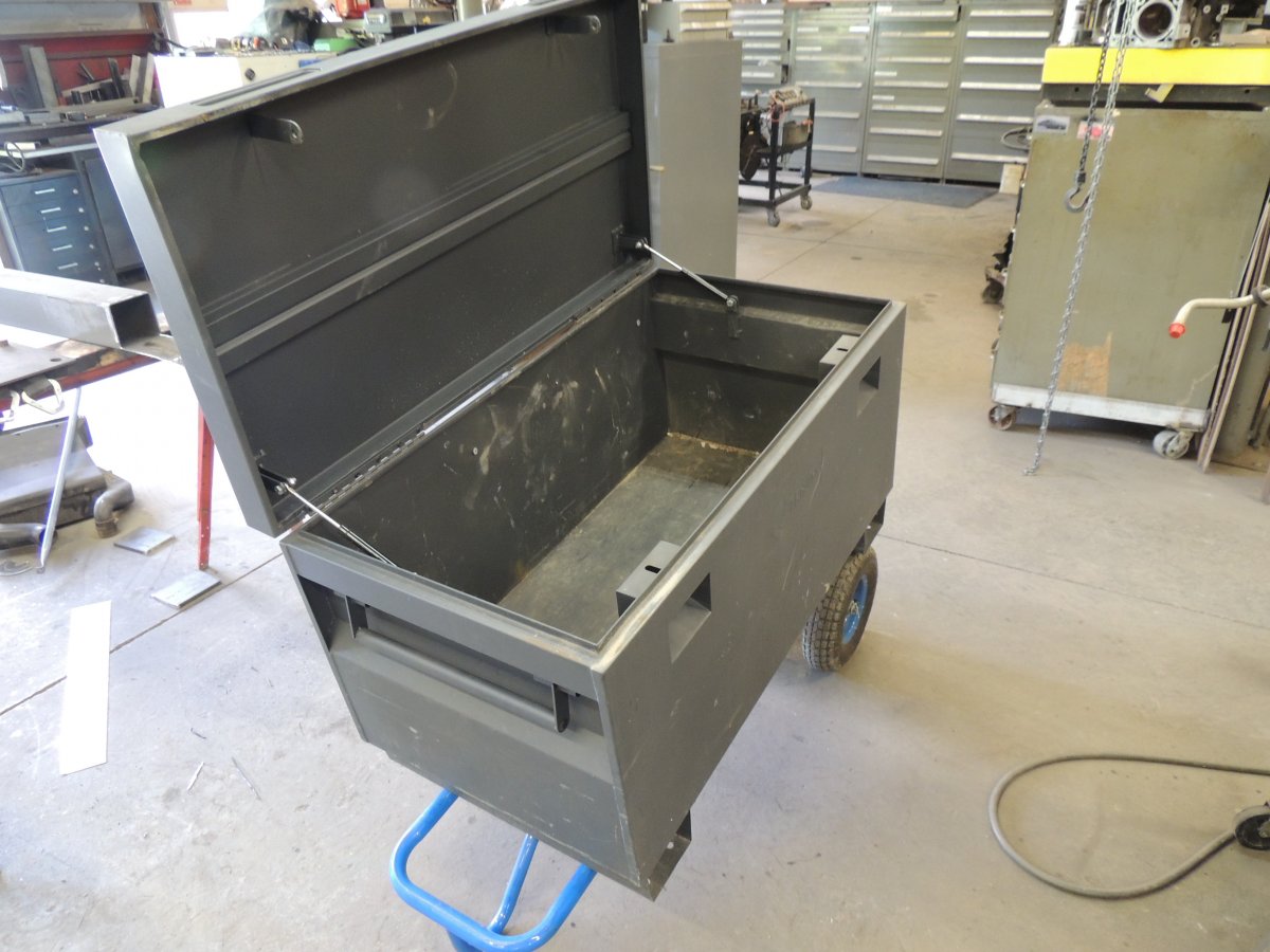

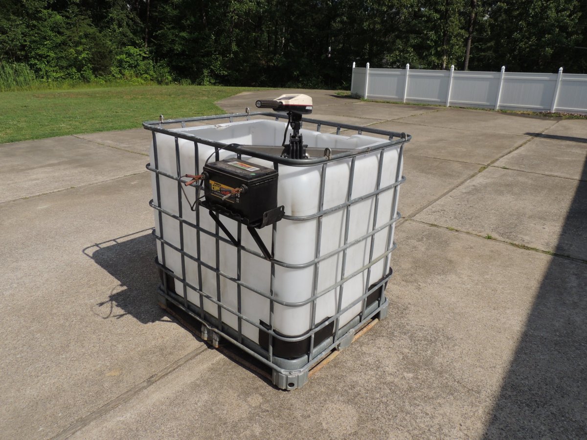

    Here is what I have been cobbling up to derust parts as a couple of posters have mentioned above. Should be able to put some large stuff in as well as the smaller stuff. I have a couple of engines that I want to insure I get all the rust build-up out of the water jacket before moving on to a final clean-up. I attached a battery tray from a 90s (?) Ford pick-up because it was the right shape and size. That allows me to either switch to electrolysis later if I want, but also to power a small trolling motor. I figure since the water jackets may have pockets of rust inside, I want to be able to create a flowing motion in the tank occasionally to insure the removed rust floats out of any pockets.
    I'm making a companion to it to degrease parts (like the engine block) before introducing them to the citric acid bath. Hopefully that will keep the acid bath a little cleaner. For the degreasing tank, I picked up a "job box" or "gang box" off Marketplace. They are large and strong and have a fold down lid to keep stuff out while the object of my affliction soaks for an extended period. I found a small "agitator" on Marketplace for $20 that I'm going to mount in the degreasing tank to also create some flow on occasion. Its a small motor with about a 2" propellor and a speed control. Haven't finished the degreaser yet, or finished disassembling the first motor......The basic idea is to pressure wash the motor (and myself) and get the initial crud off it (thats done). Soak the block and heads in the degreasing tank for several days while working on other projects. Remove the block and pressure wash again. Then put it in the citric acid bath for a few days and then hose it off again. Cadillac engines tend to run hot so I want to insure there are no rust buildups inside before I drop a bunch more money into it.
    Added note 7/7/20 : Don't want anyone else to make the same mistake I did with the "job box". Turns out that the one I bought looks one piece and water tight.....but it ain't. The bottom leaks like a sieve. I could line the bottom edges of the tank with Por 15 tank sealer, but I decided to flip it over and weld the seam. It will still make a great cleaning tank when done, but I wanted everyone to know before they try to make a similiar one. Not sure if all brands do that, so check the way its made before buying. I'd still do it again because its what I want and holds larger stuff than most tanks.;)
