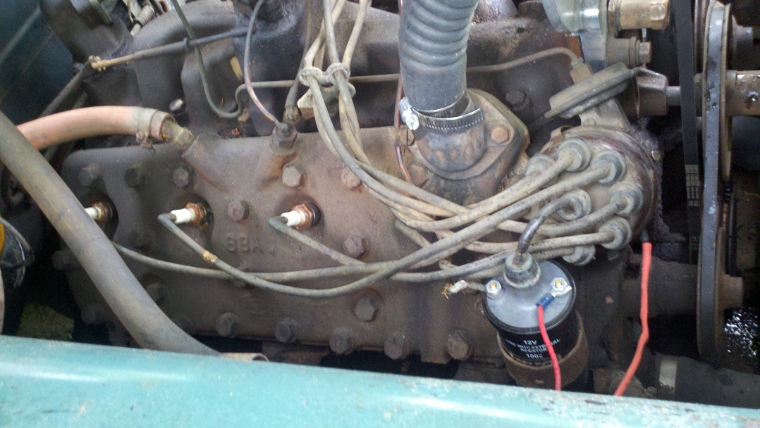

    I did read a few posts about chugging flatheads on the HAMB. My 1950 8BA flathead is chugging after it warms up. I have the original 8BA labeled carburetor and glass fuel bowl. After I sit on the side of the road for about 5 min and let it just idle it will let me get enough RPM and feather the clutch to "GET HOME" about 1 mile at a time. It seems like there is a sweetspot in the throttle that I can feather the pedal to get down the road and it will happen again. Once it cools down it starts like a dream and will idle all week.
    My first thought is the fuel pump.
    This is my first flat head and would appreciate a lesson or two.

    My Y block is doing that this year too, and it never did that before. I filled the tank before the first cruise this year and it only took 3 gallons. I want to drive the old gas out before I tackle anything under the hood. Your plugs look a little fat. My flathead would do that with Champion plugs, NGK would run good with no carb changes.

    I don't know why its chugging, but by the looks of your plugs it looks like you're running pretty rich?

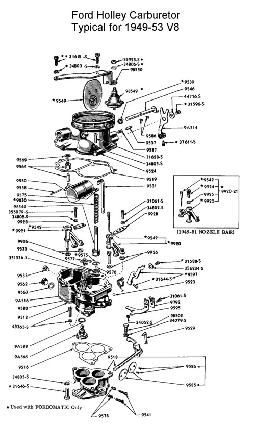

    The new Economizer Valve had a large corner radius and did not seal. To find this I took the carb out and filled the bowl with water. It was pouring out of the bottom. I trimmed the corner down and re-sealed the valve.
    Problem gone. I did find this last year but did not follow up until now.
