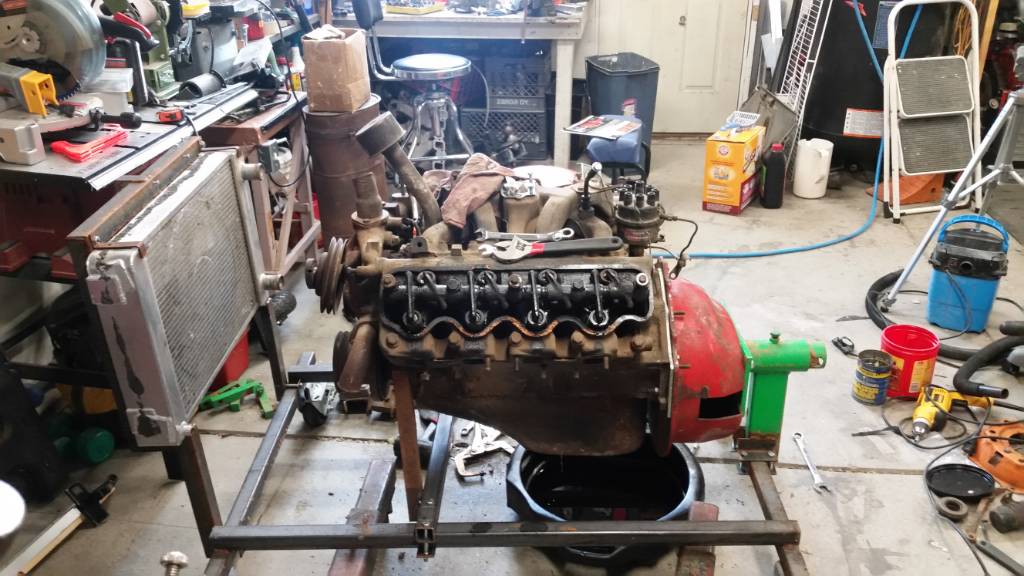

  12. Thanks @RichFox
    I'm still gathering parts and getting the T titled
    But I'm close.
    301 polly on my run stand. I now have a 4 barrel intake for it 20170429_154612.jpeg
