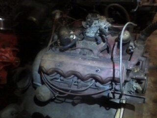

    Here is a pic of a 325 Poly (Dodge).
    (Chrysler)I wouldn't try the 392 heads on it. Its a tall block. The 331 or 354 heads should work with a little work as stated earlier by others. The early 331 heads are cheap but the 4v with wet intake (built in thermostat) on the 51-53 usually more expensive or the cross over kit also extra money if you use a later intake.
