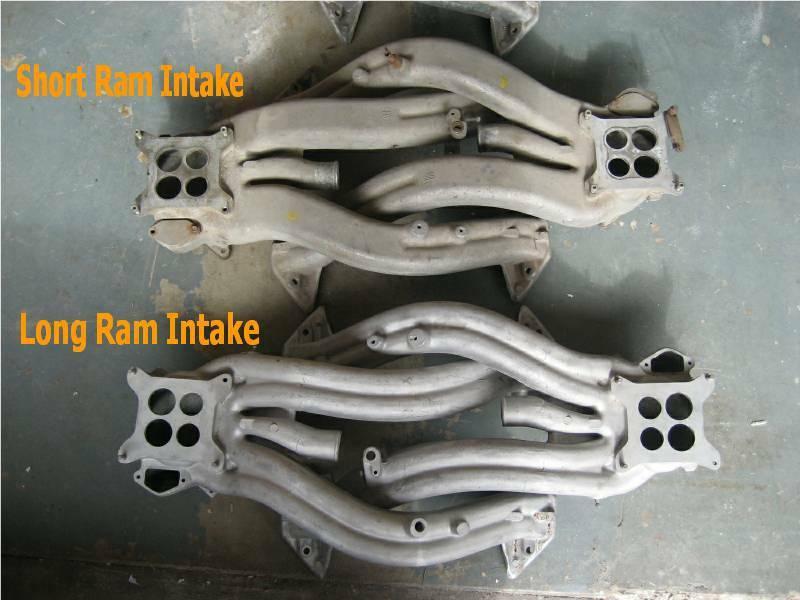

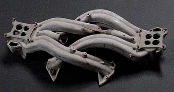

    My setup isn't on an engine, it's sitting on my dresser in my bedroom lol. But if I position it as it would be on an engine, I can get you close. Center of carb to center of carb is right about 3 feet. That's to say 36 inches. Carburetor bodies stick out roughly four to five inches each side. Depending on if you're using a Carter or a holly. Also a little difference between a 650 CFM and a 750 FM. Air cleaners aren't real big. Maybe 10 inches in diameter? So about the same as the carburetors themselves.
    36" + 10" = 46" total
    Be aware that many if not all big block Mopar engines were mounted a little bit biased to the passenger side. I don't know, an inch or two?

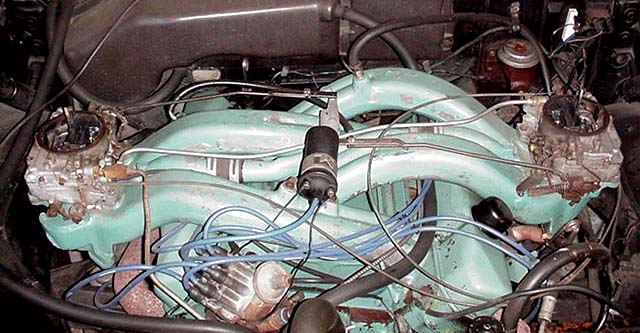

    I had a setup on my 57. I did not have to trim anything, and they fit with fender well headers.
