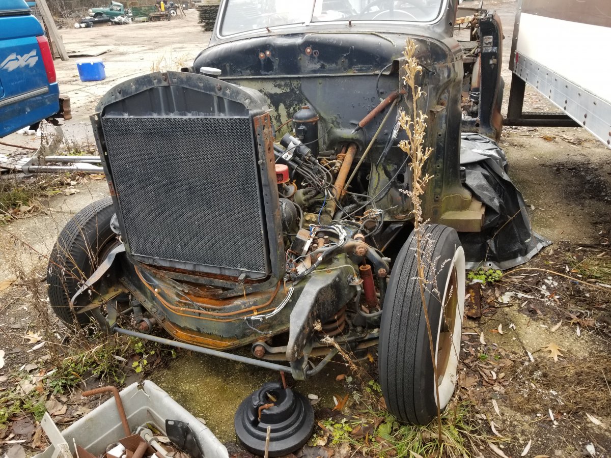

    All,
    I need help with the year. I know its a Highlander convertible, but what exact year. Couldn't find to many pics on the inner-web to narrow it down. I think its later than the 40-42 model?
    What you see is what I may be able to get, but not sure at this point if there is more. And only these three pictures during a fleeting moment. I did get a look at the motor, but no pic. I think I saw spitfire, and small like a flat head four, but assume its the six...
    And if we identify the year, are there other Chrysler cars that share the same fenders, etc.?

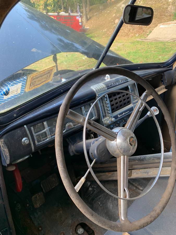

    Second try on this picture....

    Oh, well. That is a closeup of the dash.. Here it is resized..

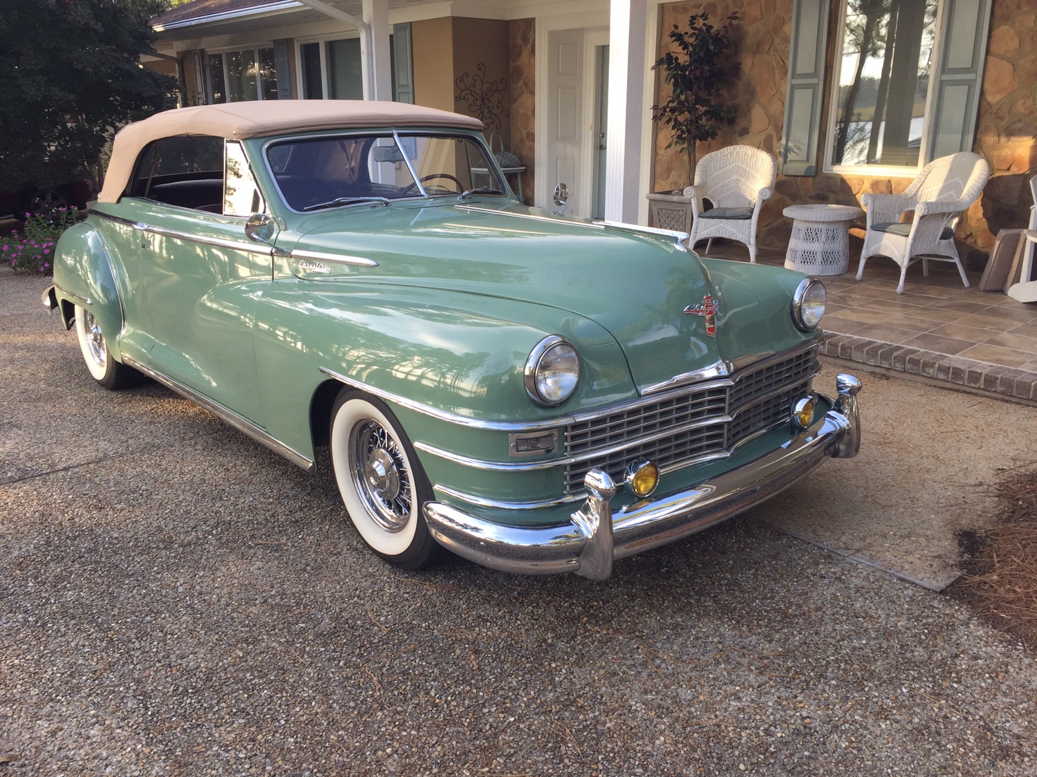

    I recently bought 1948 Chrysler Windsor Highlander convertible and what you have looks like a match. Mine was considerably updated in the center but the rest of it looks like yours. [​IMG][​IMG]

    Forgot to mention that the Highlander name is used only for cars getting the plaid seat upholstery as shown. ;)

    I did a quick google image search for 1941, 42, 46, 47, 48, Chrysler interiors....the 41-42 have a different speaker grill design, the 46-48 all have the same design as your difficult picture. So it's probably a 46-48 model. If you can find the serial number (should be on the frame near a rear wheel? as well as a couple other places) you can narrow it down.

    All of the MOPAR cars from 1940 to 1948 have very similar dashboards with that vertical. radio and speaker grille. I really like the dash in my '47 Plymouth but the Chrysler one is better looking

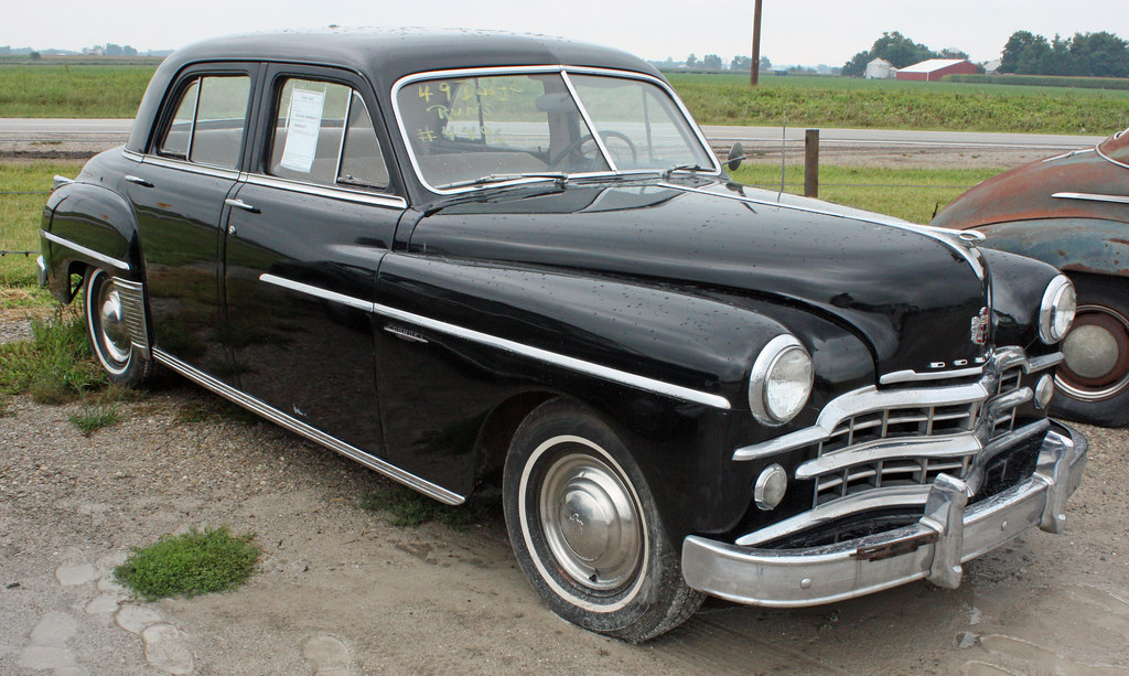

    All the Chrysler Corp. cars in era 1946-48 held the same style/model for that three years period. For example Plymouth P18, Dodge D24, DeSoto S11, Chrysler C38 & C39... each were the same starting from 1946...until end of 1948. For model year 1949 every & each Chrysler corp. brand received totally new body.
    Example: Dodge D24 1946...48 looked the same all three years: (only detail exception; wheel rim size 16" in 1946, was changed to 15" for 1947 & -48)
    ...then for 1949 the new body: D30 (the Mopar "shoebox"???)
    ...1950 only grille was facelifted
    ...1951 body sheet metal were restyled

    As far as I can see it could be 1946...-48 Windsor convertible...
    The front fenders & doors are missing, thus you cannot spot the difference from 1941 to post war era.
    Also the black tarp covers the rocker area thus you cannot see if it had open running board as 1940 desoto or curved side panel as 1946-48 (above)

    Great car, worthy of a build, and it looks to have the top frame on it and quarter windows which would be a deal breaker for me, the fenders, front clip and trunk lid you can source from a coupe (or even a sedan with the exception of the trunk) but the doors are convertible specific, there are no hardtops to source doors off of like you could with a 50-up model.
    If the doors are there, that one would be worth pursuing for sure. Otherwise you're likely to be stuck modifying coupe or 2 door sedan doors which isn't impossible but it'd be tough.

    Got another look at it. Was unable to find anymore parts, except maybe a bumper and possible another frame. There is a building on the property that we can not enter at this time, that might have the fenders, doors etc., but highly doubtful.

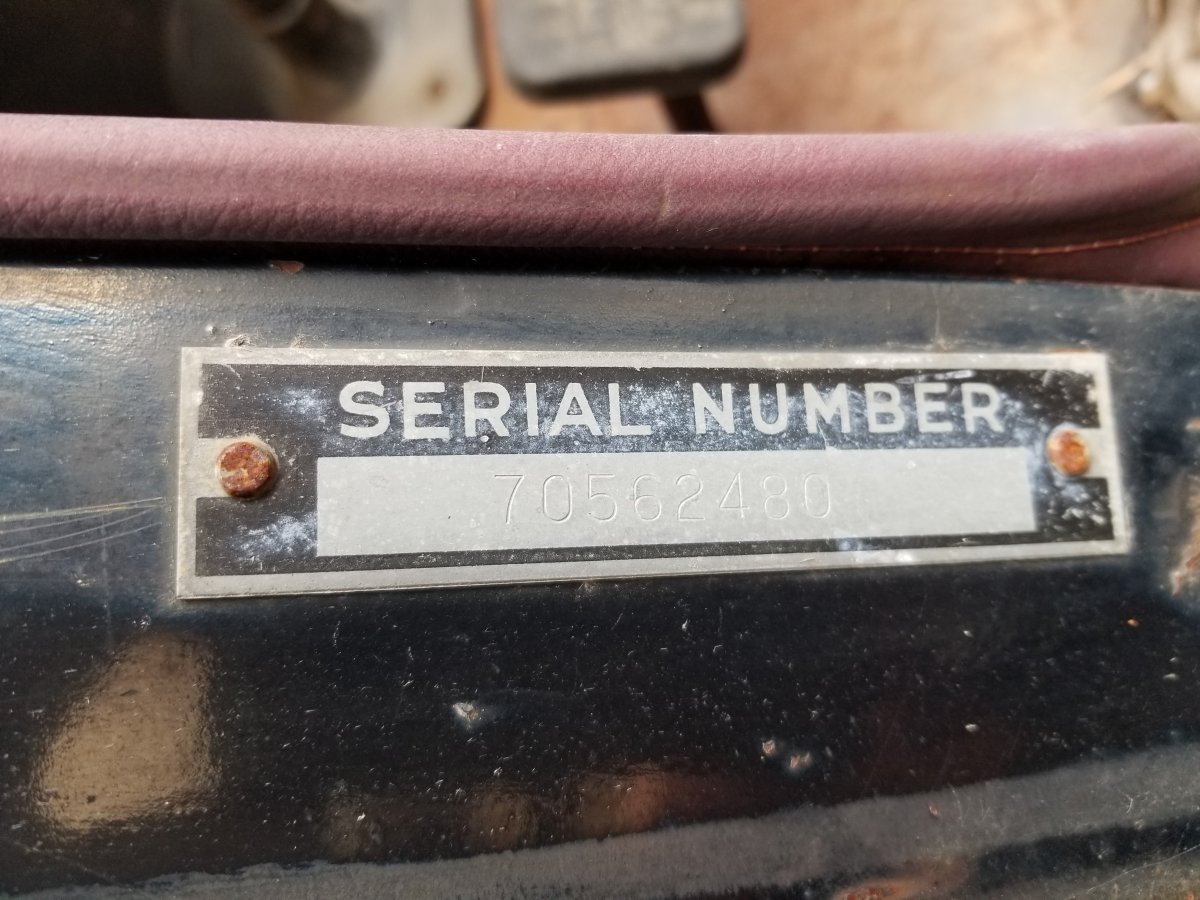

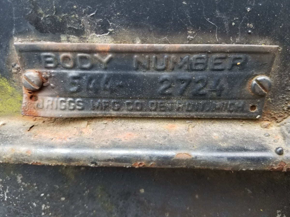

    Anyway, looks to be a 1946 Chrylser (Windsor - 6), C38W, Highlander convertible, from what I can find on the innerweb.
