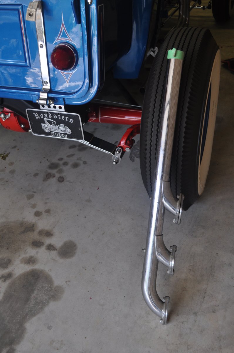

    Made my own from an old lake pipe an old steering shaft and some bearings from the local hardware store. steering coloum pi for HAMB 001.JPG steering coloum pi for HAMB 002.JPG

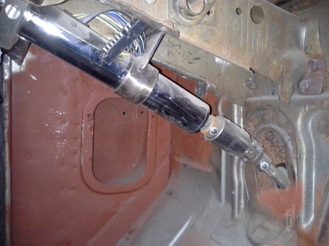

    009.JPG Its getting old an a bit less shiny,but after all,like most of my shiny,I didn't chrome it,just polished hell out of it too start with. That started life as a shiny alum umbrala stand in mid picnic table. The blend sleve under steeringwheel is a stainless steel cup . Bushing at top for shaft was made of brass on a leath.

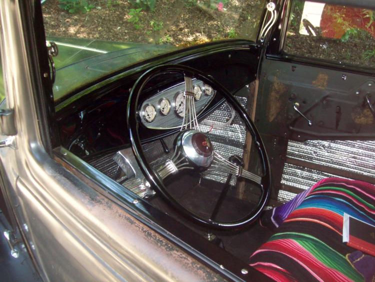

  18. Not a great pic but the steering column in my 1940 Dodge I made from the top of the Oz Valiant column with a piece of 2&1/2 diameter alloy tubing that fits into the Valiant indicator/bearing block with a sealed bearing at the bottom, the stock mopar collapsible can is used at the top......the alloy tube is polished, gotta make up some covers for the agricultural exhaust clamps, tho' they do the job...............andyd
