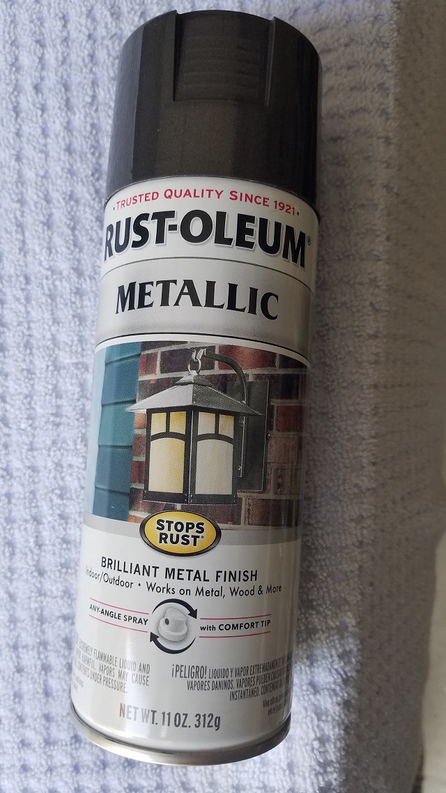

    swap meets in Calif used to have many chrome bumpers sellers show up - most had plating done in Mexico - have tried many so called chrome plating in a spray can products - useless, unless you want silver - no where near chrome but, for a strong 20210809_122205.jpg gloss metallic try Rust-oleum

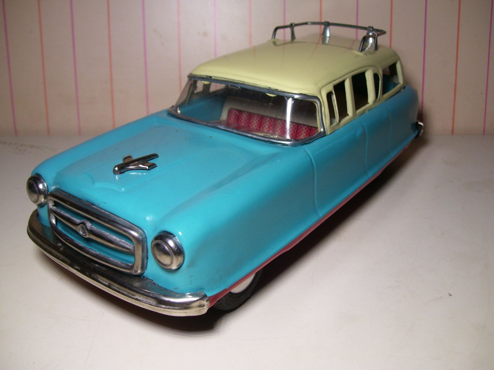

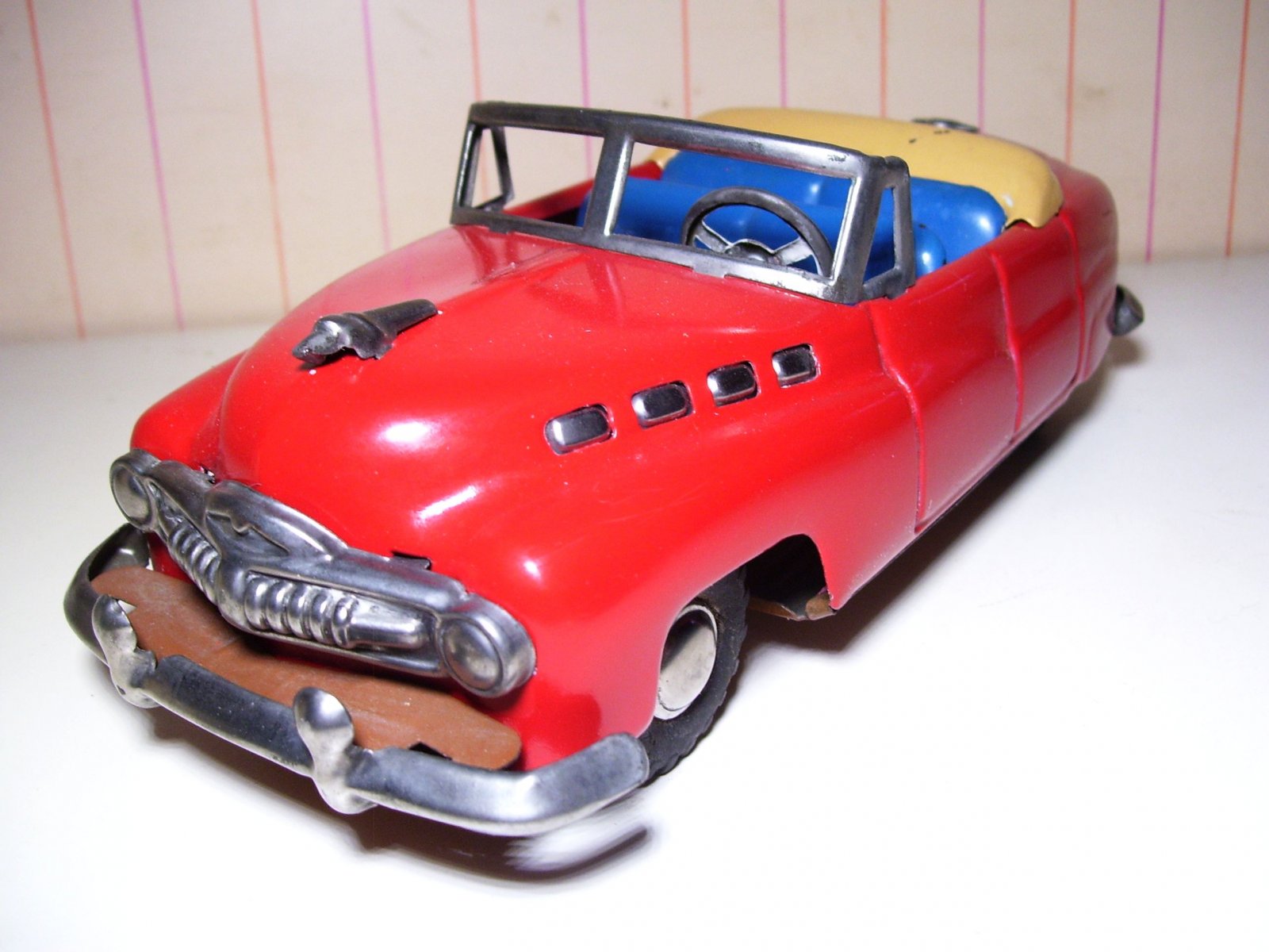

    I agree with @Rusty O'Toole, you can do electroplating of small parts at home. I use the Caswell "Plug N Plate" system to restore the chrome on vintage toys. It's a brush-on electro plating system that works quite well. I do 2 applications of their "Flash Copper", polishing in between, and a final of "Copy Chrome" then a finish hand polish with 3M Machine Polish. ztoy1.jpg ztoy2.jpg

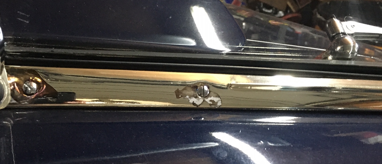

    I apologise, clem. I really spaced out . I'd say these were done in 2016 and installed in 18 or 19. I probably have between 5 and 6 hundred in total cost. I would have been better off spending 3 times that for chrome. That's what I'm going to do this winter, hopefully.
    every place there is a screw, the finish "splits" and not too long after it peels.

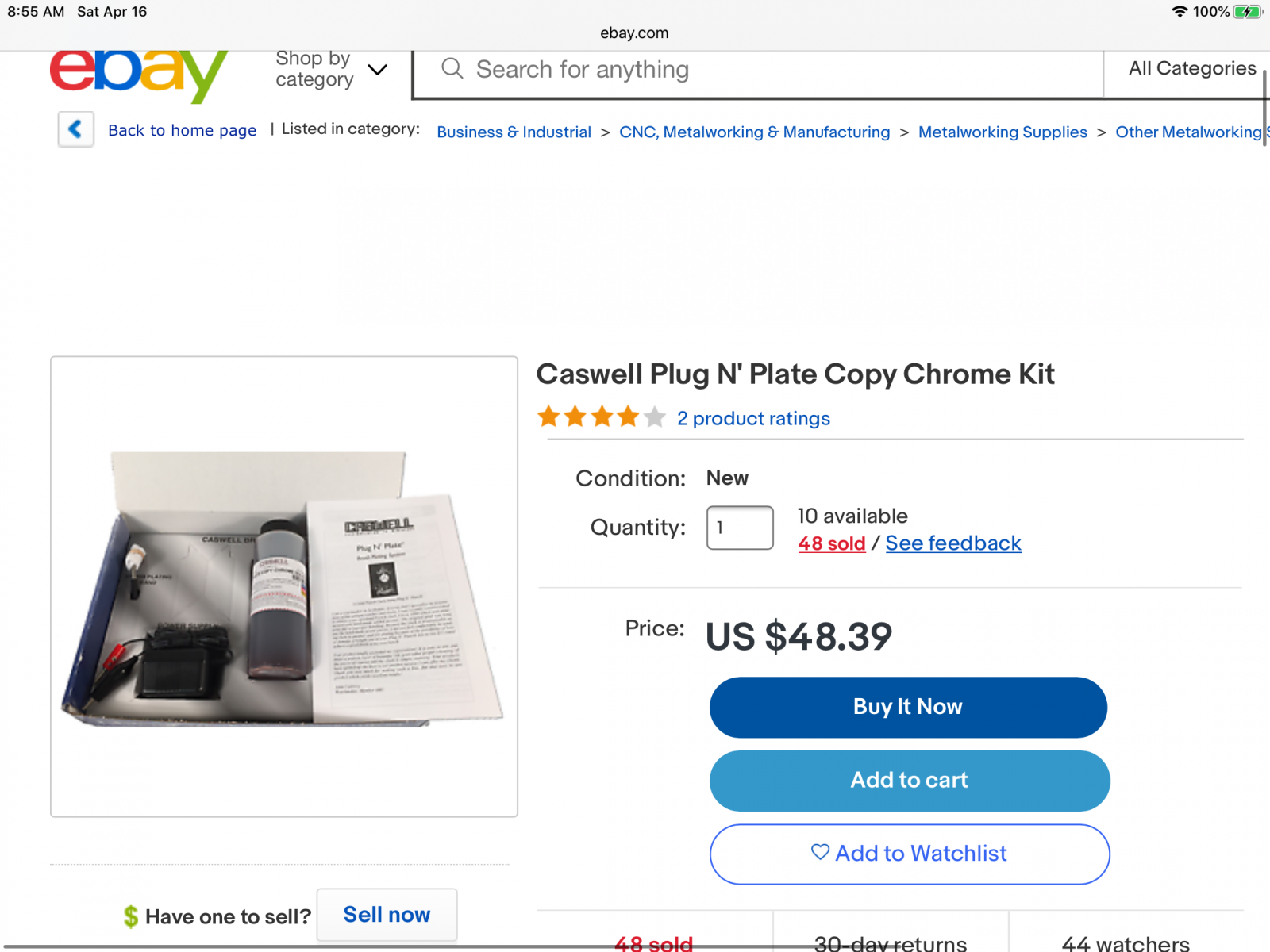

    Like this kit?

    Yes, that's the kit...but you also NEED to get the "Flash Copper" Kit as well (it comes with a c
    copper electrode).
    I've been using the Caswell Kits for over 20 years with great success...but it takes some practice to get really good results...here's what I've have learned...
    Follow instruction for applying the supplied electrode cover (medical gauze also works).
    Clean, sand and polish part you are plating. 220, 400 and OO steel wool.
    Brush plate part with Flash Copper, dry off and polish with OOOO steel wool...do this procedure twice.
    Brush plate part with Copy Chrome, dry off and polish with OOOO steel wool. It will have sort of a dull zinc appearance. Brush plate the part a second time, dry off and hand polish with 3M 39009 Machine Polish...this will bring up the luster.
    Hope this helps.
