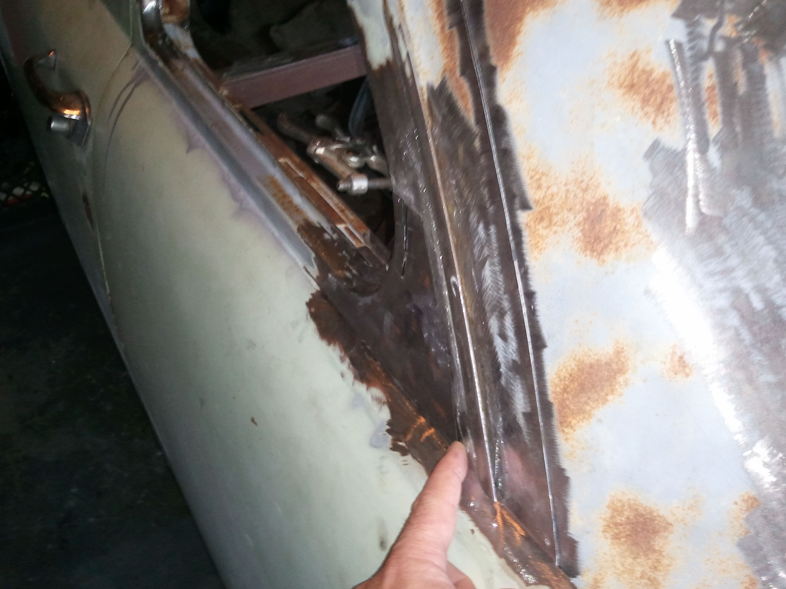

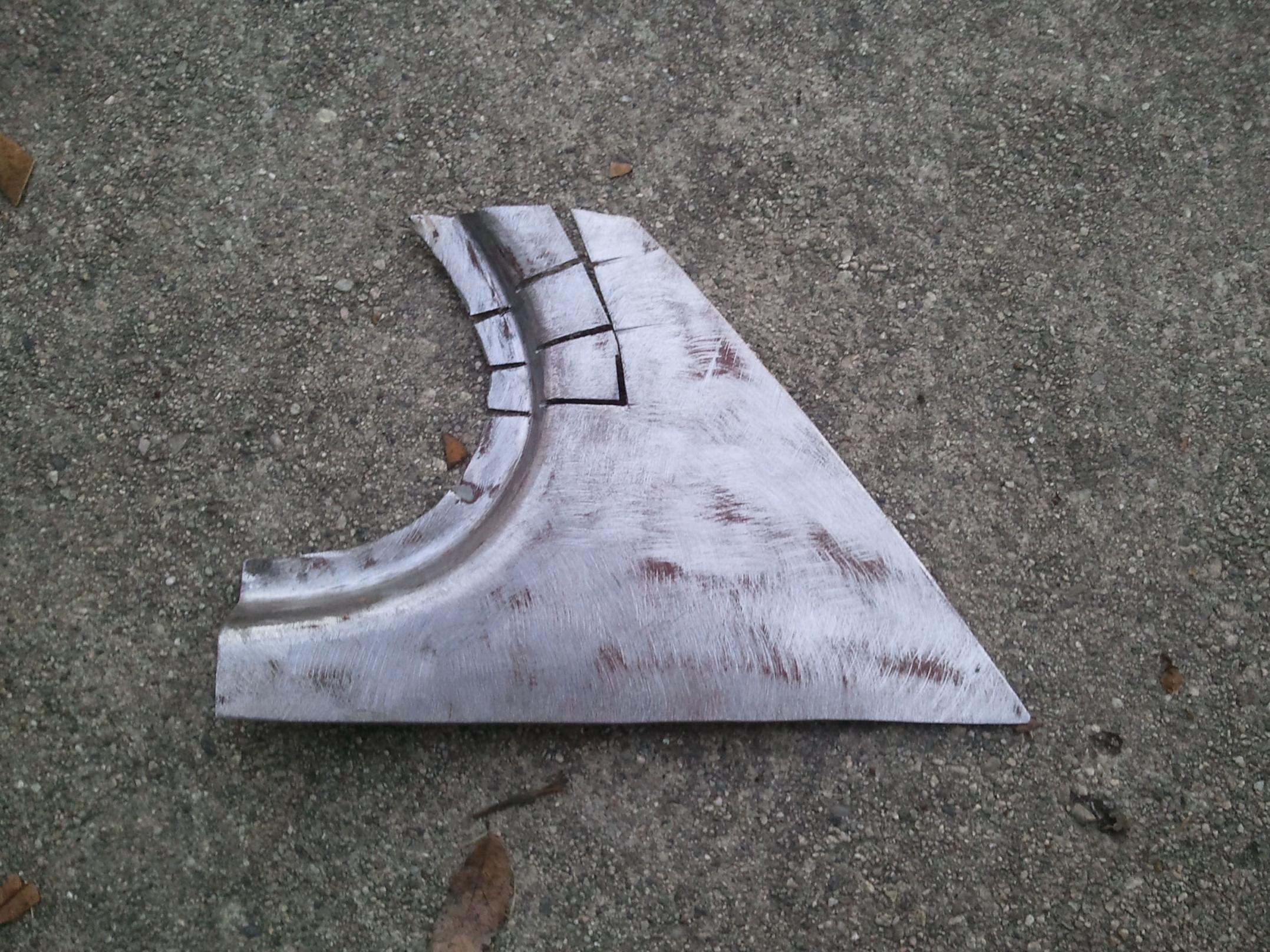

    Next, make a piece of sheet metal to fit the cut away area in the rear of the window. You should have this piece from when you originally cut the roof off. You should keep everything you cut out!!! Due to the curvature of the window changing - we did alter the roof remember - you will need to reshape the inner side of the radius. Do so with small cuts to allow for movement. More cuts equal less movement per cut but to many cuts equals swiss cheese. Place and fit the new piece and prep for welding.

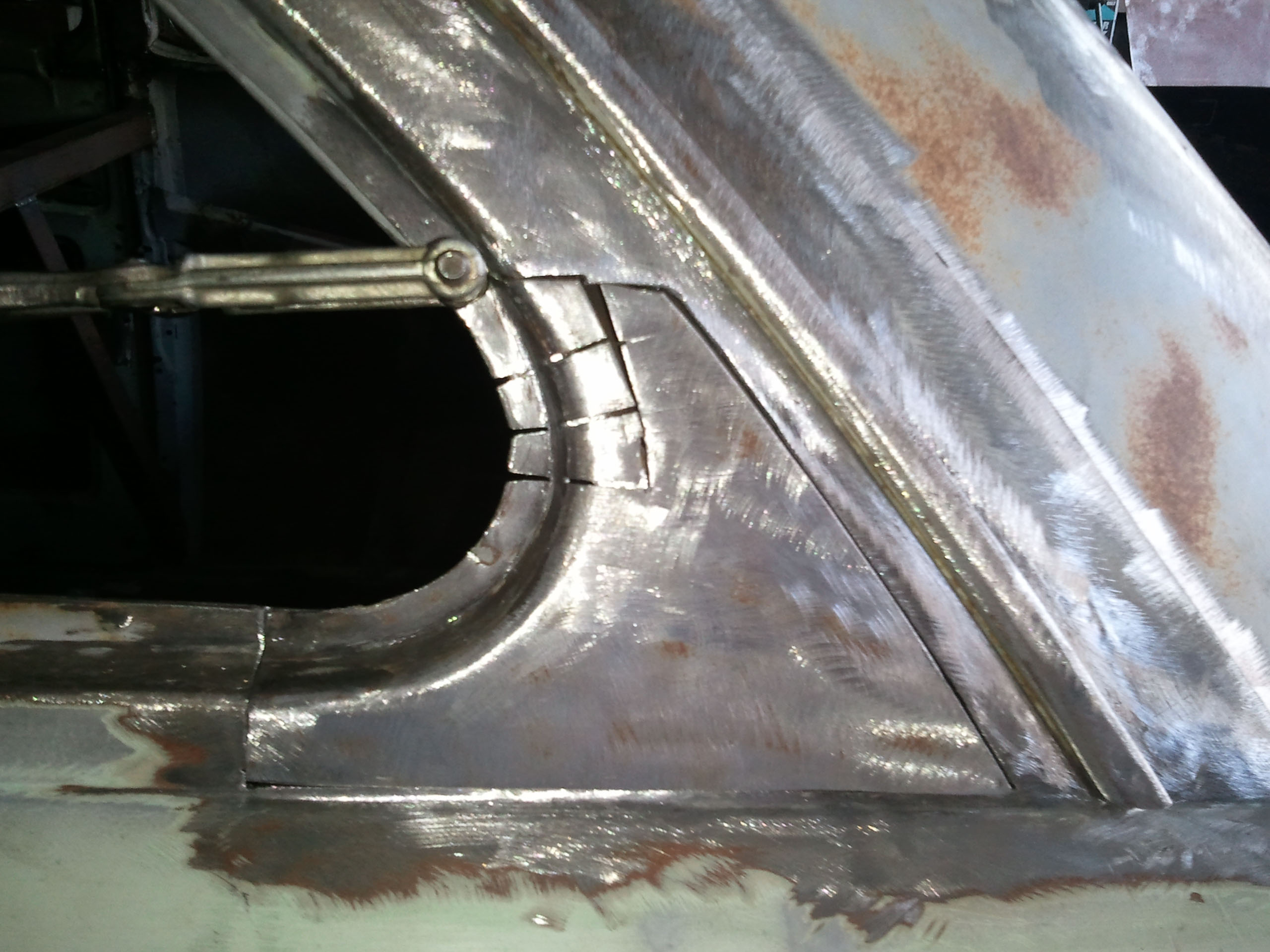

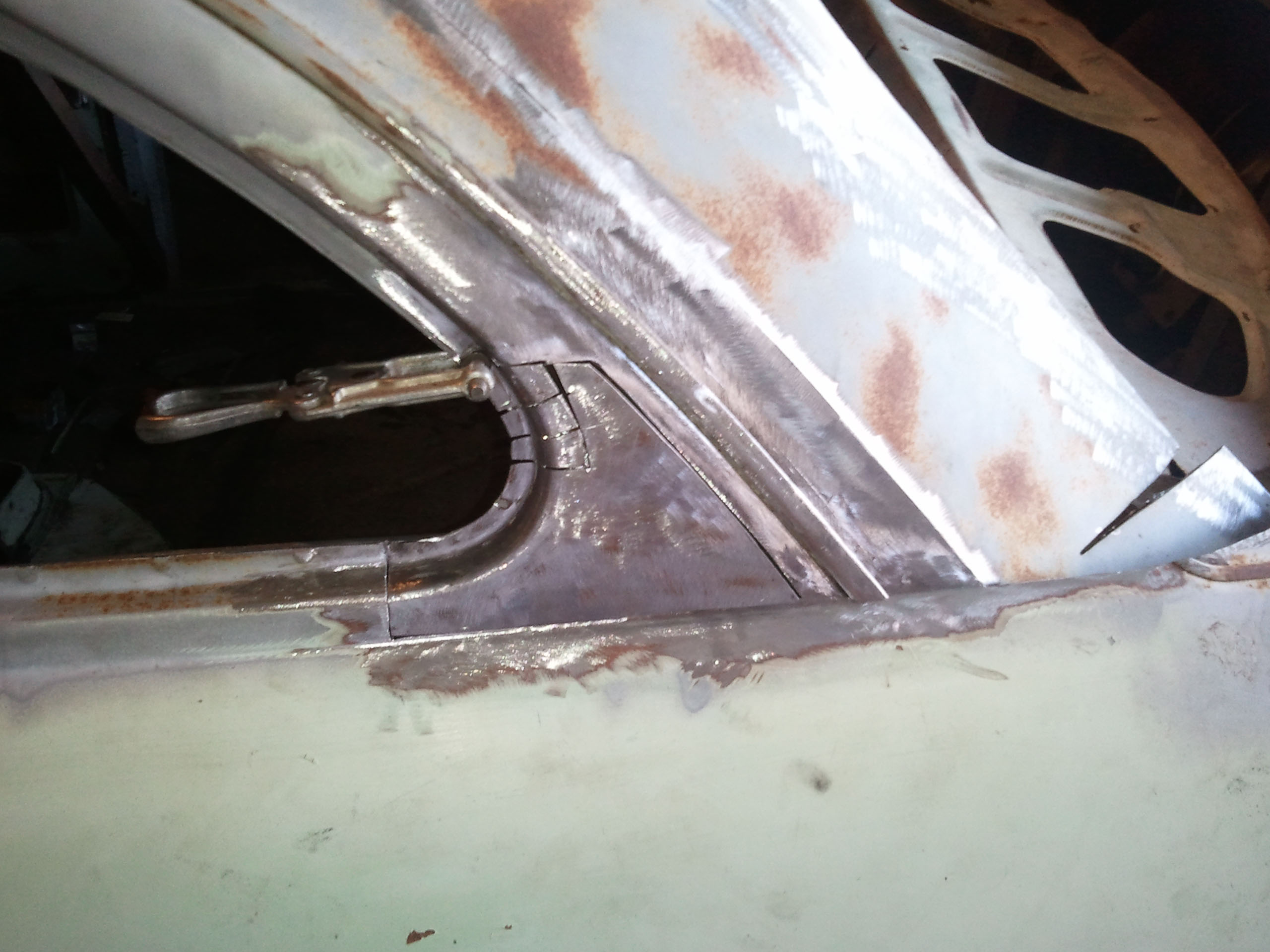

    Lastly, weld and grind smooth / metal finish to your liking. We like em real nice!!!!
    *opposite side shown cuz we havent welded in the d-side yet;)*
    And VOILA!!! c-pillars done! To us it is so important to keep stock like amenities such as regular window function. This is a club coupe so it has pop out style windows which must still pop out. Making good corners and taking time around window and door ares will save headaches later when its time for glass and such.

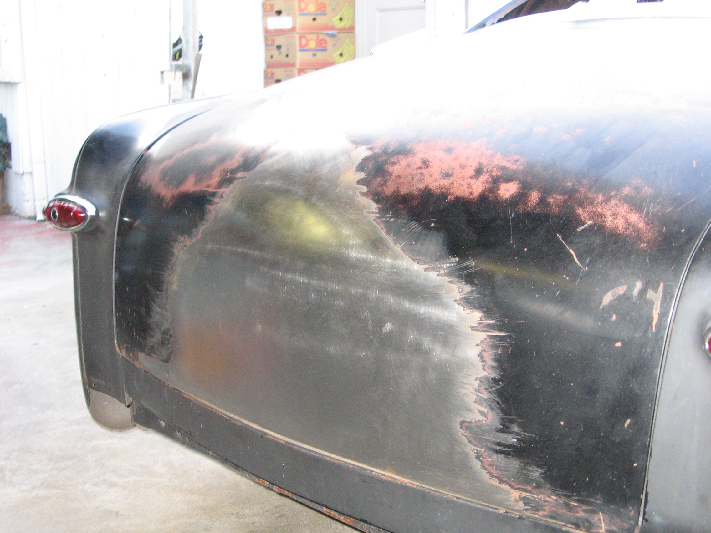

    Well, cut all the structure out of the sedan and rolled her outside to have a proper look. You be the judge. Took care of the deck lid and we will be doing the quarter panel seams as well.

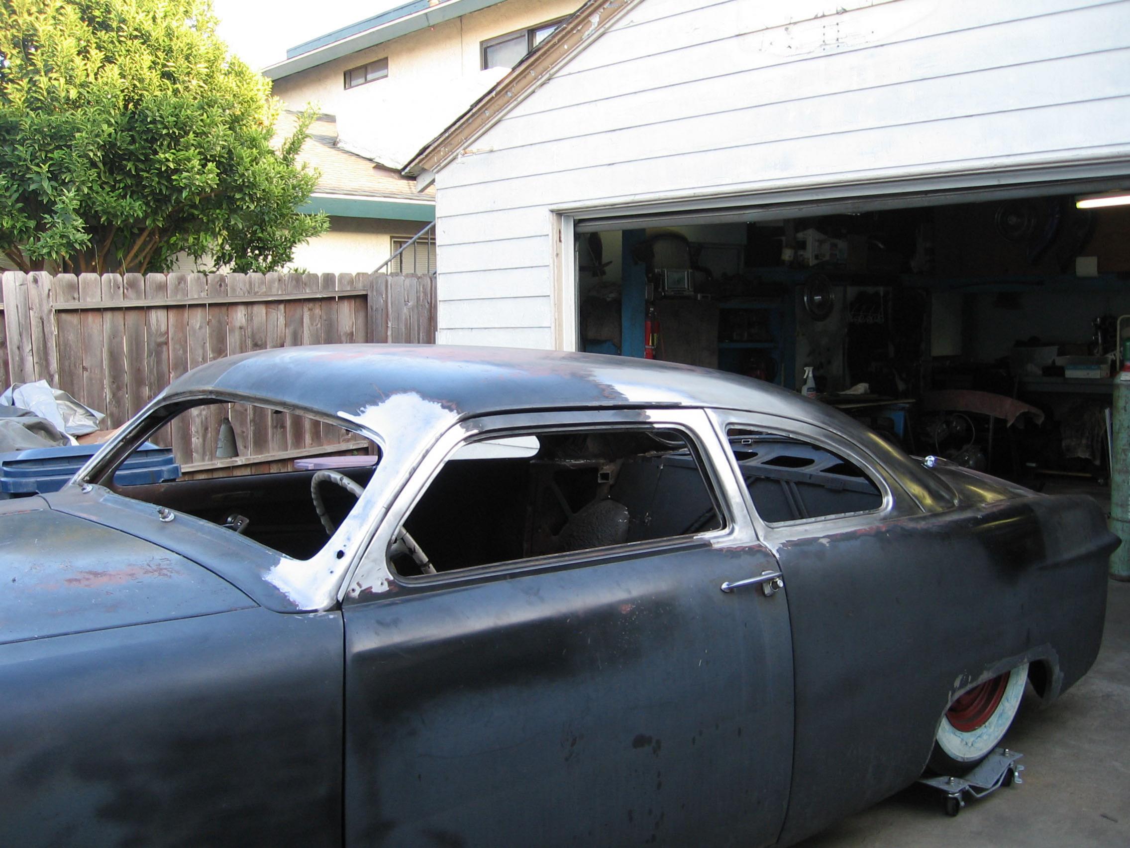

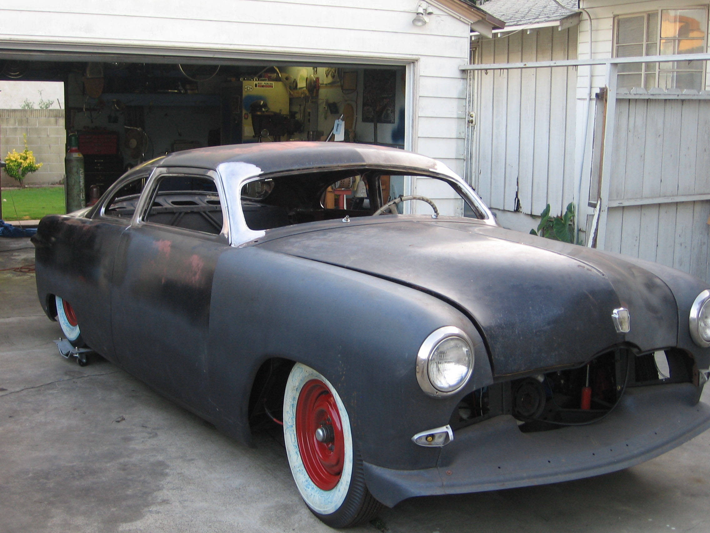

    Krooser, here's a shot of a 50 poncho HT we're chopping now, you can see how the rear window is set down into the body. Cut the package tray loose, drop the window frame, reattach everything. The edges of the package tray will get layed down.
    chillywilly, you guys sure do nice work, GREAT looking chops! Thanks for the pics!

    I have to see how this turns out...how much of a haircut is the Poncho getting?

    Tbirdesq ... love the roadster. Hope the poncho turns out good too! In our experience with "sinking " the window we found getting a really tight fit in the corners is paramount as it gets difficult to seal and you certainly don't want any water getting in there.
    NOTE. The poncho chop is not being done by us. That is a picture provided by thunderbirdesq to show what sinking the rear window looks like.

    Thanks man, hope I'm not mucking up your thread here too much, just wanted to give Krooser and anyone else who's curious an example... Yeah, if water gets down in there, it's got nowhere to go, probably not as much of a consideration in sunny so-cal as it is in buffalo, but we've got a plan.:cool:
    Krooser, it's cut roughly 2" in the front and 3 1/4" at the rear, nice and subtle. The car's owner will be posting details in it's own thread once the job is done and I'll let you know.
