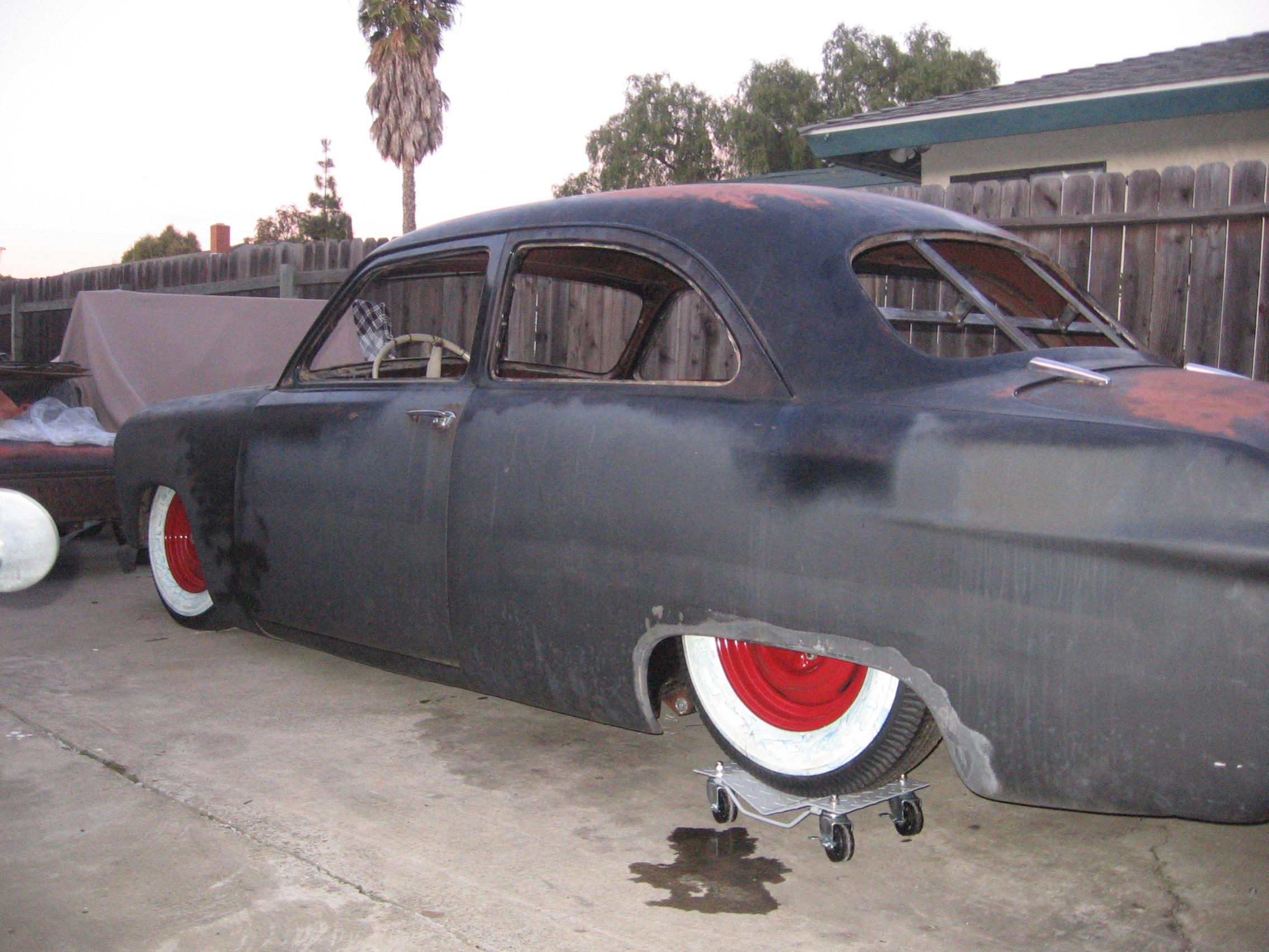

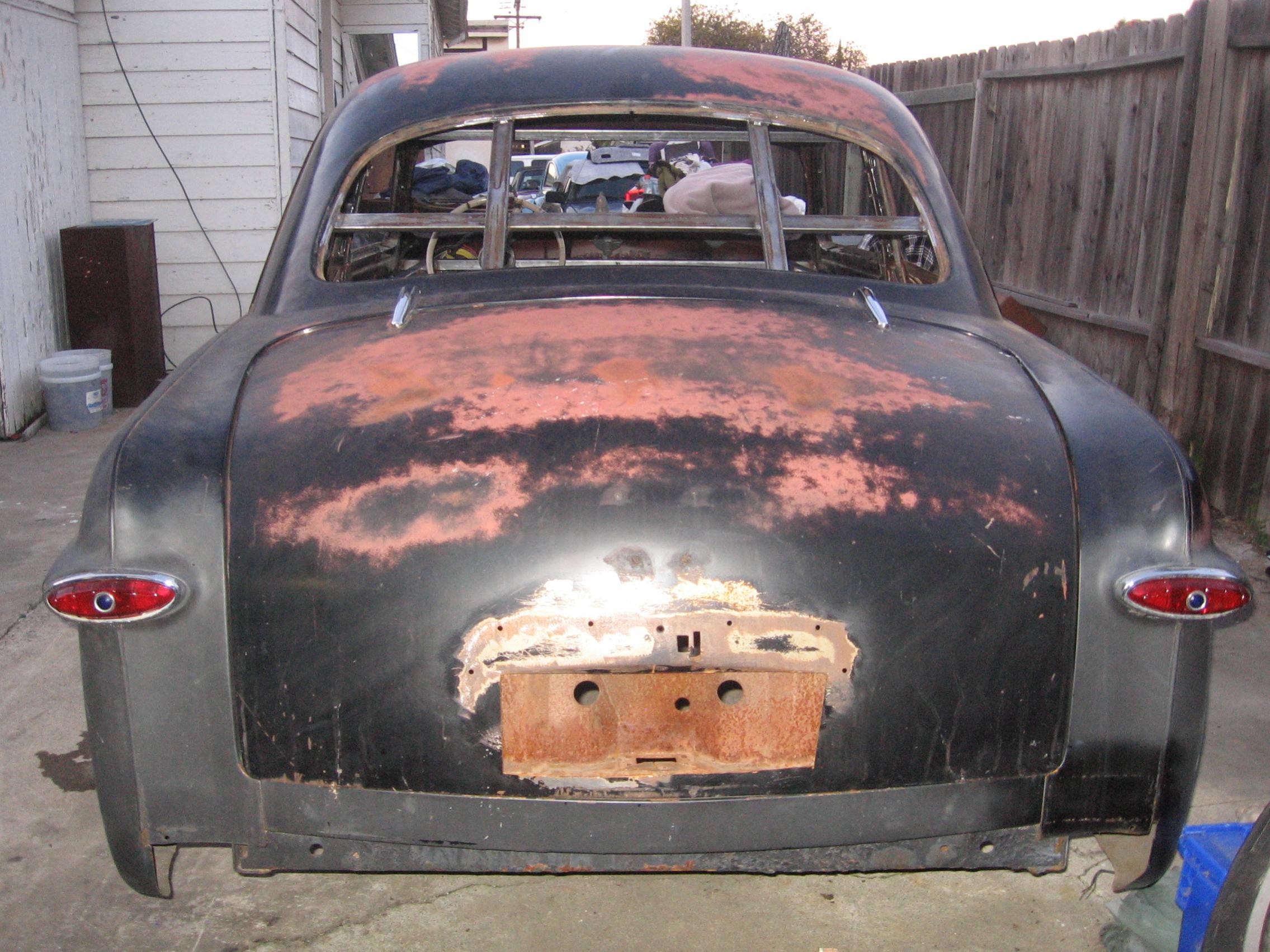

    Howdy HAMBers. Recently myself and Brandon Winters teamed up after a couple of years apart to do some chops. Brandon is an extremely skilled fabricator with a an unbelievable eye for proportion and design. He has chopped a lot of cars around here over the years and currently moonlights at Circle City Hot Rods. For some extra cash we decided it would be fun to get back into business together (we worked together for a while at Jacks Lowrodders... so long ago) doing chops and metal work out of each others garages. You can search his name to find some of his projects. Just word of mouth type work but I have already talked to a handful of interested folks who are amazed at the going shop rates for a chop. Believe me, I understand why they cost what they do... it's an intense amount of work. But if we can offer you a great finished project for less without the cost of shop overhead we both win eh?
    Anyway I thought I would turn it over to y'all and see if you liked what you saw and see if anyone is interested. I will be posting a lot of pictures of current projects and some of past work. Believe me. the guy is no joke. I recently saw a post of top 5 guys in So Cal to get your car chopped by and he was on it. Check it out... some before pics and all tubed up

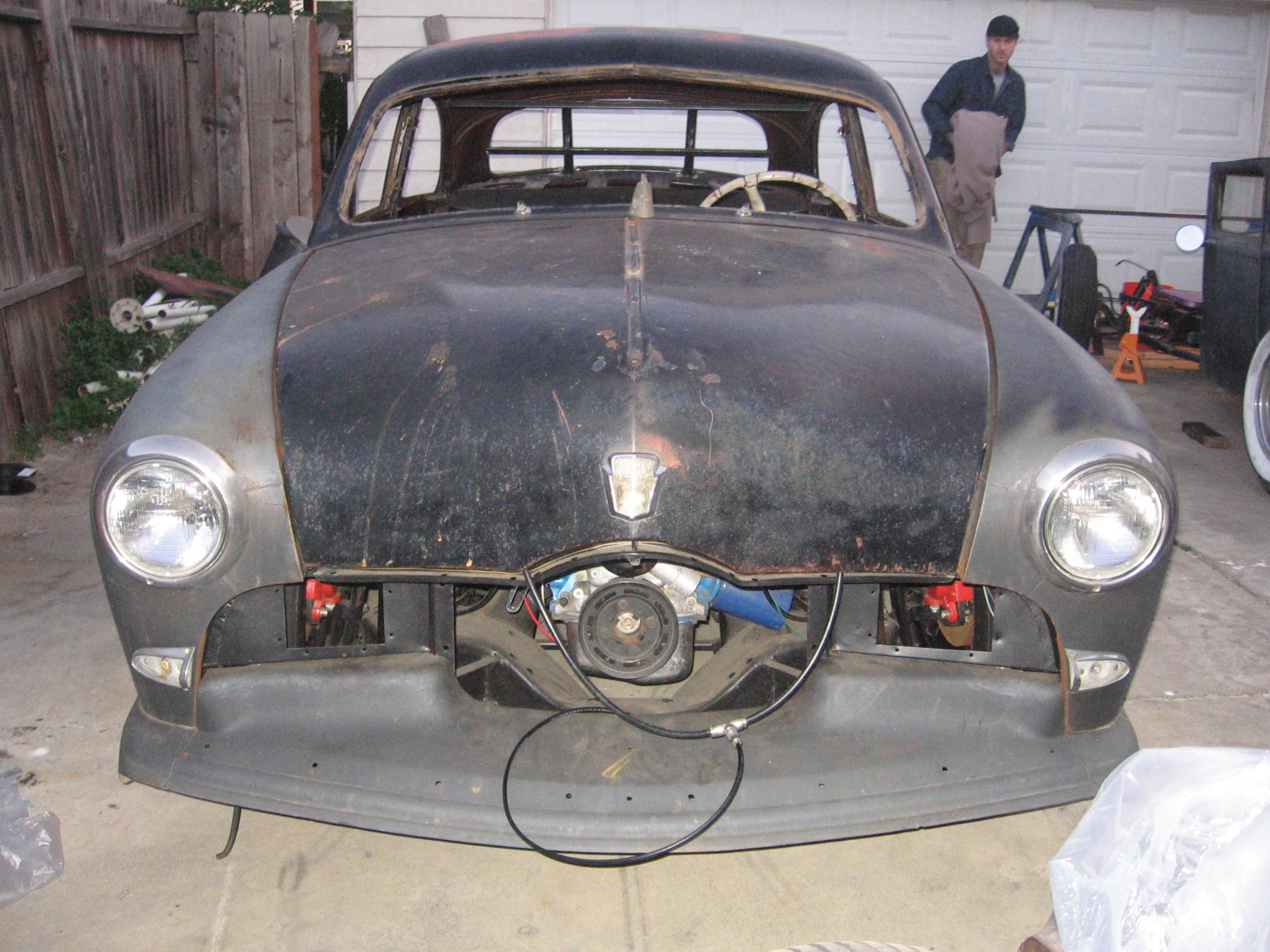

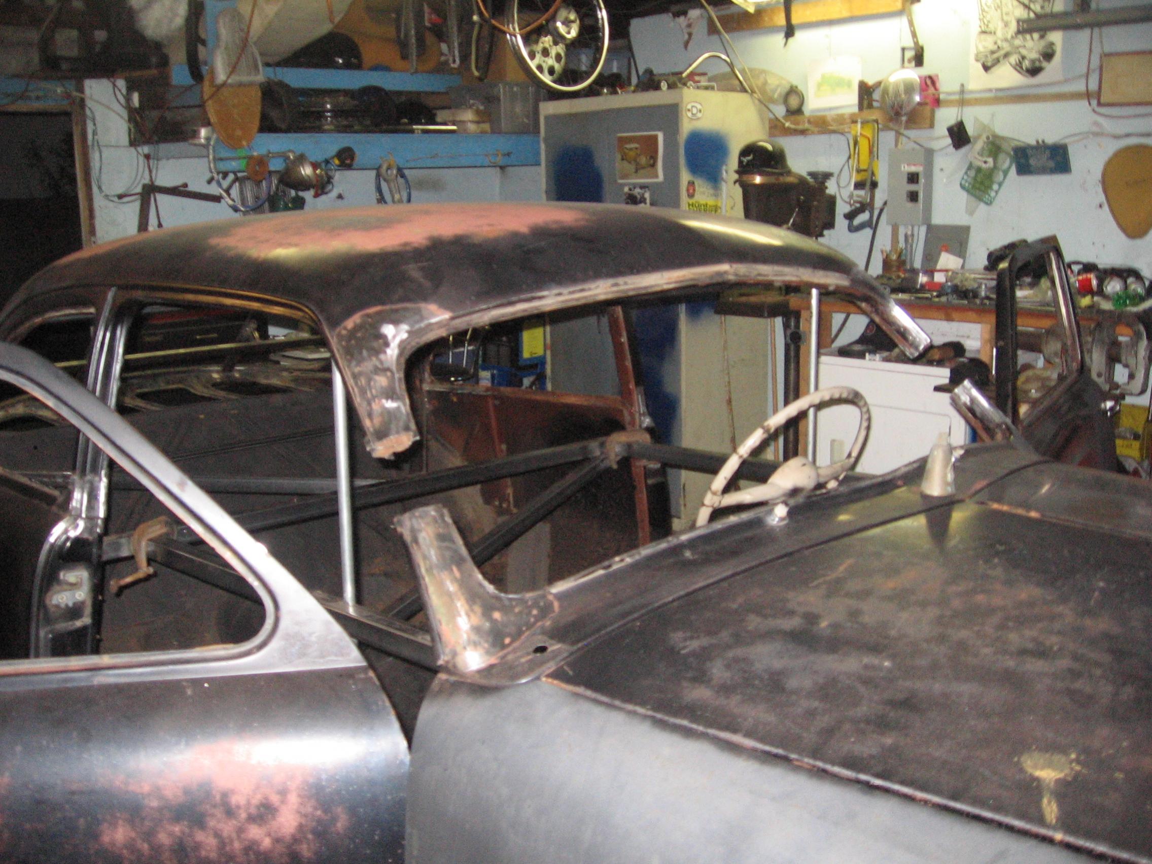

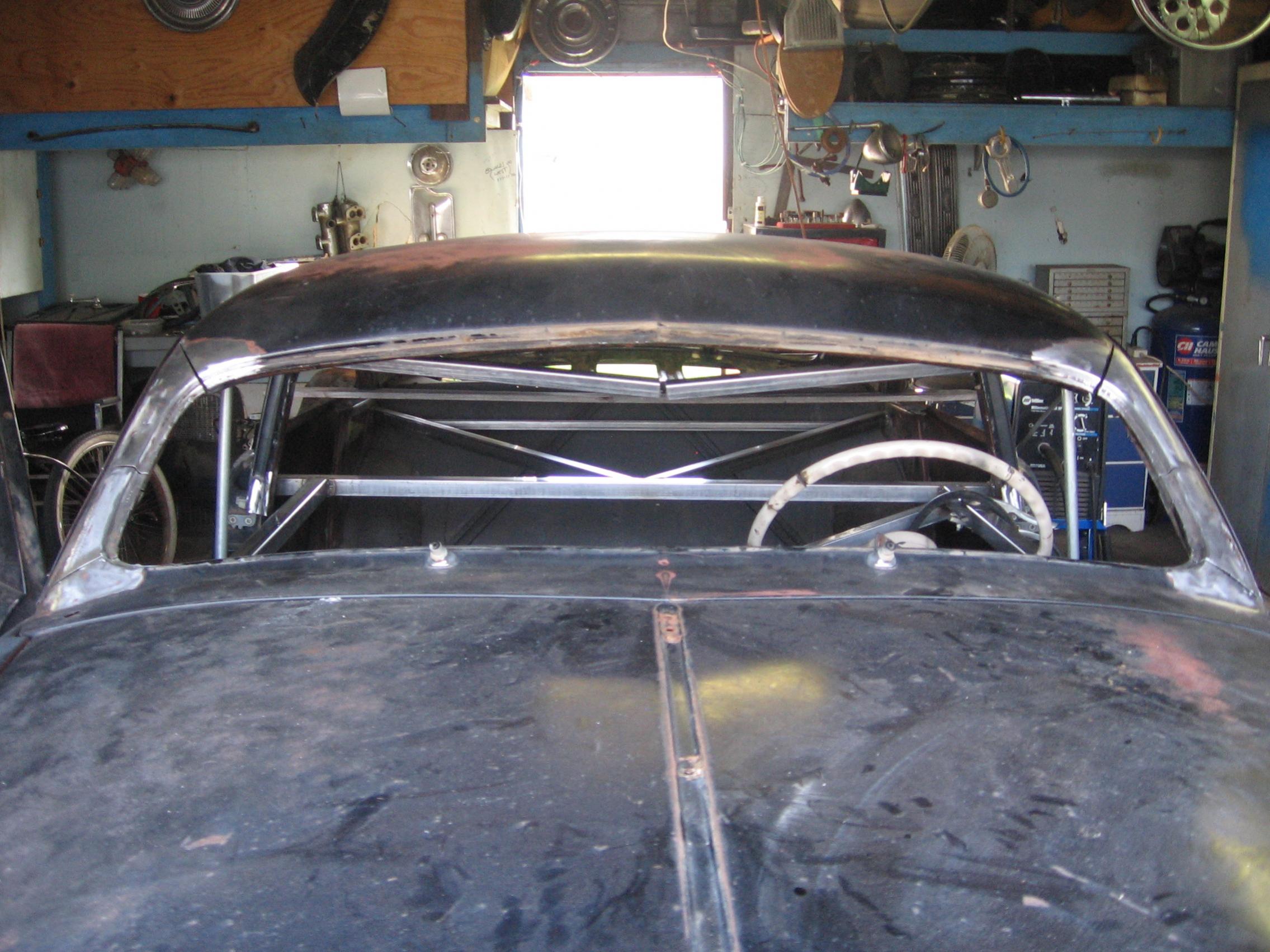

    top coming down ... 4.5" on the a -pillar

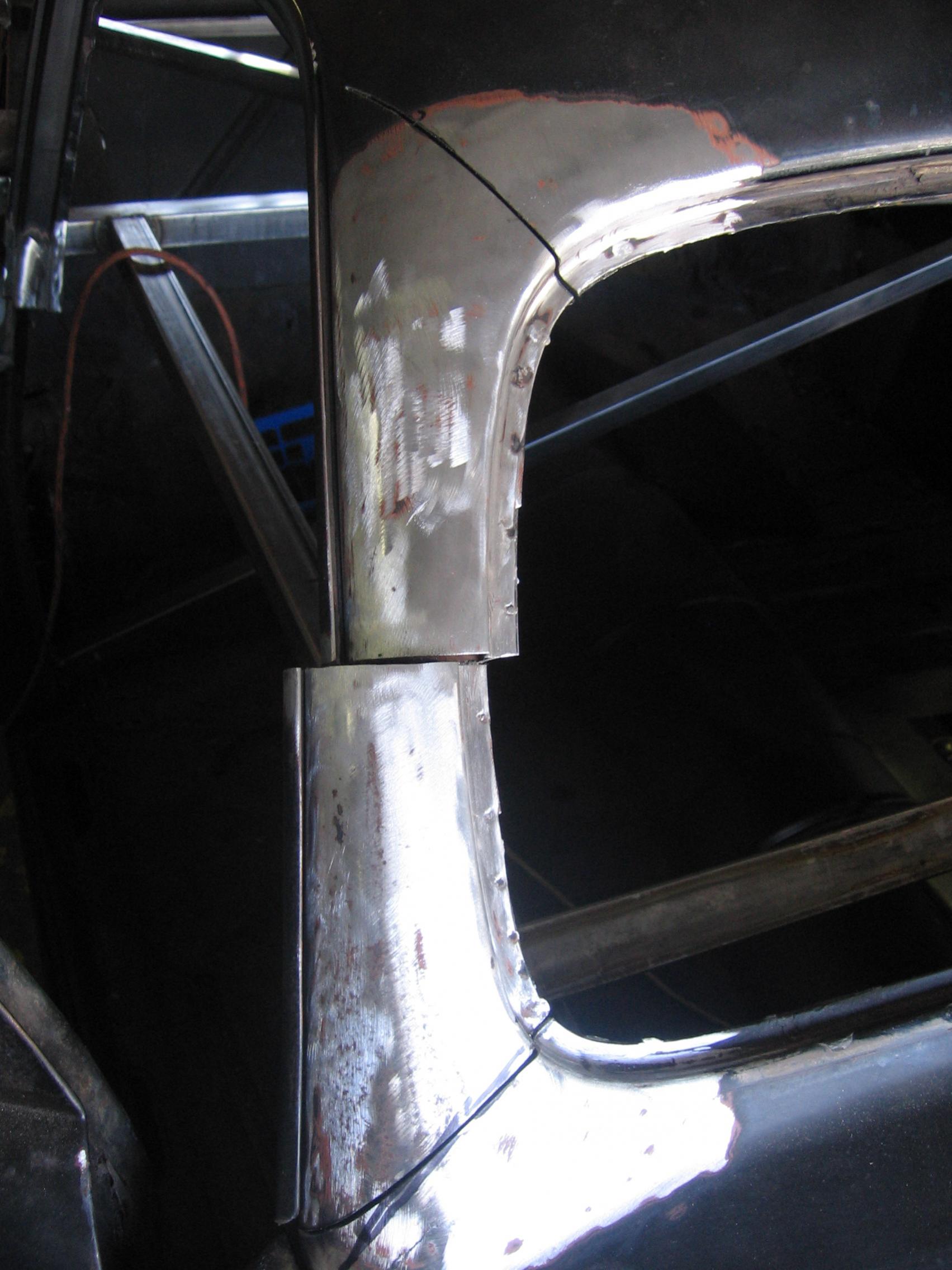

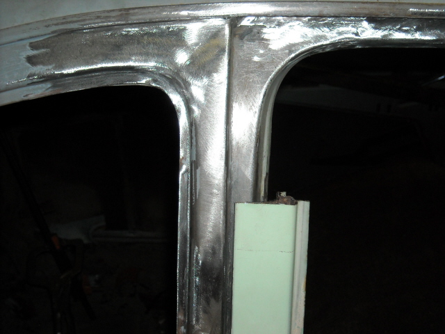

    a pillars getting close

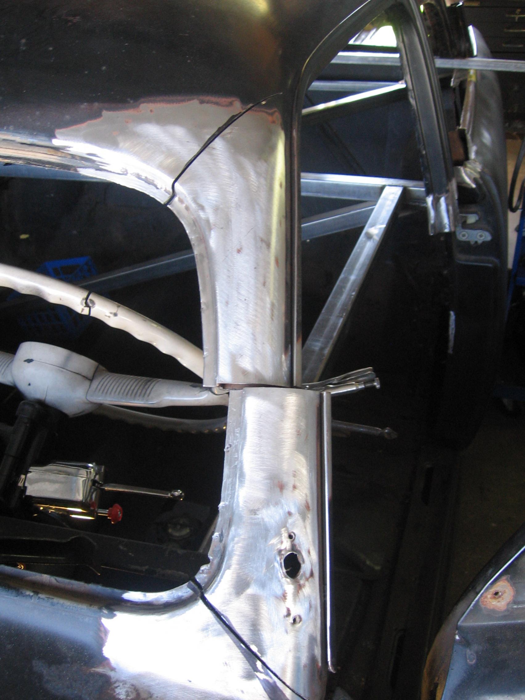

    just as important for the inside of the a pillar to be worked and dressed

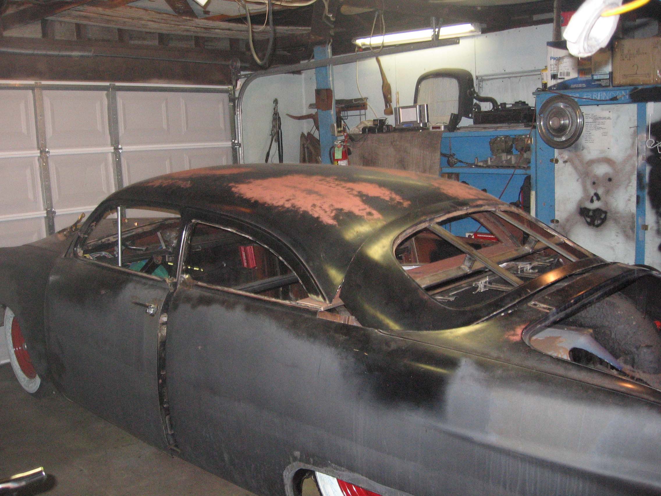

    rear window test fitting... we think that we're going to slide the whole thing forward a bit... she needs a bit more deck too

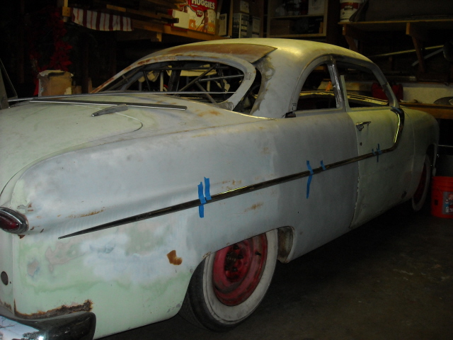

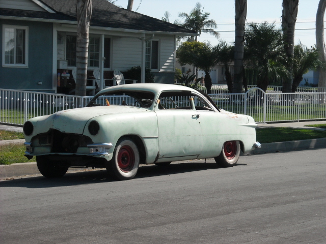

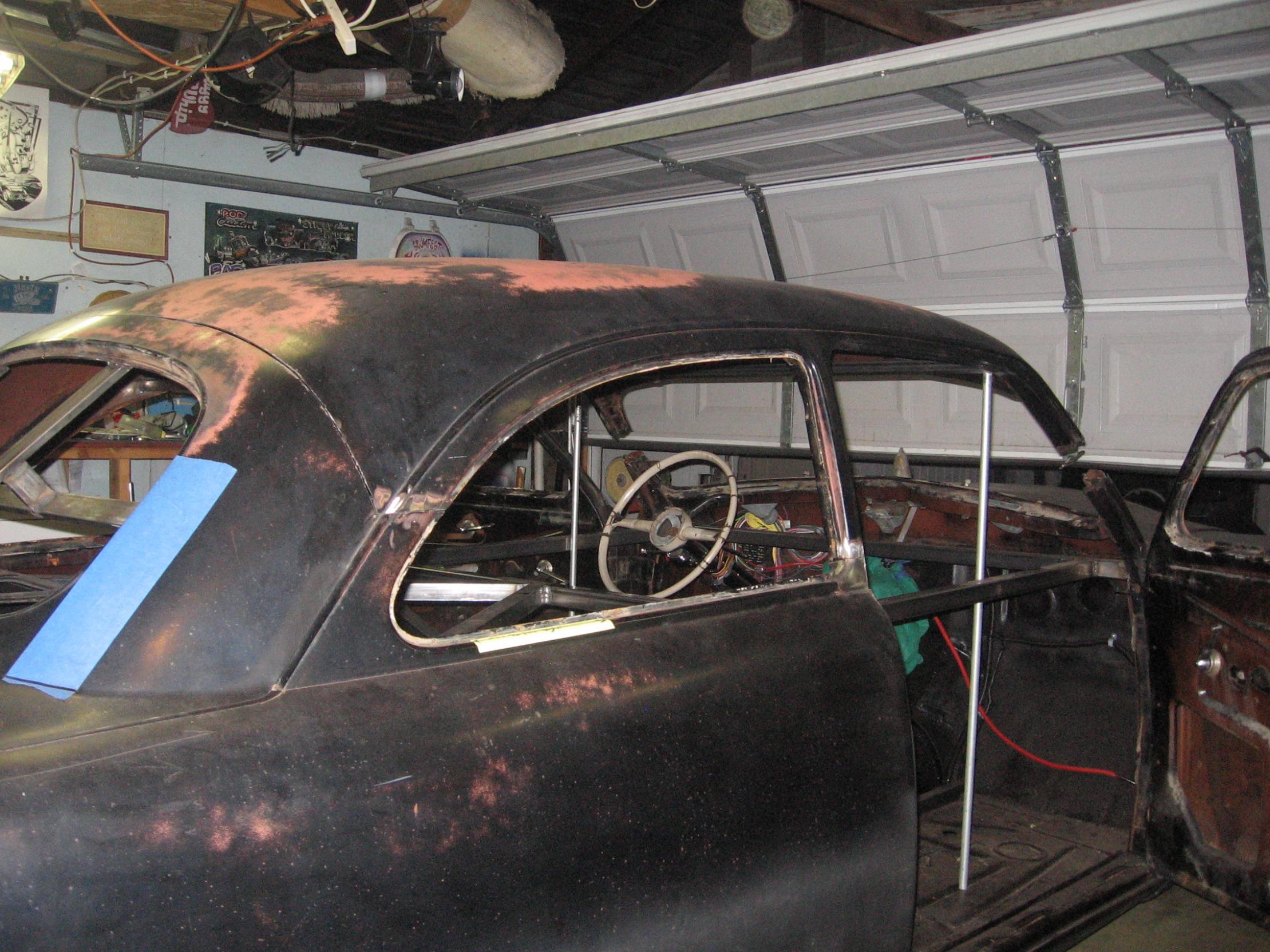

    some more updates on the coupe... coming out nice - at least i think so. I really wanted to maintain a "stock" appearance, hence the small chop 3" and the vertical pillars bit more work to do in the rear window area and we'll be done with the outer sheet metal. the white area back there is just posterboard/ template paper to help see it

    So... back to the sedan... we definitely feel the top improved by sliding the window forward. There is a bit more adjustment to go up and down but that's about where it will stay as far as distance moved forward.
