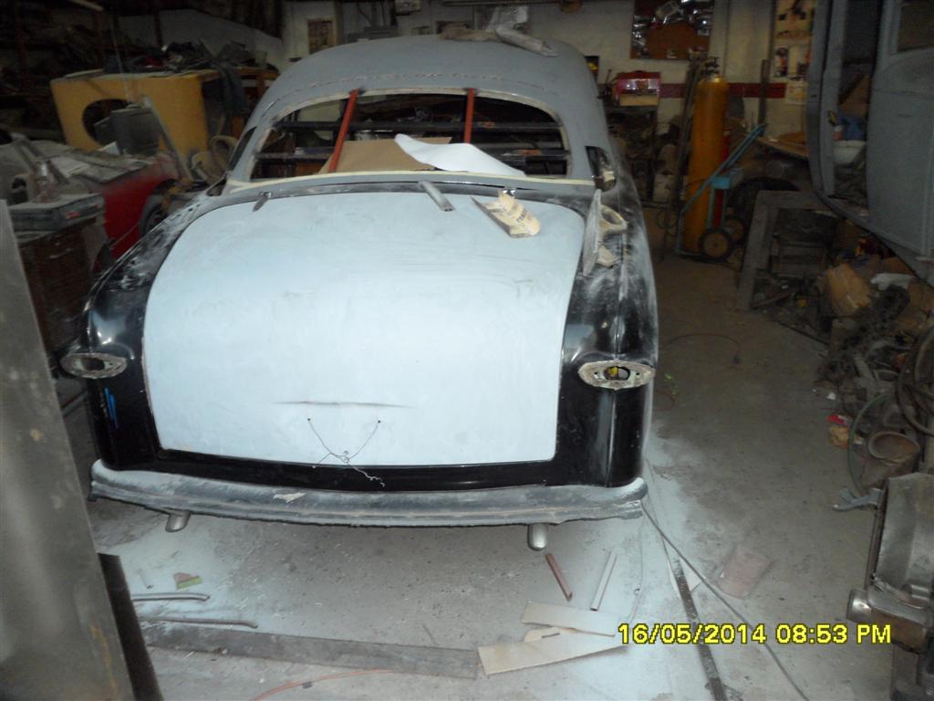

    There has been plenty of threads about chopping 49 to 51 shoeboxes. I guess what makes this one different is that it is a survivor.Though a very mild custom, in 1953, it got a 49 331 caddy motor and a 1953 merc three speed overdrive tranny. By the mid fifties , it got a louvered hood, rounded hood corners, nose, decked, and a 1953 chevy grill surround with a custom grill bar and frenched head lights. In the early sixties, the original green paint got covered with black paint and some cartoonish flames that were tipical of that era.
    Also, the original upholstery got covered with black tuck and roll that was tipical of that era.
    My friend and fellow club member Mark Faggen aka fireman mark purchased the car in the late nighties and decided to restore the car.
    The first step was to rebuild the caddy motor and restore the engine bay, wirring, and get the tranny and overdrive to work properly, and drove it around to a few shows, but the idea of making it a full custom kept bugging him, which brings us to date.
    Having restored Mark's 32 3 window, he fit me up on going all the way and making the car a full custom.

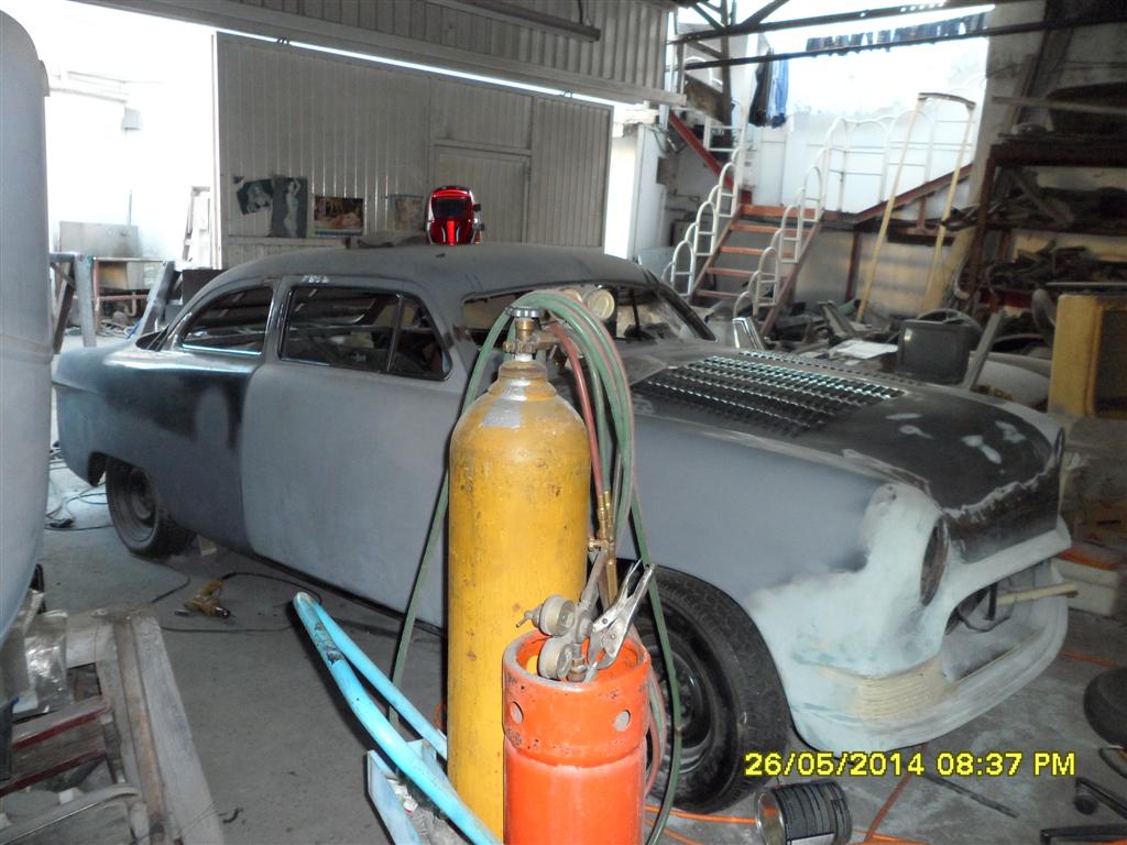

    ok let's give it a try
  5. magoozi
    Joined: May 20, 2009
    Posts: 1,719
    magoozi
    from san diego
    some more

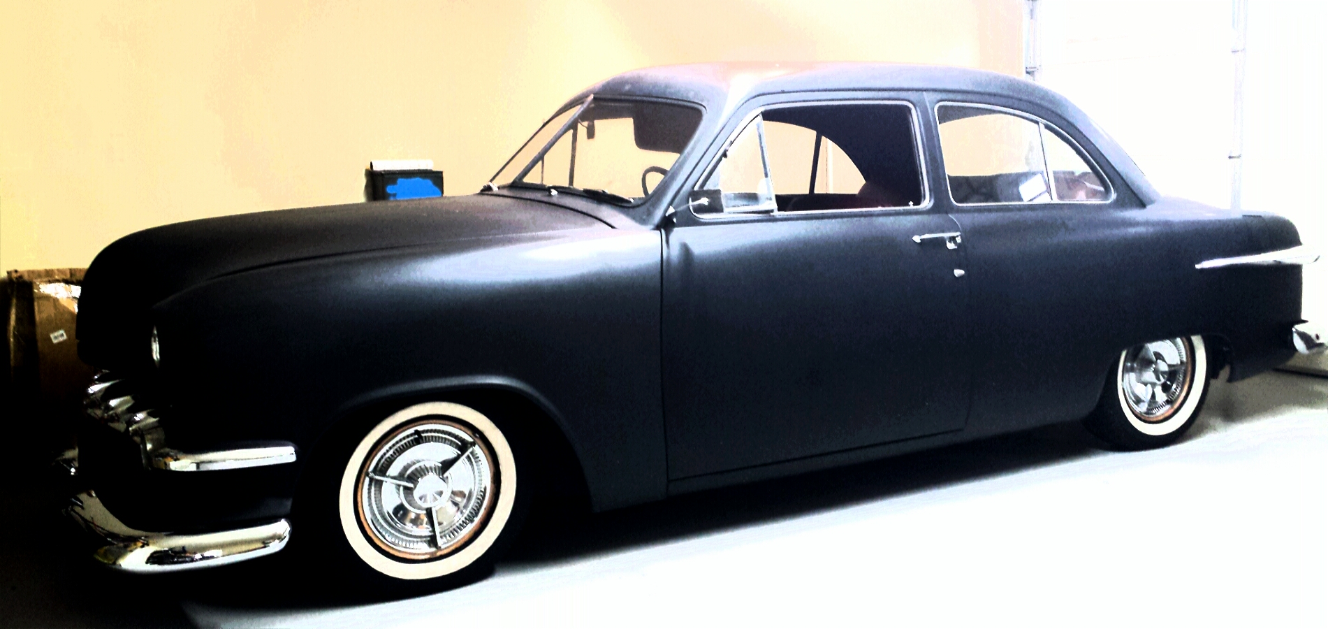

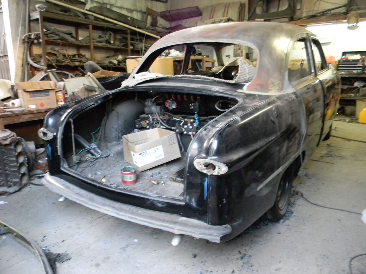

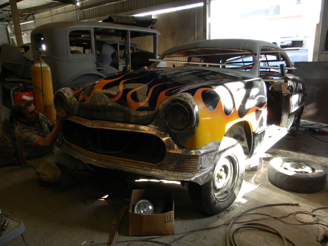

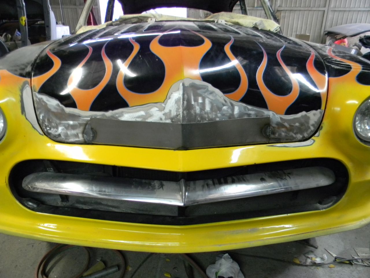

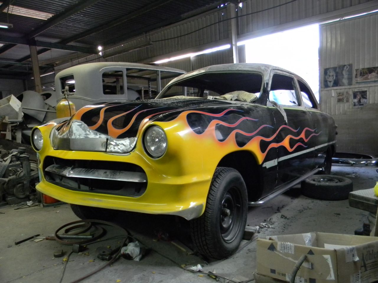

    Thanks Stephan, here are some before pictures , the black paint on the survivor was still good but the chevy grill surround had tons of bondo and the frenched headlights were done incorectly and had the frog look.
    The other reason for redoing the survivor was that 2 doors sedans are not very atractive stock, but make a perfect candidate for a chop.

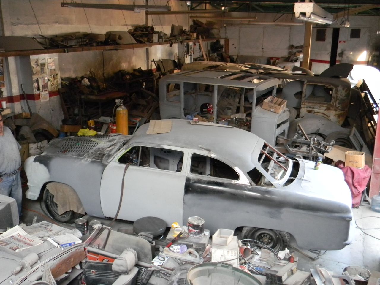

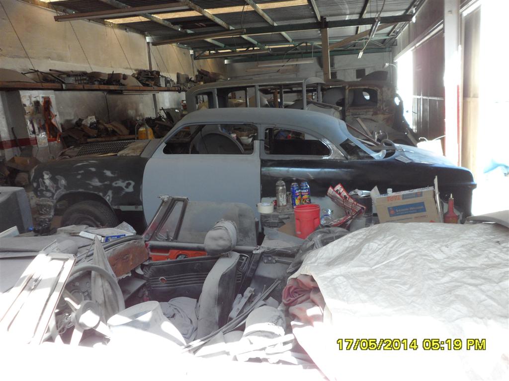

    some more, it's tough to take pics at that shop to get the full profile

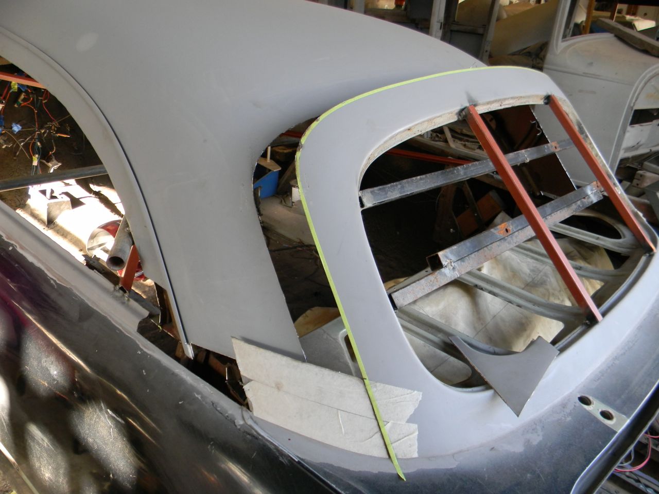

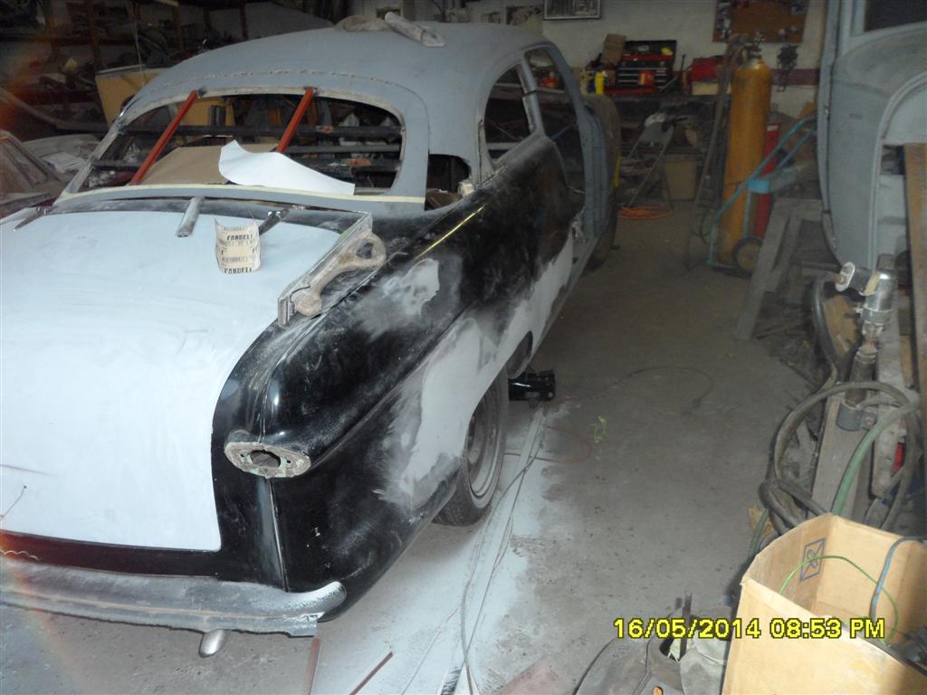

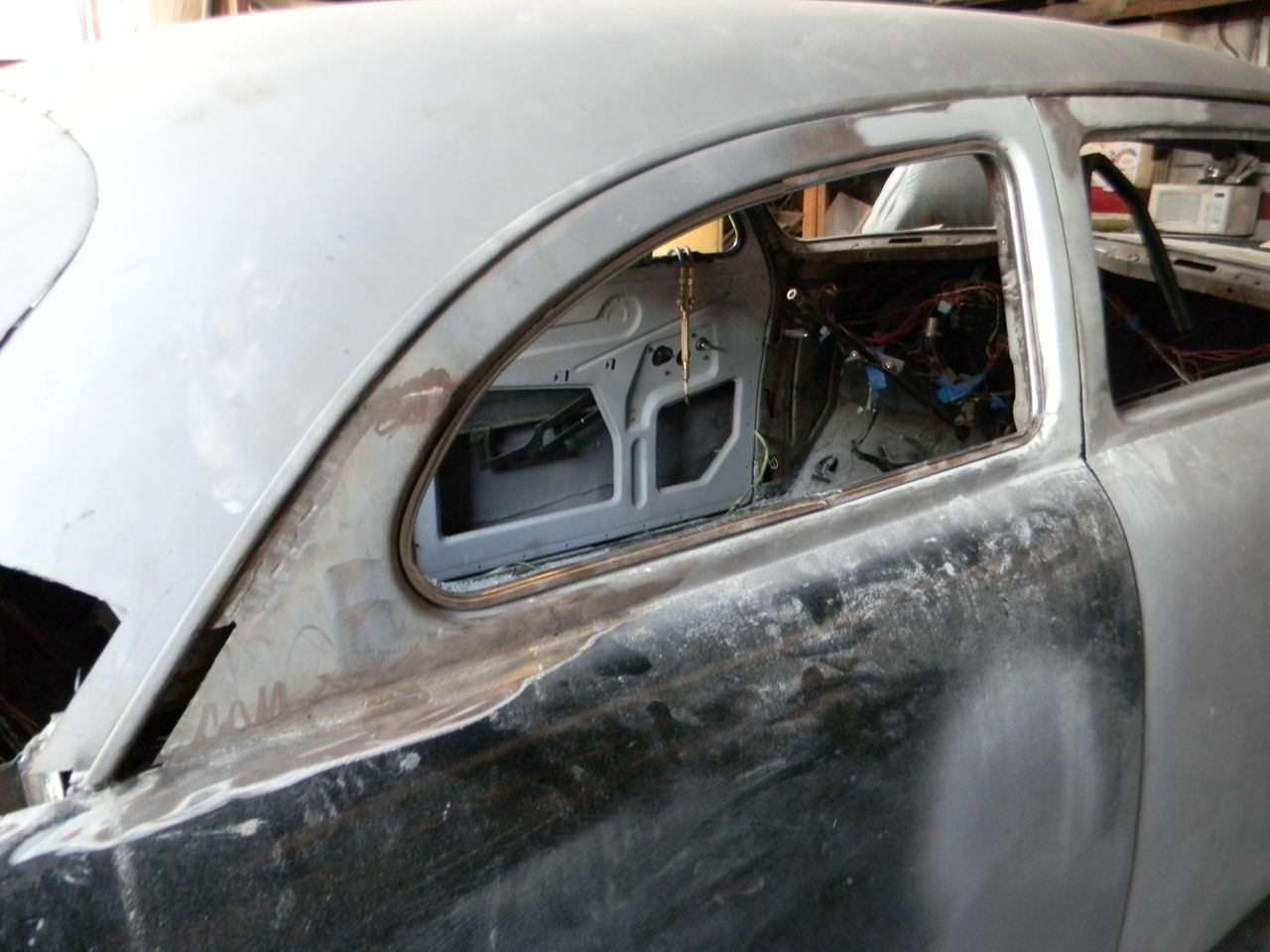

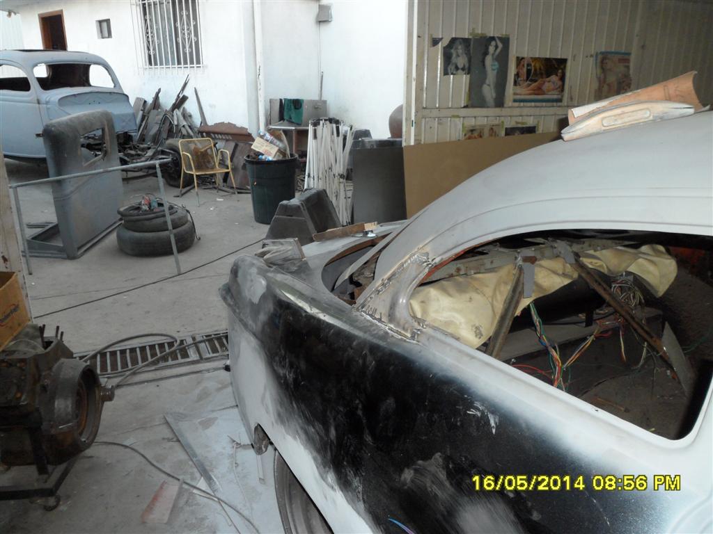

    The chop is 4 inches in front and five in the rear and is mild by today's standards but would have been correct for the 1953 to 1957 circa we are shooting for. The rear of the roof was brought foward and the rear sail panel will be lengthen , this helps retain the look of a coupe and keeps the car from looking like a aerosedan when you do the chop.

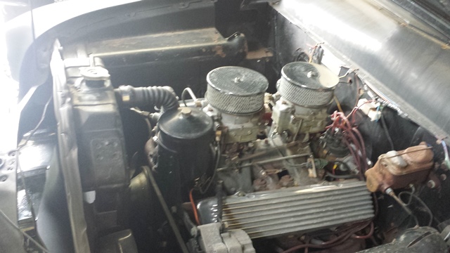

    Can I see the engine compartment? I just bought this car and trying to find out if its a Fordillac

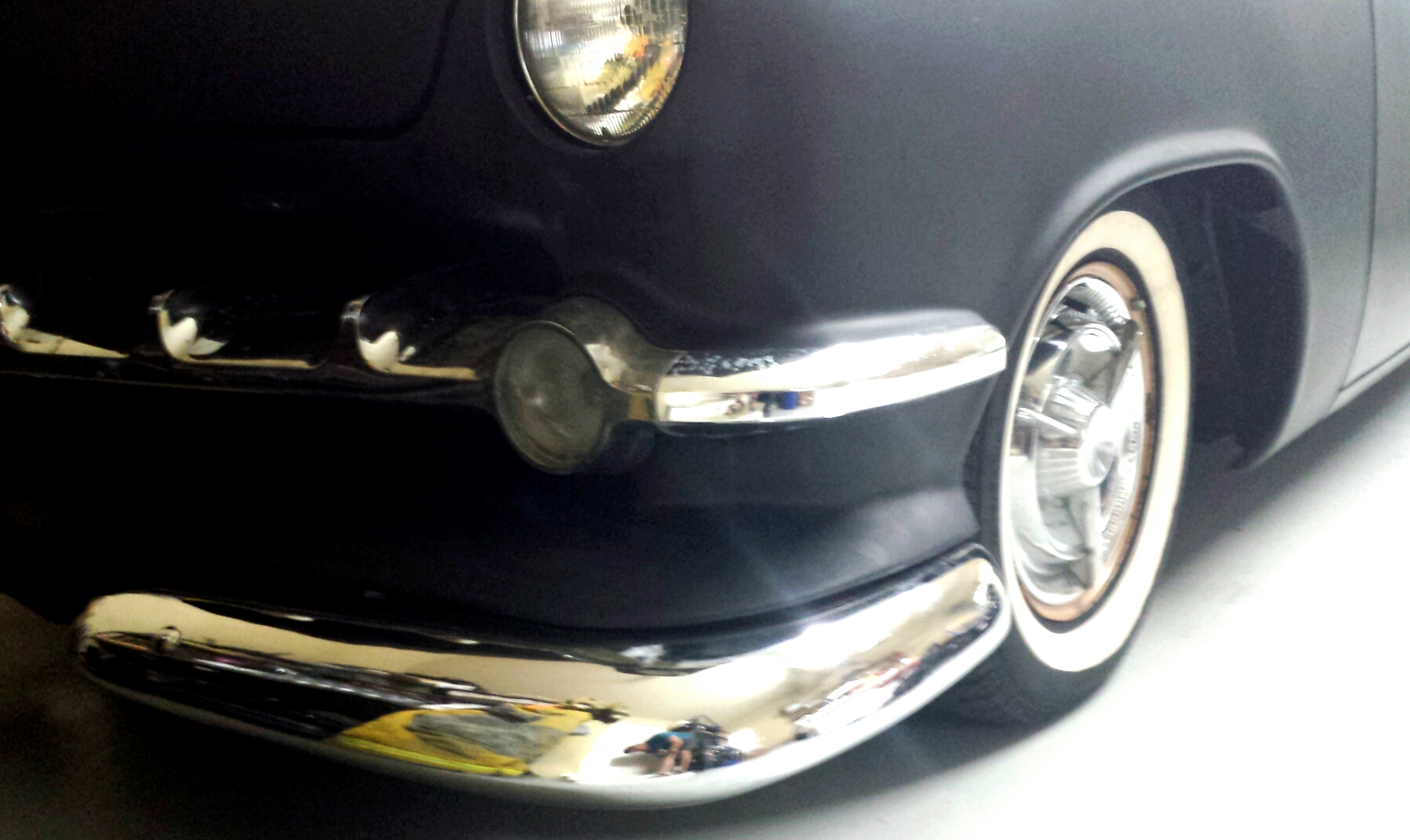

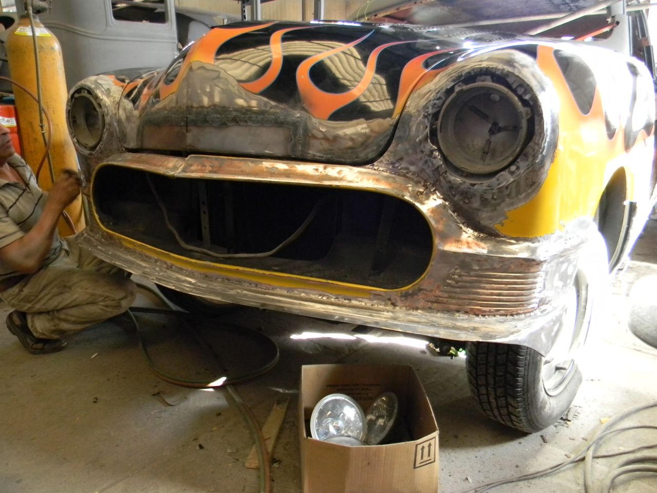

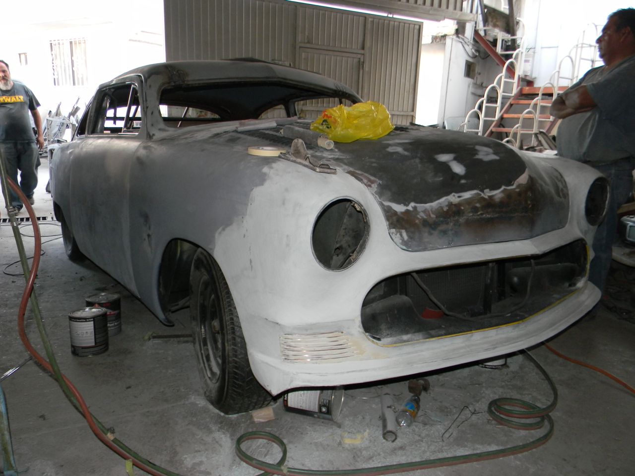

    As I mentioned earlier, the front clip was a mess, after removing all the bondo, the chevy grill surround had just been tack on. Tono moved it in a half inch inward and welded it, the 52 ford head light rings were just tack on , so we brought in the head light buckets from behind the fender and trimmed a boat three quaters of a inch of the back edgeof the rings and welded them on so they would follow the contour of the fenders. The peaks on the sides of the grill surround were redone also.

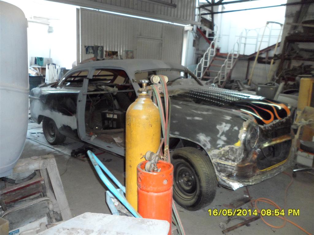

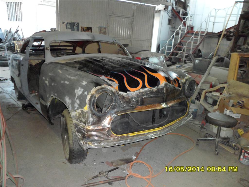

    here are some updated pictures SAM_1523 (Large).JPG SAM_1524 (Large).JPG SAM_1524 (Large).JPG SAM_1525 (Large).JPG SAM_1526 (Large).JPG SAM_1524 (Large).JPG

    Shoe boxes have big flat areas on the side, left alone , they can be a bit borering, but provide a perfect easel to add trim and individualize your car. The trim is 1953 riviera four door, lower spears are a extra set of front fender trim. We also replaced the Cal Custom clown smile grill for a more agressive 54 Chrysler grill.
