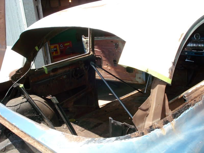

    Ok, here it is started choppin this 51 Chevy 2 dr sedan a few days ago. Nothing crazy, 4 inch chop, and canted b pillars.
    started out with this
    started marking out cut lines. We cut the package tray out for reasons to be revealed further down the page
    rear window and package tray gone
    Roof off
    set the roof back on to look at how the pillars needed to move
    cut A pillars top and bottm, and B pillars top and bottom to lean them in to line up
    saved the curve out of the quarter window to finish off the newly chopped quarter window with a nice curve
    slightly bent the curve then tacked into place
    ok, here is why we cut out the package tray. after a lot of thinking we decided to move the rear glass forward iinstead of making the roof longer we mad ethe catwalk longer
    all gas hammerwelded of course :D
    ok, roof Shortened, and rear window tacked into place
    thats it for tonight more pics and such manana.
    sam

    ok, I cant fall asleep so here is a little more.
    here is what a finished hammerweld looks like. not much to grind
    new, extended catwalk welded [​IMG]
    here is the unchopped door top showing how much it was chopped
    new profile
    welded B pillar

    welded A pillar.
    then smoothed out the welds. Gas welds require very little grinding
    shot the sail panels in, and test fitting the reshaped beltline trim.
    the belt line trim need a little straightening so I made this little dolly to fit inside the trim
    more to come....
  16. Low
    Joined: Jan 28, 2002
    Posts: 477
    Low
    the reason we decided to move the window forward is that when you just lay it down, the sail panel gets HUGE. We decided that moving it forward gives the roof a more proportional look, and keeps the sail panel around the stock size. it also gives the whole car a more aggressive coupe look without the little coupe 1/4 windows
