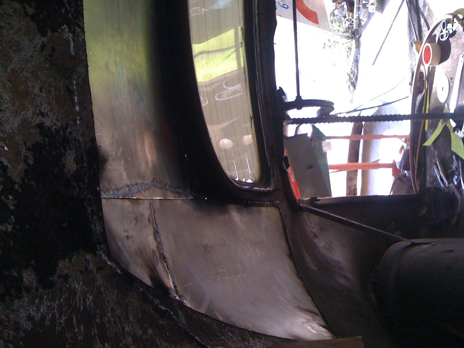

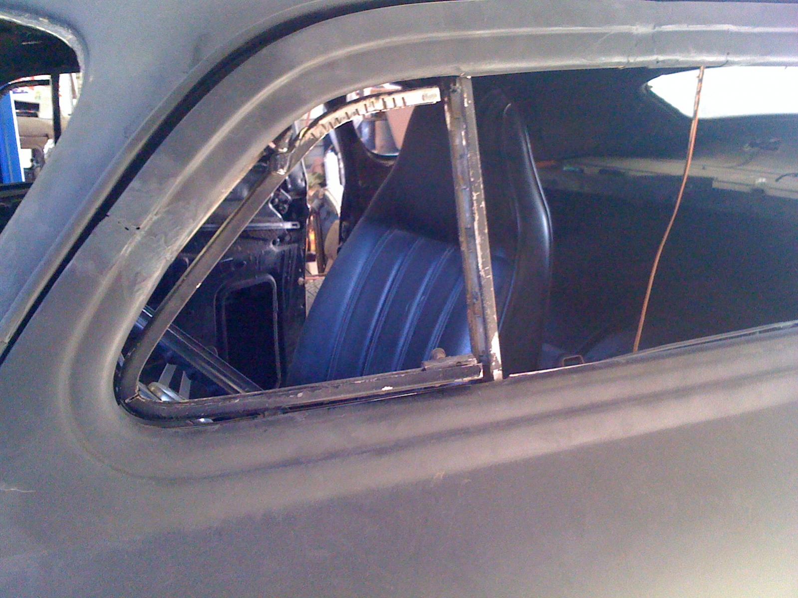

    now that the top is dropped I can start rebuilding the B pillers and the radius in the quarter window. IMG_1809.jpg

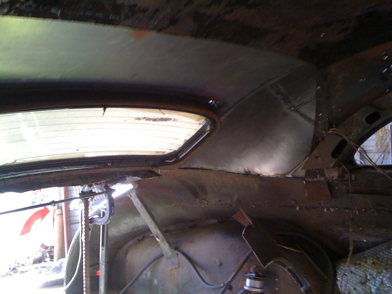

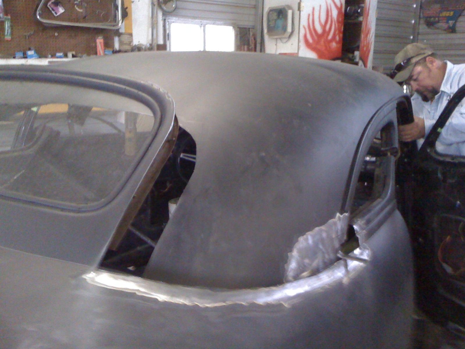

    thanks now to lay down the back glass and start filling in around it .I used 20 guage sheet metal. IMG_1824.jpg

    more cutting and fitting ,welding and grinding. Note ,I was able to do all the work without an english wheel or plinishing hammer. IMG_1836.jpg

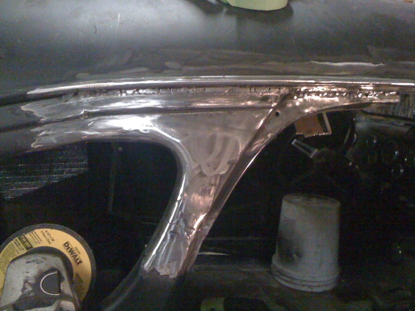

    Here are some misalanies pics. I've got the doors done now and I have to do some shrinking with a torch and some hammer and dolly work but it is pritty much ready for filler. I.ll go back to work on it in the morning and have some more pics. later. Thanks Kory. IMG_1786.jpg

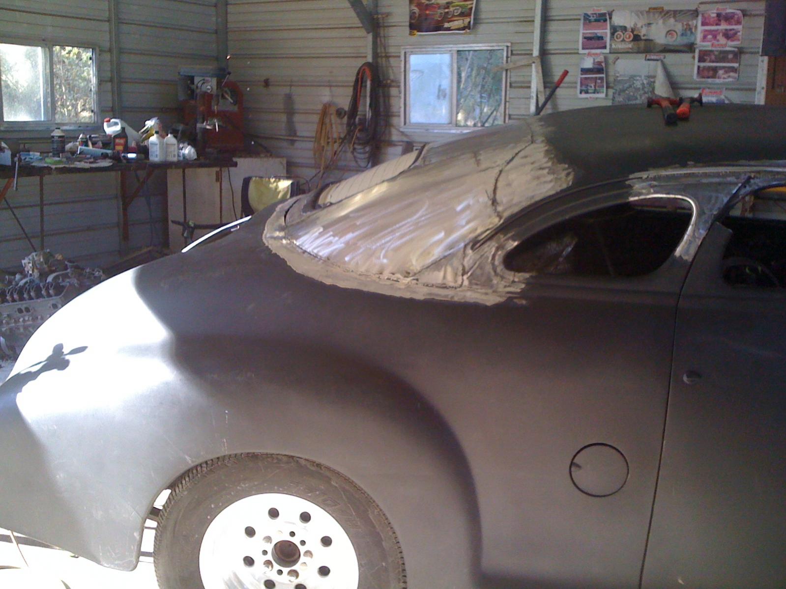

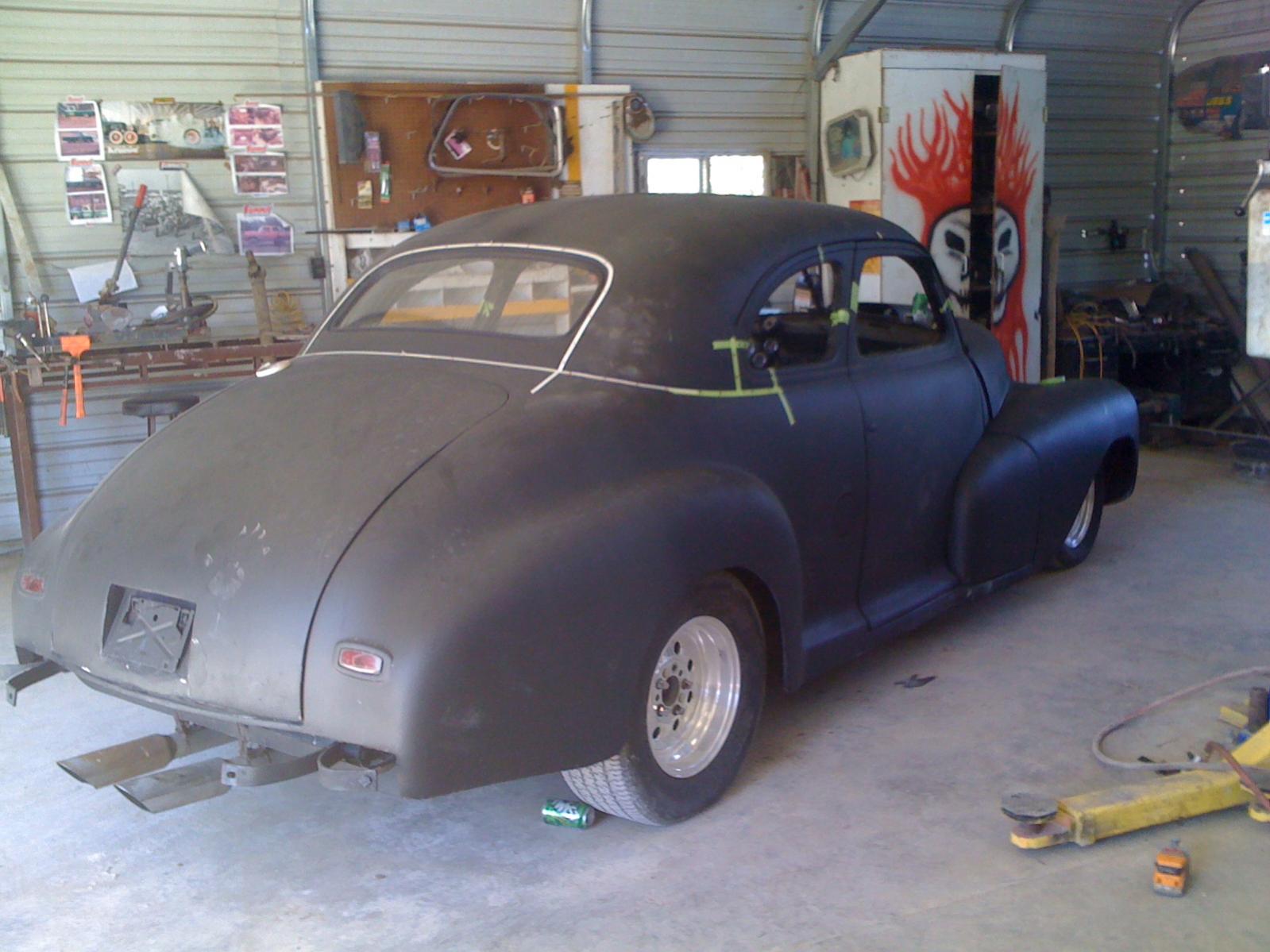

    Ok got back to work on the 46 metal work is done and started laying down some filler. IMG_1860.jpg

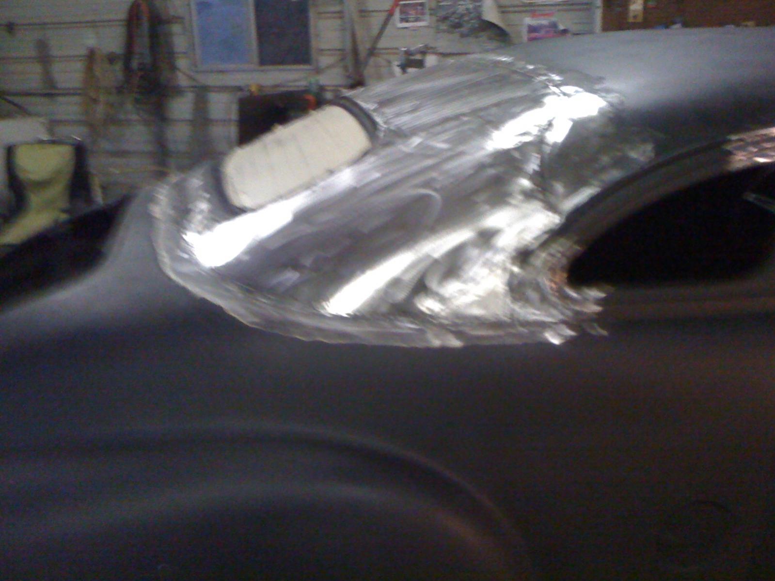

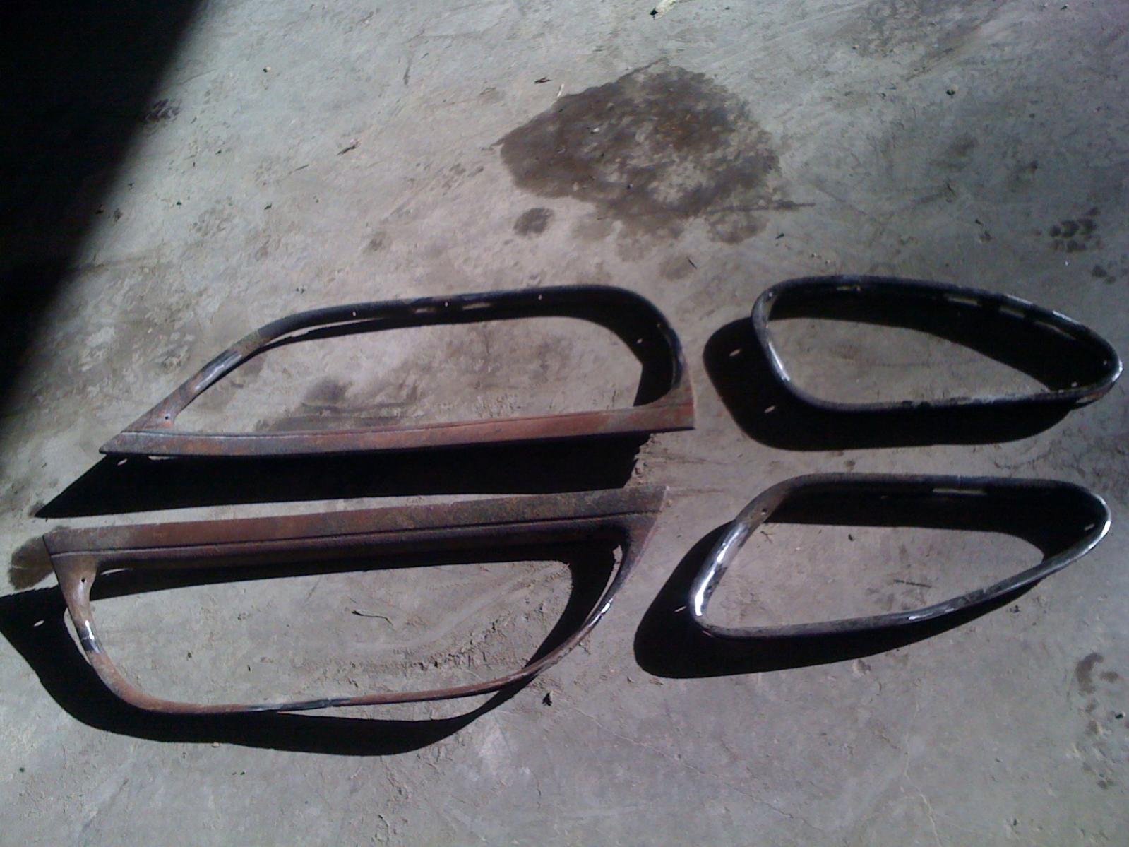

    Thanks for the kind words, got a few more here, working on the trim rings and the wing windows. Oh and got some new fender skirts in. IMG_2053.jpg

    How much did you end up taking out?
    I didn't lay my back window down, I built a filler panel between the trunk and roof.
    Your's looks good.
