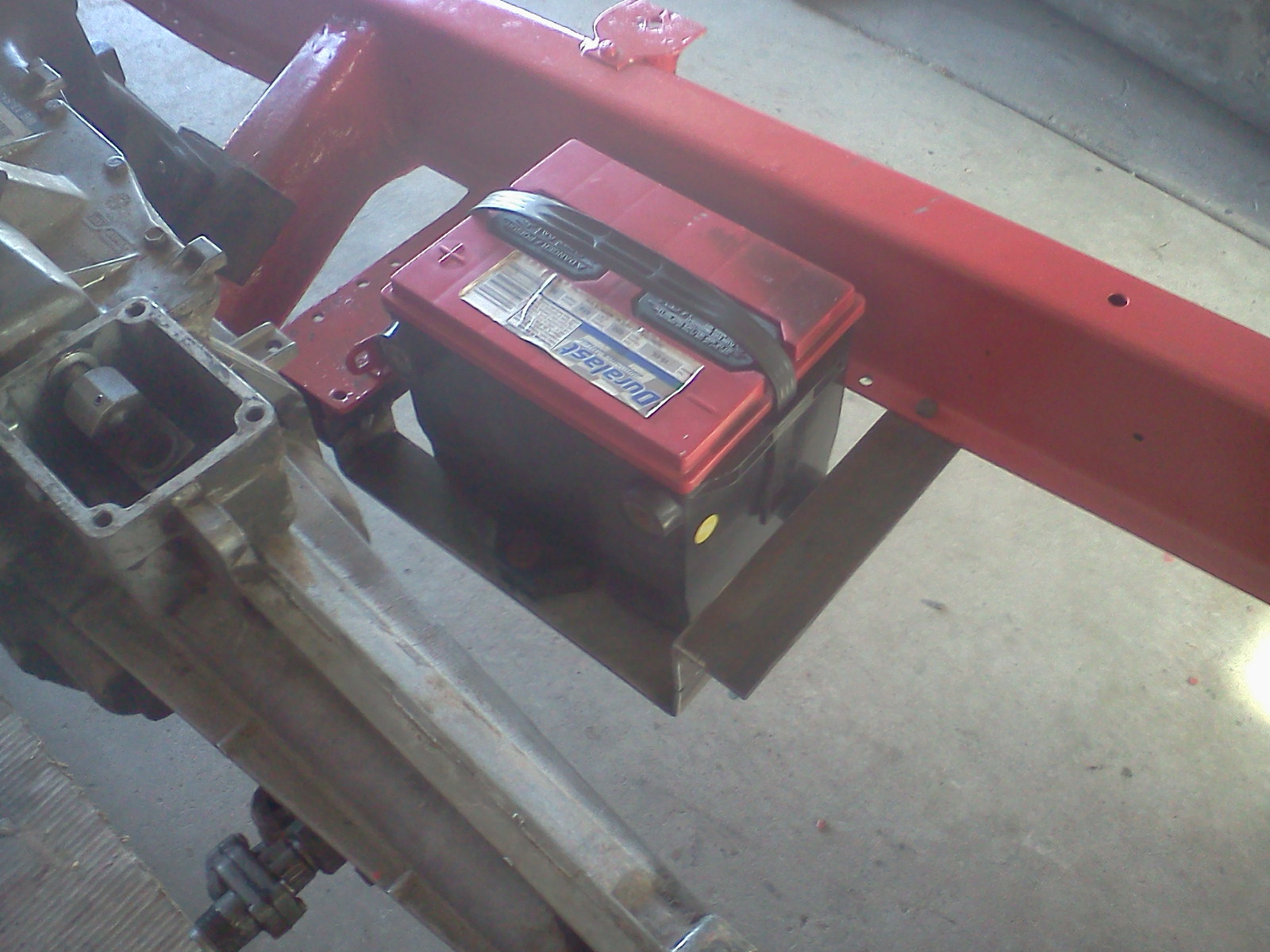

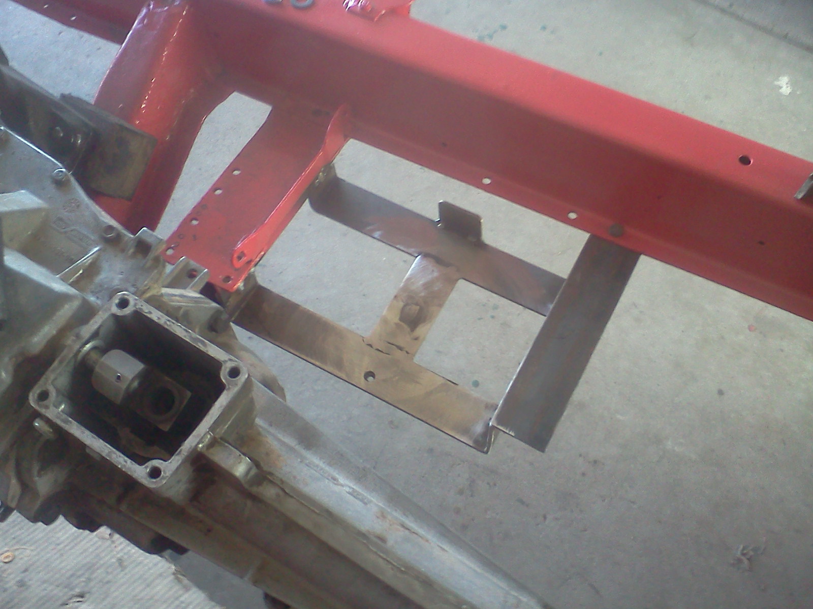

    Added a battery box in the stock location today.
