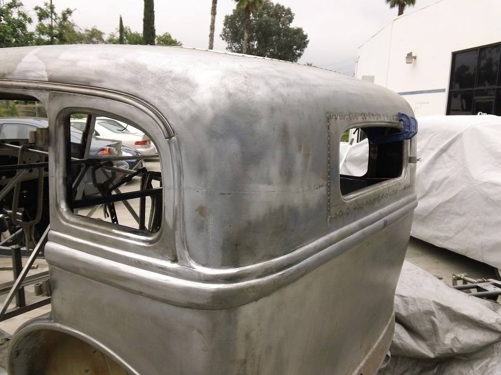

    Here we are starting our chop on a 33 Plymouth. We just took out 2 inches and are in the process of tig welding back together. This car is going black paint and original black wires. Ill keep posting pics of the build.

    We are now making our body and motor mounts . and finishing up the chop on the cab.

  6. Nice work!! Well placed cuts sure make the task of stitching it all back together much easier! It looks like there were virtually no filler panels at all, which is a testament to the guy who laid out the cut lines. I like the trick of laying out the masking tape and then spraying the blue dykem.
    I like the body shape of the '33 and '34 Plymouth sedans. They have a lot of the same shapes as the Fords of the same years.

    We will have a 3/8 strip filler panel a few inches in the front of the roof because we dont want to lean the front post.

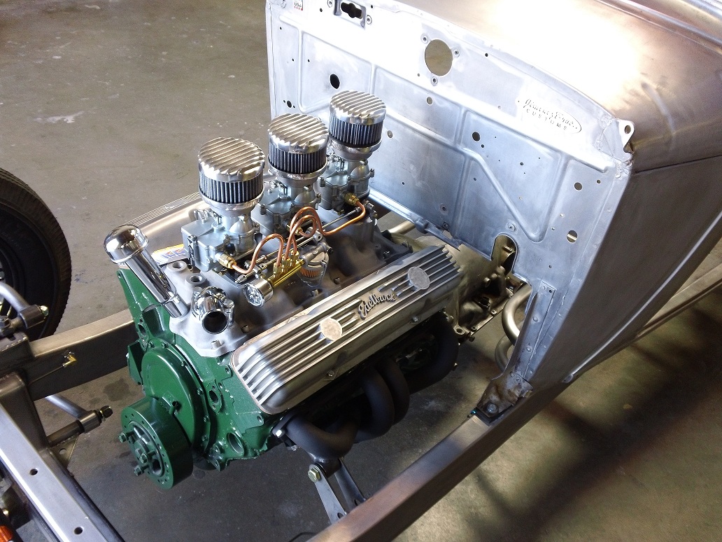

    Today we worked on body mounts and putting in the filler piece on the roof and just trying to complete the chop on it. We also started putting together the chassis . The car is gonna have a Chevy motor and run on the original wheels as you can see in the pics. Our plans are to have the motor mounts and transmission mounts done by the end of the week for some more mock up. Its coming along faster then we thought, Thanks to the crew we have now.

    Now we are gonna build a floor for it.

    Pretty ballzy cutting & welding a roof that isn't bolted to a solid & square foundation!

    We mount the body solid to the frame and weld in square tube framing before chopping it. The reason is if you chop it on something else you will have problems with your gaps and alignment. This works out best for us on every chop we do , i will post pics when finished. framing should be visible in the photos.
