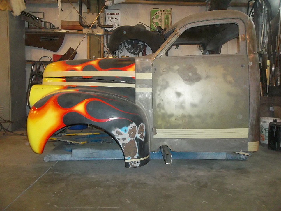

  1. I've been going back and forth on this truck for a long time. Hot rod, or custom. I'm going with custom. These are just some quick ideas in tape. 3&3/4" section. The hood and front end are the only complected areas. I've been saving a 47 olds grill and hood for a while also. I think I can make that work.

  8. Thanks for the encouragement. It's been harder than you might think to commit to this direction. I've wanted to build a custom for years. I just didn't think it would be this truck. It'll go slow for a while. I'm still putting together the "Butchered Bird" project, and deep into remodeling my 1903 house, but I'm starting to see a light at the end of the tunnel. And the new wife is very supportive!
    I picked up the tube to brace it with. Gonna try to get it ready to cut this next week.
    I've cut it on paper, and it looked good with the mild chop. (1&1/2") I could & would go more, but I think it will be just about right. I'm sure the HAMB will let me know!:D

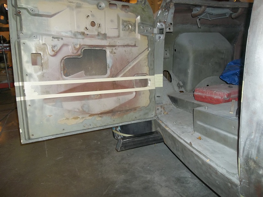

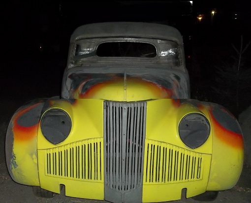

  11. They started out out of proportion! ;) Didn't work on it today. Had the day off but spent the day on the T bird. I was able to spend some more time looking and measuring. I'm going to take out the floor and fire wall. "Un channeling" I'll gain tons of head room. Here's a picture of the grille in front of the truck. Keep in mind I'm only using 3 smaller of the 4 bars and the olds hood.

    Hey Tin,
    That Studi looks like great material for a kustom to me:D I don't know how you'll drive it if it's chopped, unless you're built like a bridge troll:D
    Any way in hell you can move the sectioned area of the bottom corner at the back of the cab up, and save the " tumplehome '' in that area of the panel? If this area gets sectioned out, and the cab jus dropped, it will take on a '' bobbed '' look;) Maybe there ain't that much shape in the panel in that area, but from the photos it looks that way to me.
    To me, the best section jobs retain as much of the original shape and form of the vehicle, whyle removing excess volume.............than again, it could just be the fumes talkin' ?

  13. I'm not pickin up what your putin down pimp:confused: The cab is lookin really simple. I think I can drill out the welds and let the cab back slide down.
    Then reproduce the bottom flange ( I want it to look stock) Here's a really crappy photoshop:D More head room than you might think. I only chopped it to lean the post some more. And what the hell is a "trumplehome":D

  19. fleet Yep I drill out spot welds whenever I can instead of cutting thru panels. Same as your doing but I'll trim off the bottom and make a new pinch weld. I'll be taking out all the cowl between the tape lines, and putting it back after the inner structure is done.

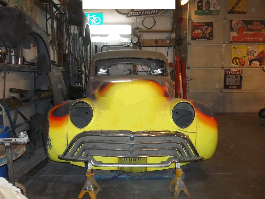

  22. Another crappy photoshop:rolleyes: With a face like this, there's really nothing to lose !:eek:

    Maybe the use of a '55 Pontiac facebar , foreshortned , and fit beneith the grille ends, or a pair of '55 Dodge grille centers under the ends of the grille? A '50 Studebaker front facebar, with guards, could maybe be cut down and used?

  24. I have the olds bumper.( I have the front two feet of the car.) I haven't held it up to the truck, but it looks huge. Swap meet season is just around the corner. Maybe Ill find some big titty looking things! :DI think they call them dagmars?

  28. Your 2 cents is worth a great deal to me choprods. Here's the front sectioned with the stock grill. What do you think about that?
    The dagmars was a joke by the way :p I'm thinking something lighter for the bumper
    The chop is actually straight down with the post leaned. The rake is stock. I'll most likely take more out of the front of the hood/aprons, but I suck at photoshop
