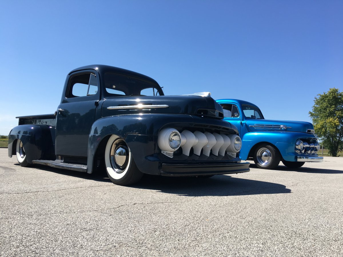

  1. Hey guys,

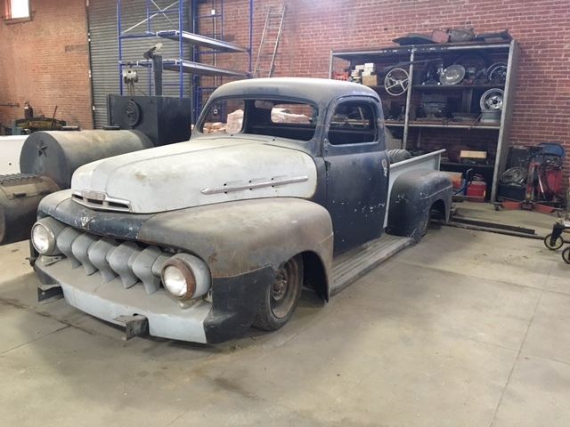

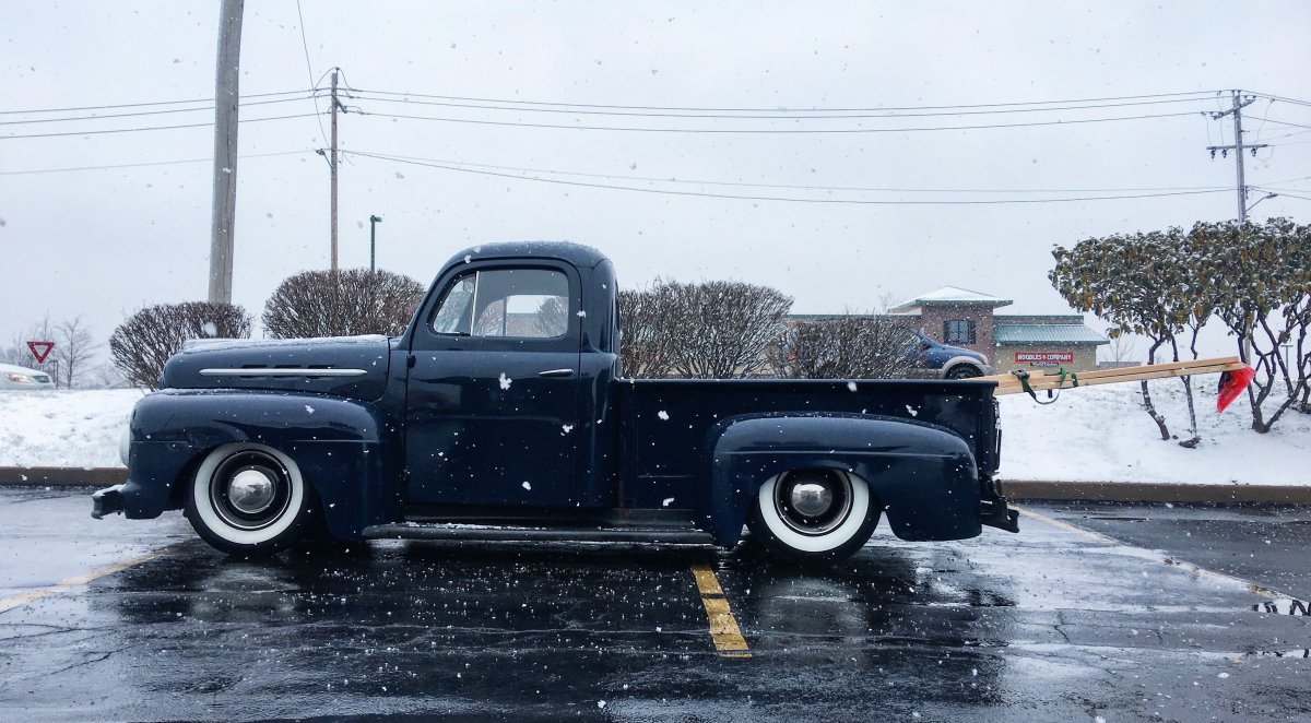

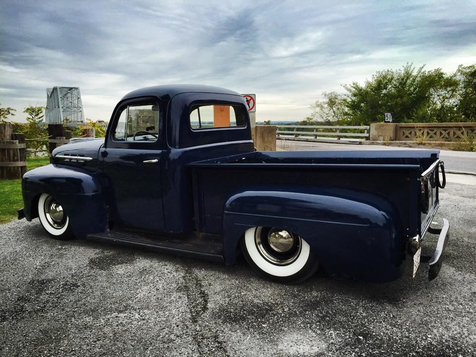

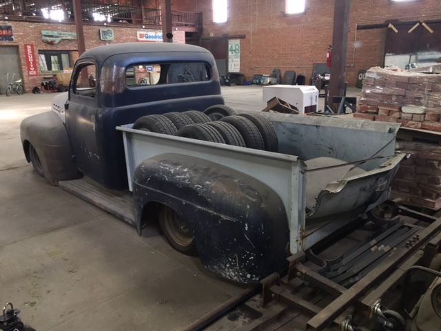

    Wanting to find the owner or at least fabricator on this F1. I’m assuming it’s a 2” chop due to the fact the roof wasn’t cut into multiple pieces and reworked. Any cons to that? I want to chop at least 3” on mine and I’m not sure what kind of work I’m gonna get myself into... thoughts???

  2. Looks kinda like the posts are slightly leaned back. Also looks like more than 2" to me.
    Mine was 3"and it took me forever (I'm a self-taught hack) to get it this far (avatar).

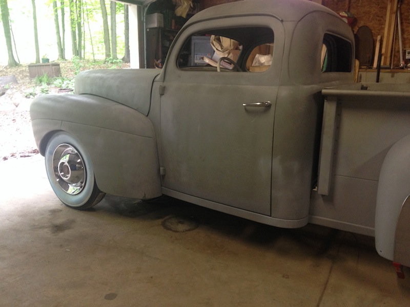

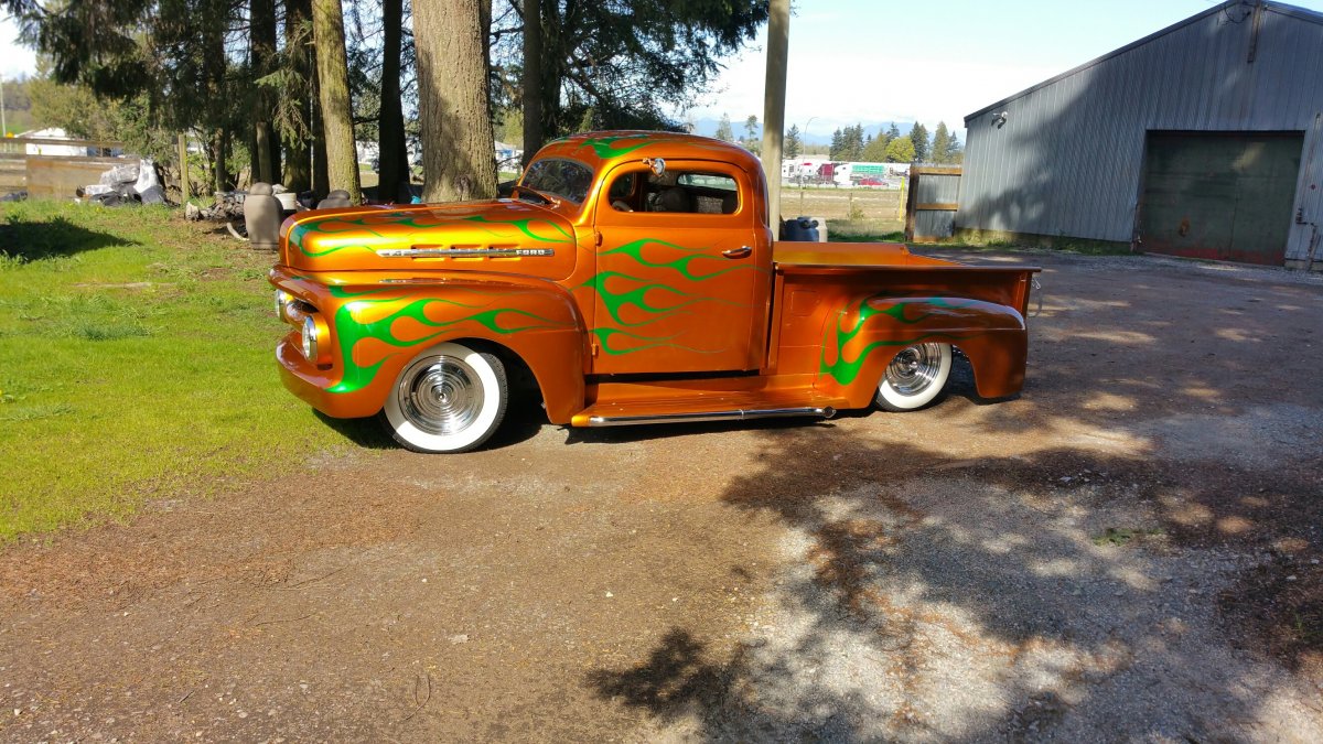

    IMG_3137.JPG IMG_3098.JPG Mine is chopped 3 inch and I found that's the most you can go without cutting up the roof into bits,as you mentioned, even at 3 inch I had to put relief cuts in the windscreen corners top and bottom.its a easy chop, I like your truck and mine is in my shop now getting redone with a section, channel and some lowering like yours

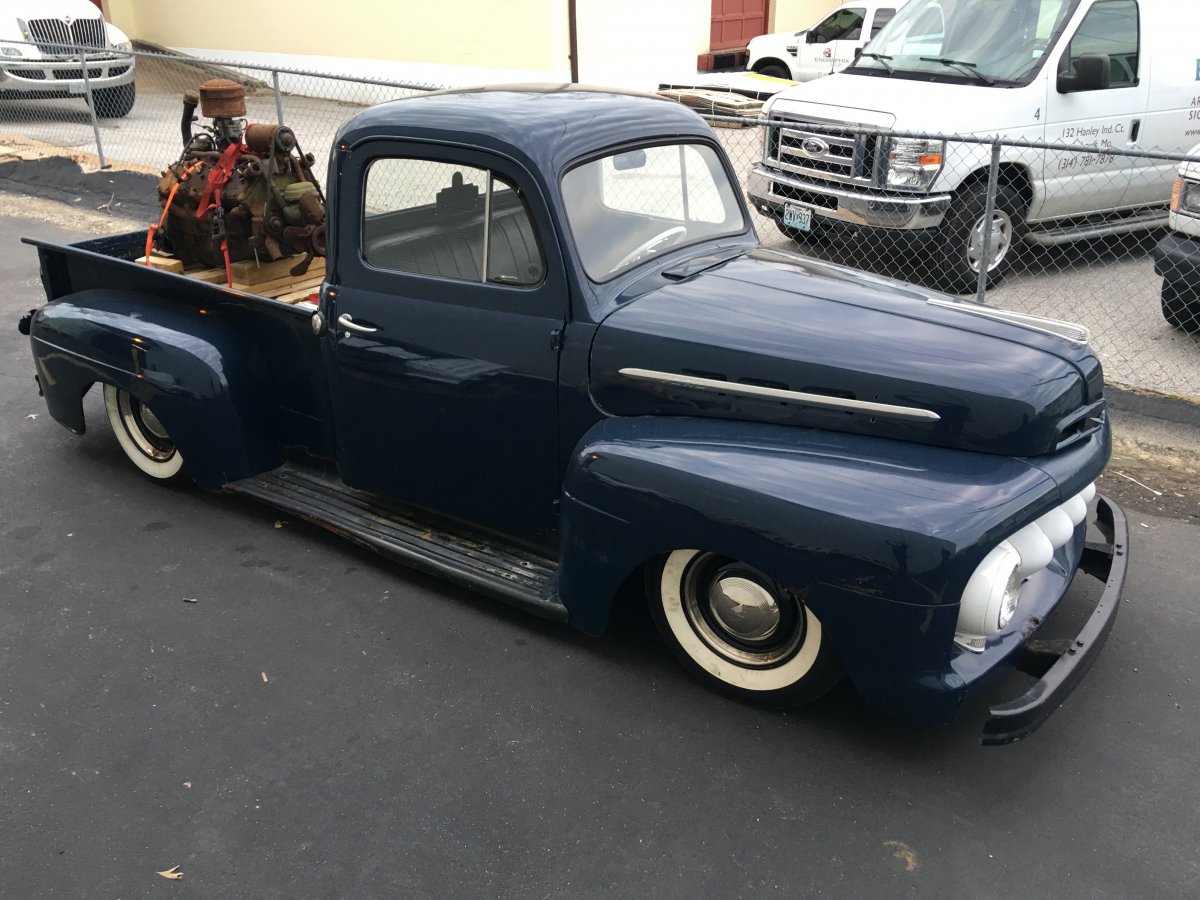

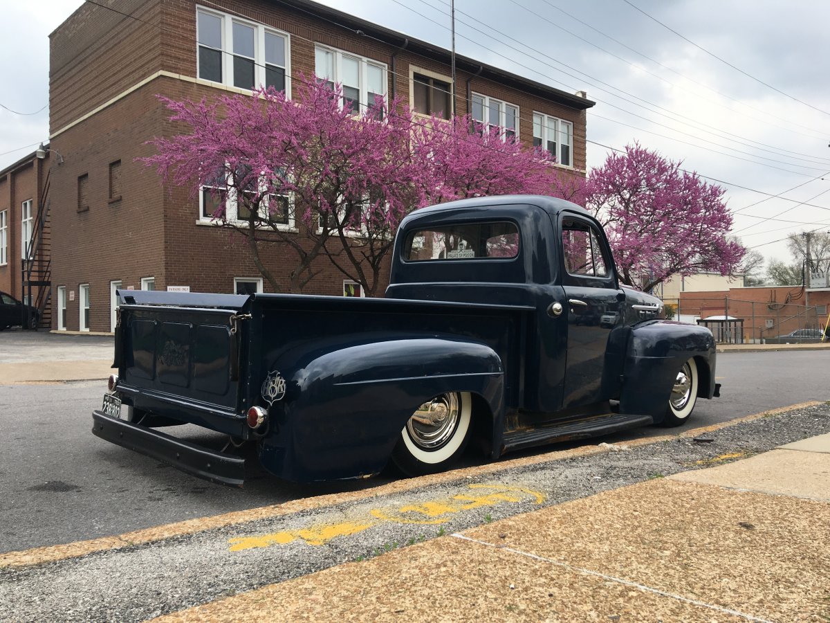

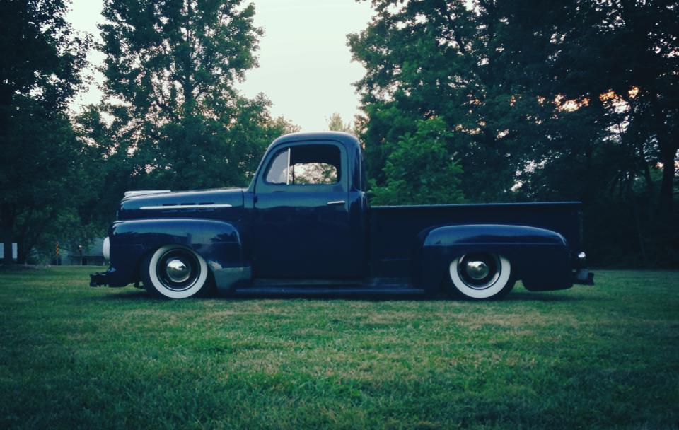

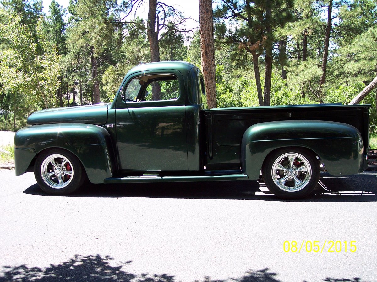

  5. 21B7AD19-8A8A-43FF-90A0-0268FB8EF891.jpeg 62ED1906-92AB-4C89-92E7-BDA930534780.jpeg FD6C7C2C-1B8D-4BC9-BE88-1564C3D4AB2F.jpeg 86F8DD78-5FDA-4C3C-8231-09CD5E568476.jpeg 765E321D-A30E-49BE-A668-958BA2072E88.jpeg 15895196-01EC-4415-B373-2783B5ED37D4.jpeg Here’s some of mine past and present.
    I’d like to do 3” in addition remove some crown from the top. We shall see.

    4" chop on my F series cab. About a 2" wide filler piece. No need to quarter the roof.
    The one you posted looks to have had the A pillars leaned back...

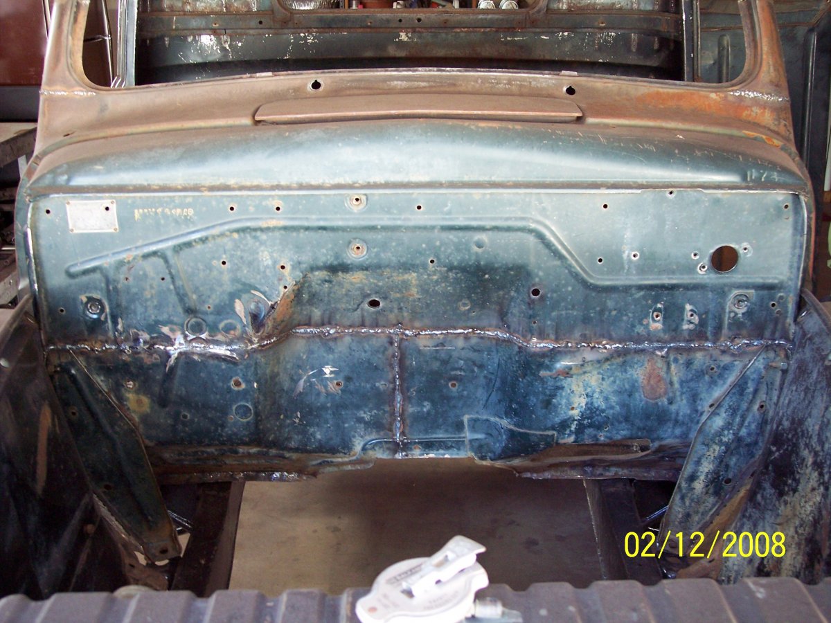

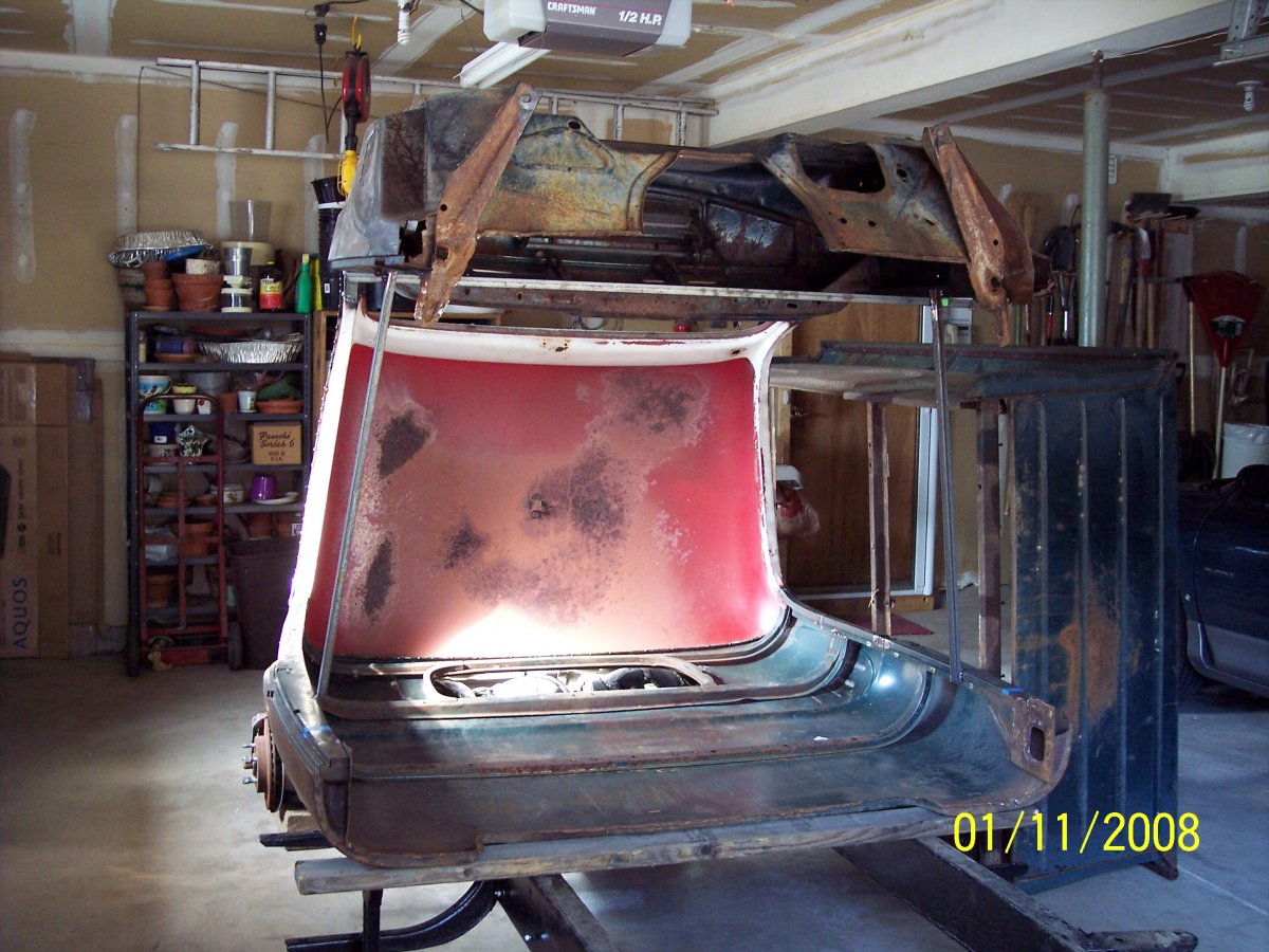

    Mine is a 2" chop with a 3" channel. I did not have to cut the top.

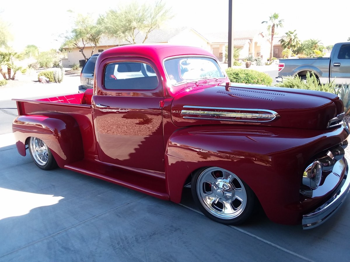

    I know I will be crucified for the wheels but I just wanted to show you what a 2 3/4" chop looked like on a '51.

    I sectioned (pancaked) the hood, chopped top is 2" and channeled the cab 3 ". Pic attached.
