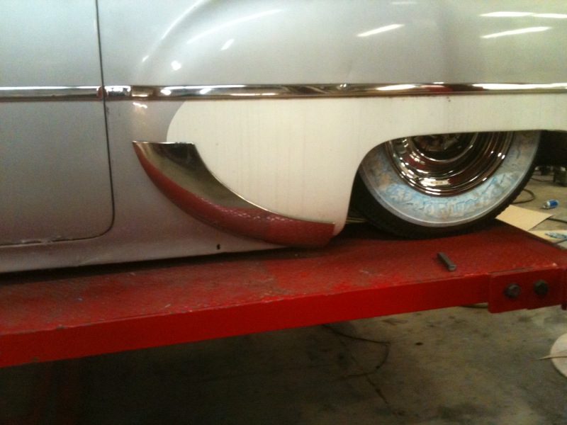

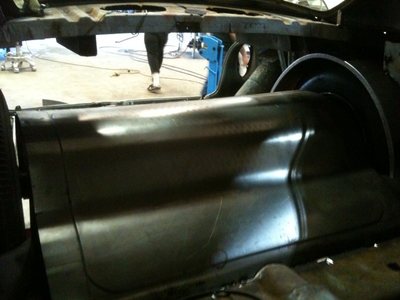

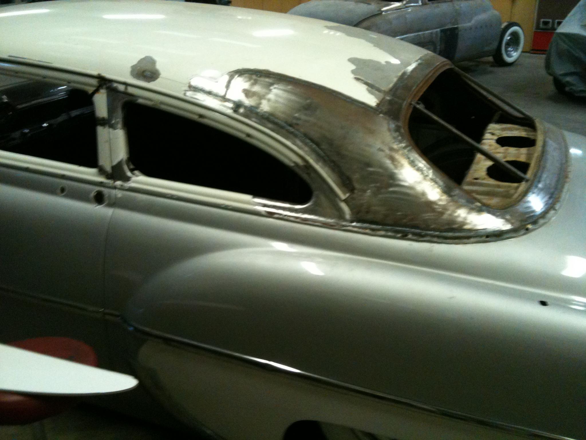

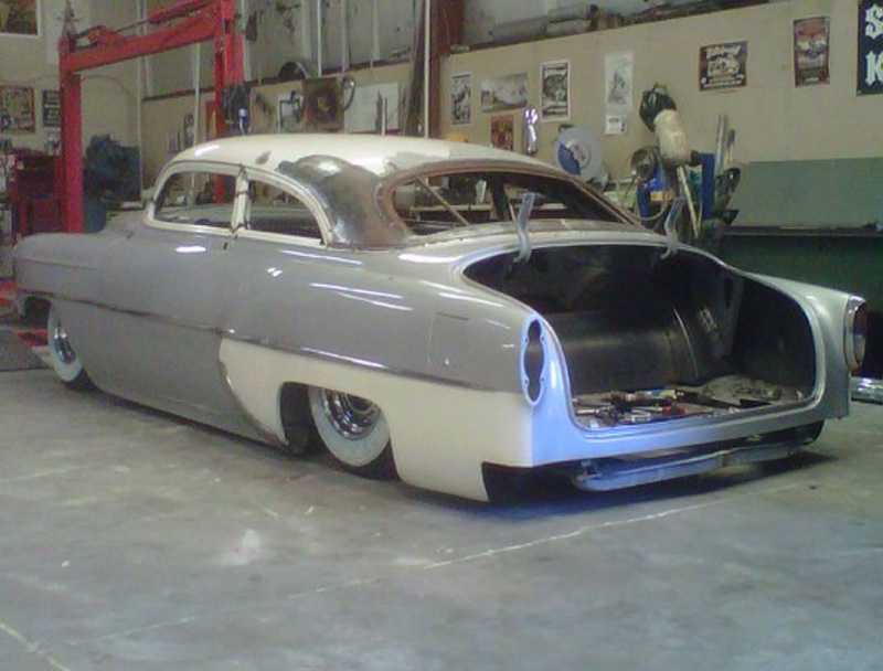

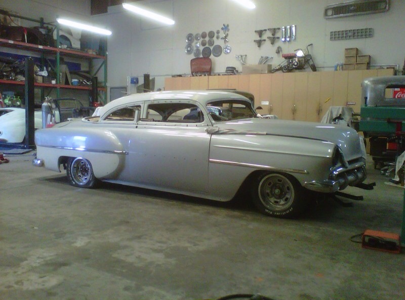

    Wanted to show some pics of my 54 Chevy as it's gone through a lot of changes in last couple of months. Please take a look and let me know what you think. Big thanks to Jesse and the guys at Sacramento Kustoms for their hard work and ideas.

    Lookin great!!Ford back glass?

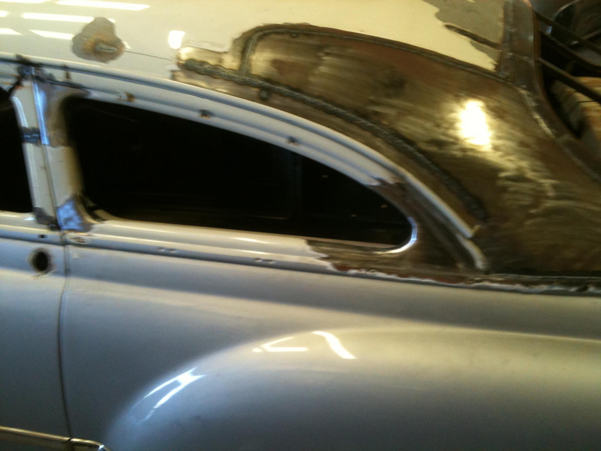

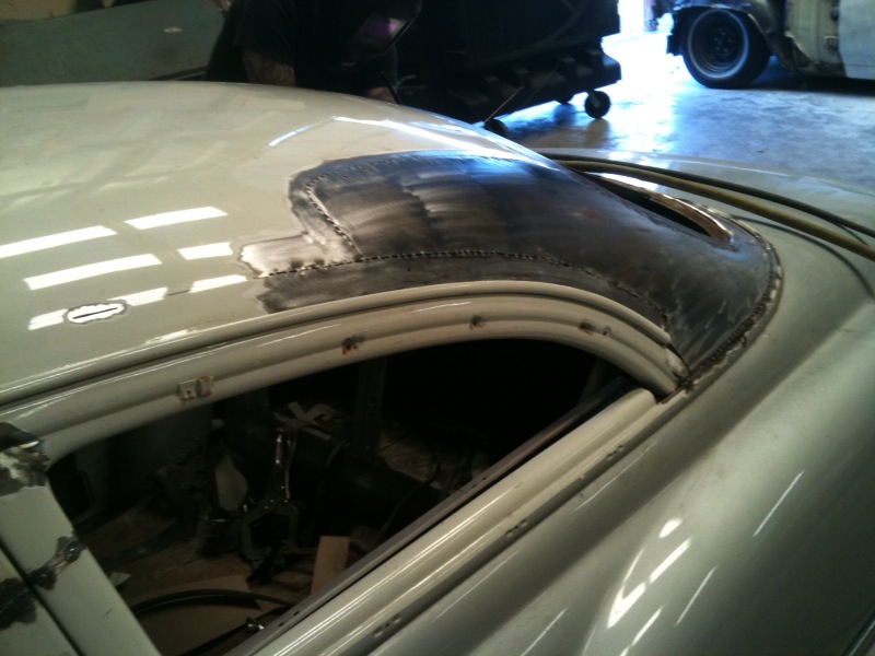

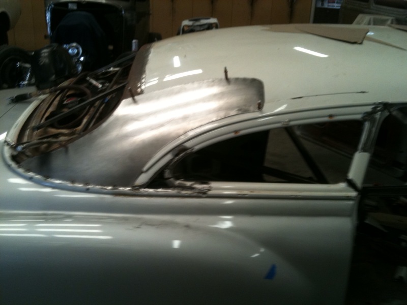

    Killer chop man! Got any in progress pics of how the b pillars and the back glass were done?

    Nice chop! Did you keep the belt line?

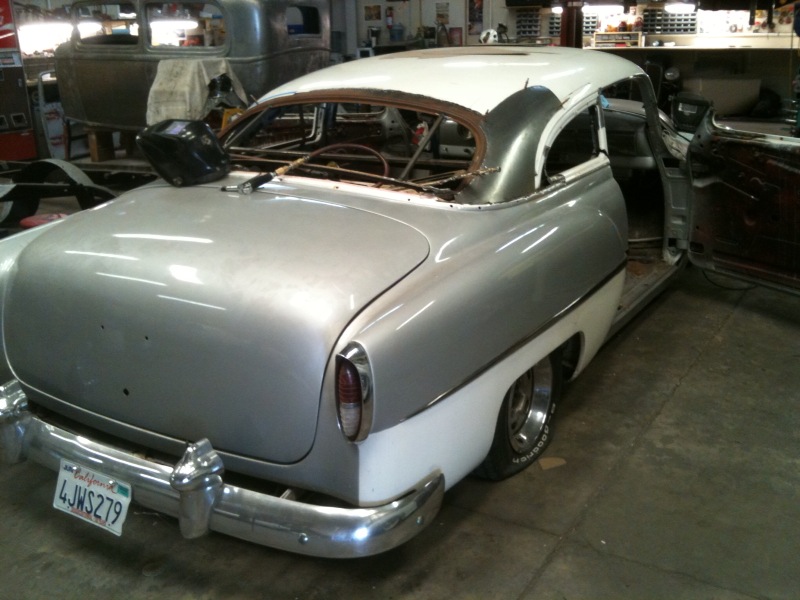

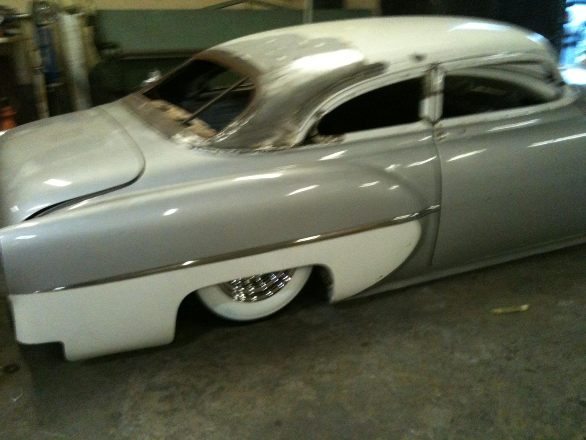

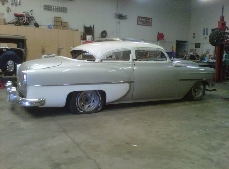

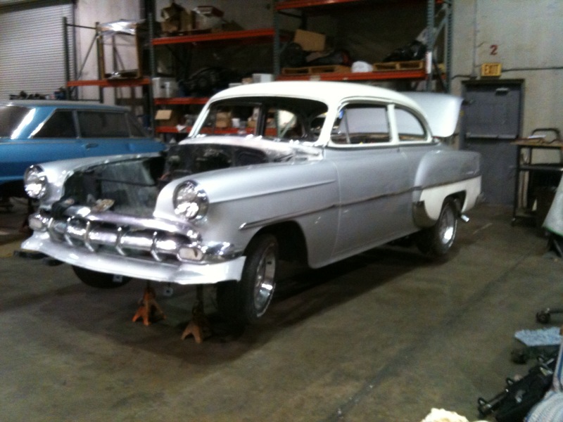

    Kept the beltline as were looking at 2 tone paint, rear window is out of a 50's chevy coupe, the bars in the picture are only for support during the chop.
    It has TCI front end on Slam bags, triangled 4 link in the rear on slam bags, AccuAir E-level Air Managment system & some Bitchen Tin work from Jesse @ Sac Kustoms. Here are some more pics of the chop.

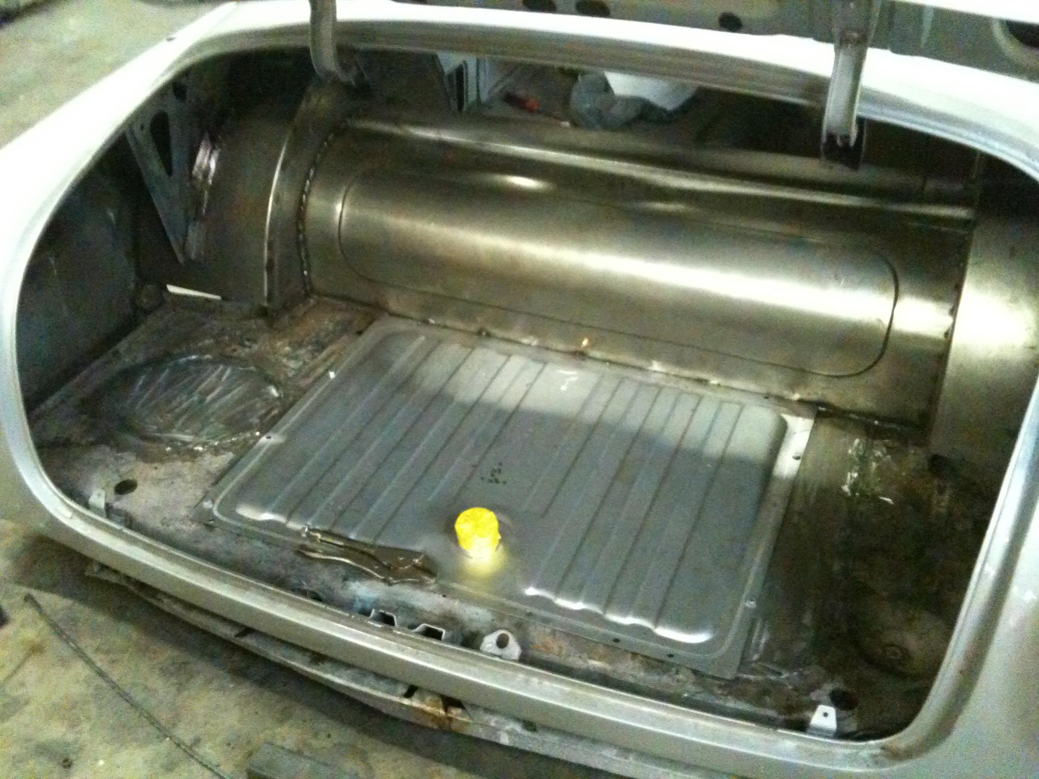

    Here are a couple more pics. Fire wall has just been finished, will have pics up tomorrow.

    I really like that chops so they took the glass and the c pillars and grafted them in? Where did you put the air tank and compressors?
